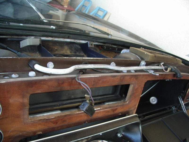

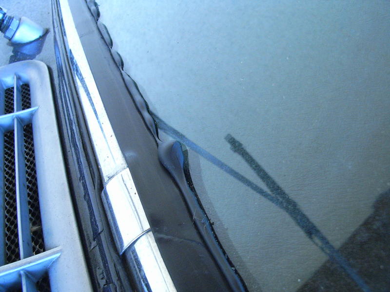

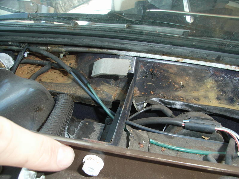

Common: Through the front/rear screen rubber profile....between metal and rubber and also between glass and rubber...
Control: Take off the top of the dashboard and inspect the lower window area from inside the car....
metal/rubber with black Sika
glass/rubber with window sealer like Teroson or Würth
http://www.loctite.com.au/aue/conten...n_Brochure.pdf
When dry inside, protect against rust with Fluid Film or another stuff

Have you got any corrosion at bottom corners of windscreen ? This can get so bad it holes through and allows water to enter the car. Only cure is windscreen out, repair with new metal., repaint and glue screen back in.
As suggested, take off the dash top (takes about 5 -10 minutes) and look for water ingression.

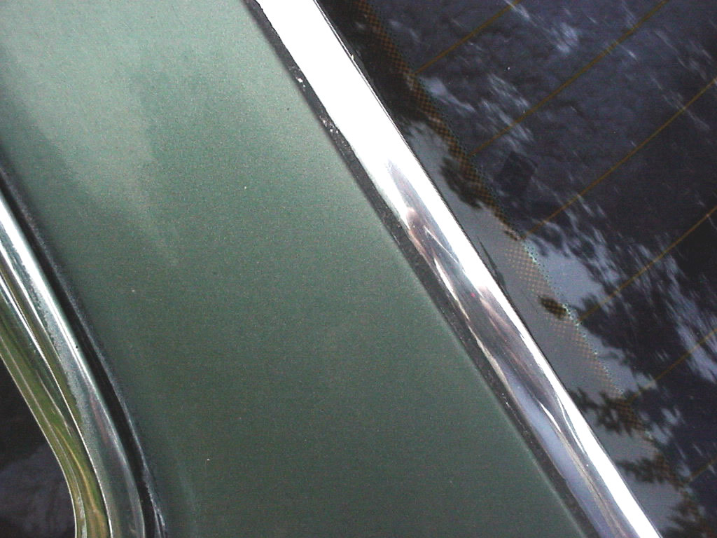

When I did my complete bare metal respray, I had to repair all 4 lower corners - rust and small perforations. Before re installing the windscreens I wanted to know why this happened in the first place.
My theory:
The inner / outer finishers are the culprit. These "finishers" allow water to come to rest under them - they are not seals, they are cosmetic plastic space fillers.
When Jaguar made the cars,.. the economical way of installing the glass into the cars and have those nice stainless steel trim pieces, required a way to bridge the gap from the stainless to the body and from the stainless to the glass. Solution was to use cheesy plastic "gap fillers". A dab of sealant to secure the glass (nowhere near enough)and then push in the stainless and snap in the finishers - quick 'n' dirty, but it looked nice.. Problem is water comes to rest under the finishers and eventually rots the metal in the windscreen channel. My solution
was to forget the finishers.
I instead filled the windscreen channel to the brim with sealant, fitted the glass (centered it) sunk in the (now cleaned up) stainless, and wiped off the excess sealant with mineral spirits, before the sealant set up.. I ended up with a 1/8 inch wide band of sealant showing around the glass. Looks factory stock that you would never notice... BUT the car has been dry inside for over 5 years.
The photo shows the rear vertical section of the car - driver's side.
I got lucky at the local Pull a Part and found a set of perfect Wilton Wool front carpets from a low mileage VDP car. Also had to change the 2 rear door cards as they were distorted from being wet.
If you have this problem with the rear glass, check for water under the rear seat - that is where it collects. As well this same leak allows water to drain down inside the rear wings and eventually rust through.
I have 2 sets of finishers still in their bags , free to anyone who wants them - just pay postage.

Thanks for the pics, Brett and Alyn. I assume Brett's method is suitable if you don't want to risk pulling the windscreen and having a big, expensive job on your hands? Instead of trying to seal from the inside after water has penetrated past the windscreen/metal border, would it not be feasible to try sealing from the outside by applying wheatherseal along the outside edge of the rubber seal (parhaps prying it out a bit without removing the screen)?
The "proper", albiet expensive way would be along the lines of what Alyn did.
BTW, where are the fasteners for the dash on a S3? Thanks
