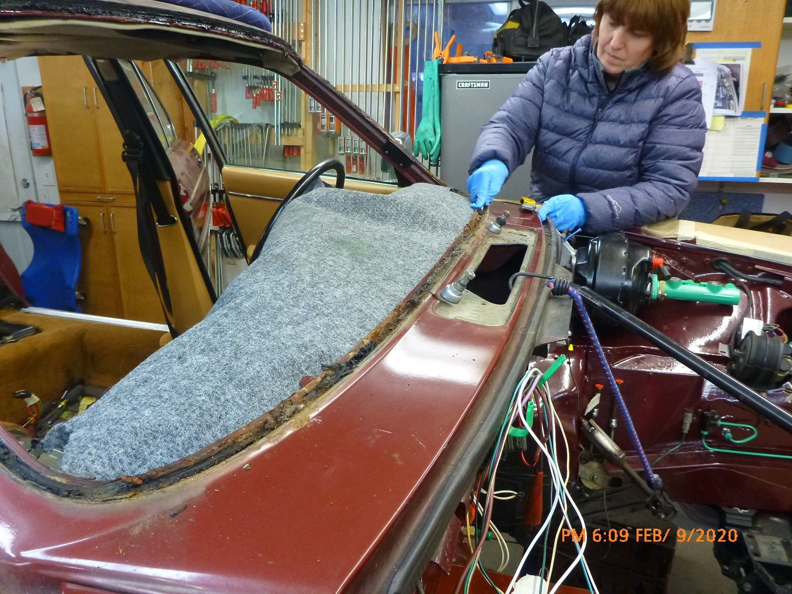

My wife and I cut the mastic with a piece of stainless steel wire I have the the shop, she on the inside and me on the outside. We were able to slice through by both of us pulling together. A little tough pulling, but definitely possible for a somewhat savvy DIY'er.
Windscreen is out, but you can see some of the traditional rust that may need fixing.
Dave

The bottom corners left and right are where the rusting gets so bad, new metal is needed.
