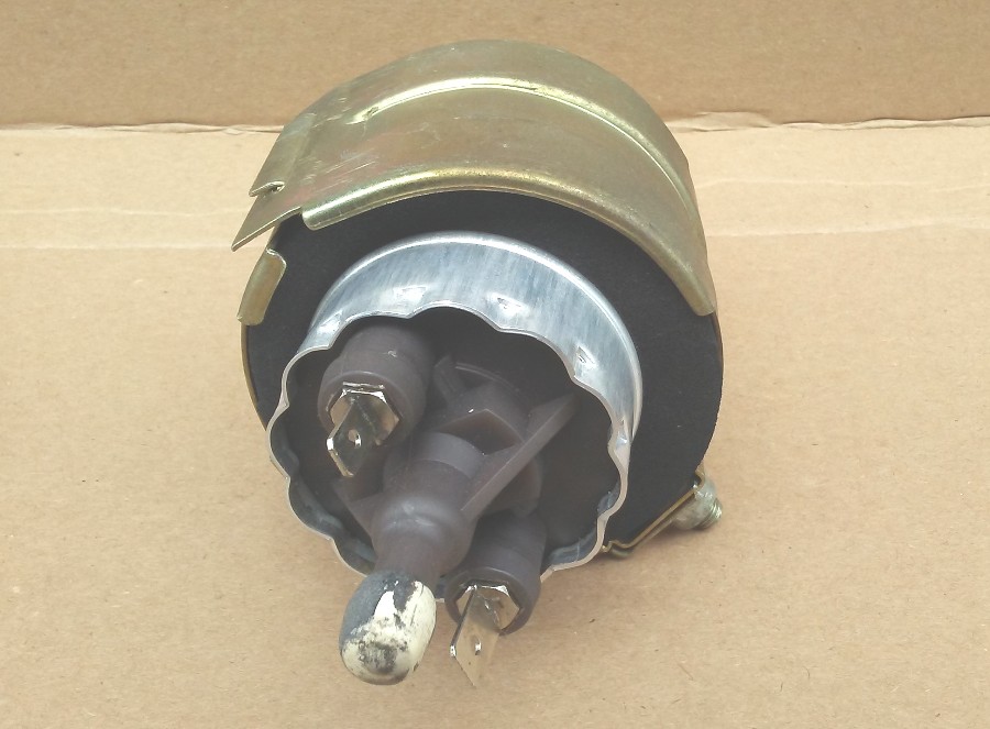

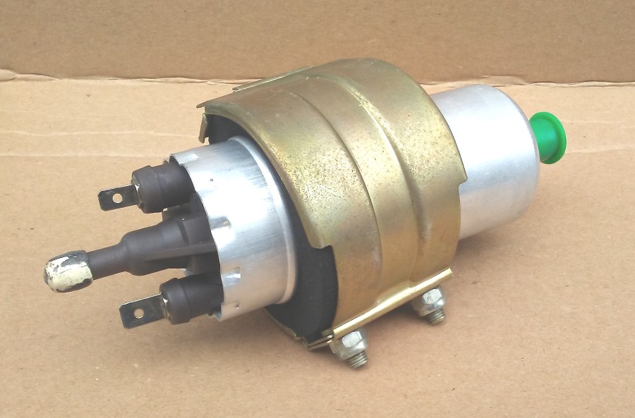

here's the fuel pump with bracket. The drawing above appears to me to be for a V12 engine, not the 4.2 engine.
Attached Thumbnails Left gasoline TANK - Jaguar XJ6 4.2 3 Series 1980-01-fuel-pump-bracket.jpg   Left gasoline TANK - Jaguar XJ6 4.2 3 Series 1980-03-fuel-pump-bracket.jpg   Left gasoline TANK - Jaguar XJ6 4.2 3 Series 1980-02-fuel-pump-foam.jpg
