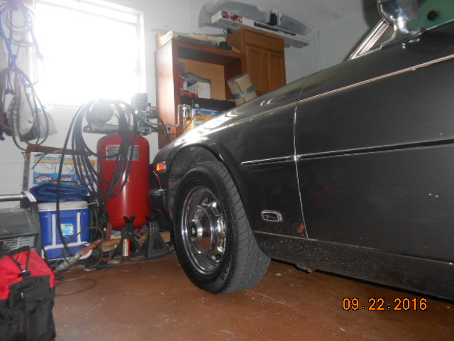

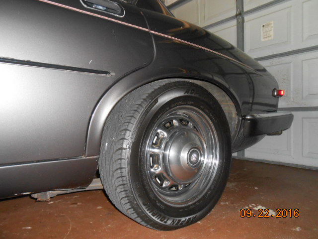

I am using 215/60/15 H rated tires. These tires do lower the car a bit, but I like how they look. These were the tires I got on sale at Tire Kingdom about 10 months ago. I had bought them to roll the car around while I was doing the V8 conversion. Since they were H rated tires,I decided to use them.
Attached Thumbnails Looking for performance 15" tires-002.jpg   Looking for performance 15" tires-003.jpg
