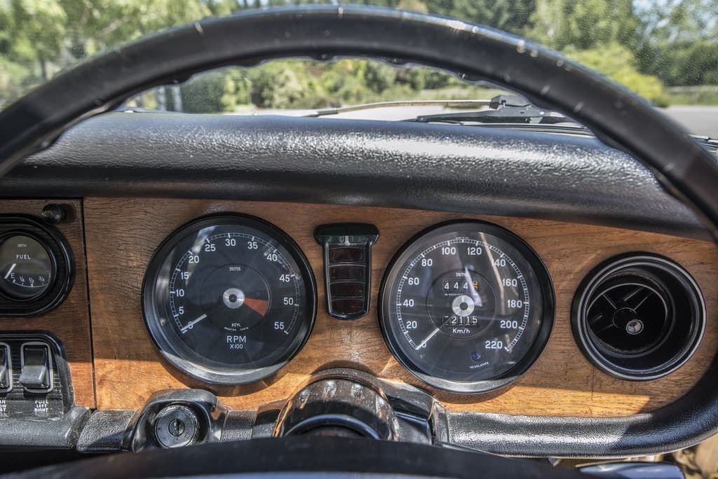

Originally Posted by The Mekon
Don't do it. I know one member here who bought a series 1 Daimler with a converted speedo - that is the dial remains to same, so that when it is showing 60mph that really means 60kph.
No, the dial is different but the needle sweep stays the same. Originally if it was a 140 mph speedometer it would be a 220 km/h maximum reading in metric. Similarly, E Types were 150mph/260 km/h. It wasn't 150 mph and 150 km/h. The odometer gearing will need to be changed as well.

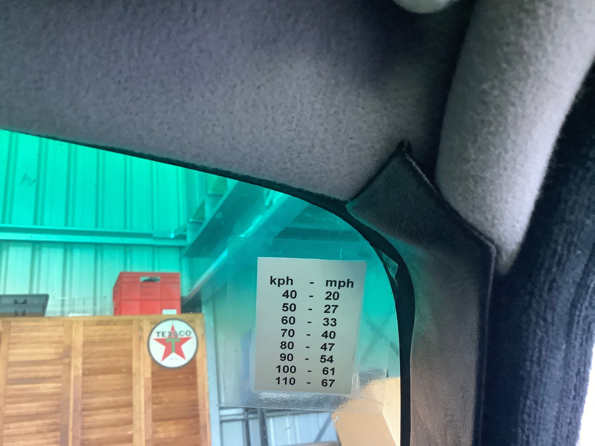

My calibration is out a touch so I got my GPS and drove up down a local back road a few times to confirm my speed then stuck this to the windscreen where mechanics usually put the service sticker.
Easy for anyone driving the car to know their speed at a quick glance. I never need to look at it but it’s great for the wife,son or my mates when they are driving.

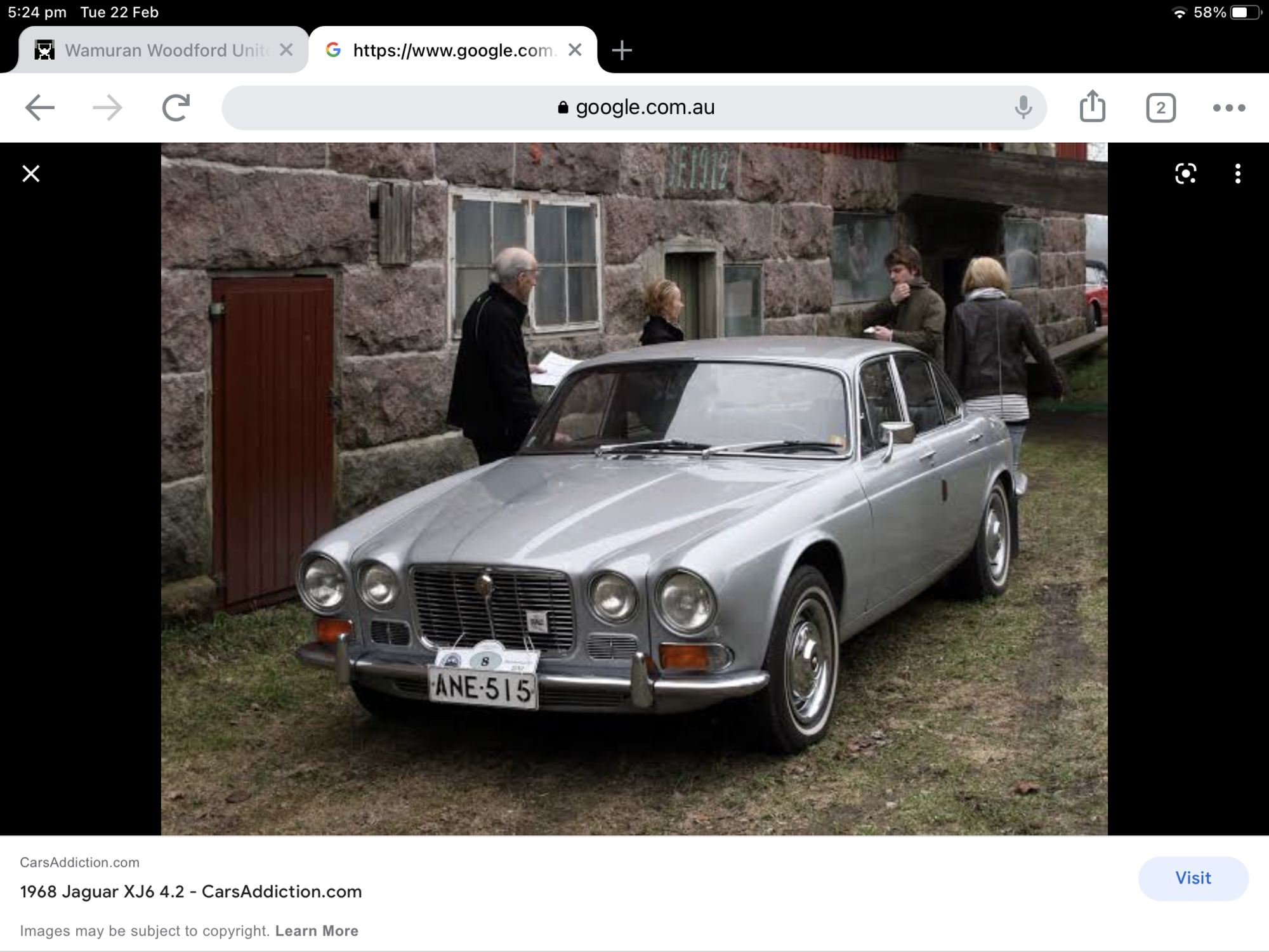

Hi Dave,

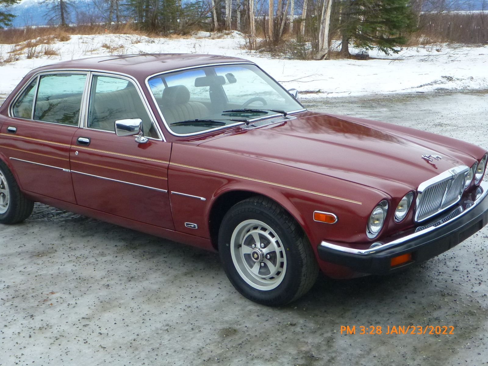

In my opinion mine wipe the wrong way, but here is a pic if a left hand drive car parking on the left.
Seems very inconsistent on old Jags. I have seen local cars that park different to mine.
