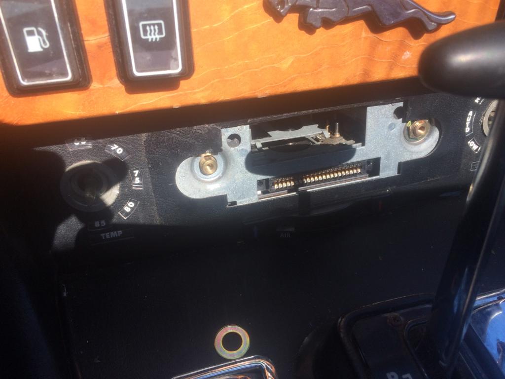

First: The radio. Now I have the awful, face plate removal radio that apparently is crap. Mine is also crap as the volume only stays up at the highest volume and won't go down. I bought a replacement but I can't seem to get the original radio out. I remove the knobs, pulled off the faceplate, and from there nothing budges. Any help?

See pic for the radio. 1986 Sovereign in the photo but I assume yours is the same, the radio is held in with four push-rivet-things that you have to pop out.

That's a negative, I have the Audio Systems Inc. radio, so my panel looks like so:
RADIO: Be sure to remove the round nuts inside the heater control knob bore. A small pointy noise pliers opened the right amount and twisted will do the trick.

Once you remove the slotted nuts that ICS describes that black panel with the a/c setting should come off and expose whatever audio mounting you have.

Appreciate all the help guys! I got the radio in, have to modify the faceplate to get it all flush, but it's nice to actually have a radio! I also got the fuel sender working, but it's still on and off, so I'll be cleaning it better today.
