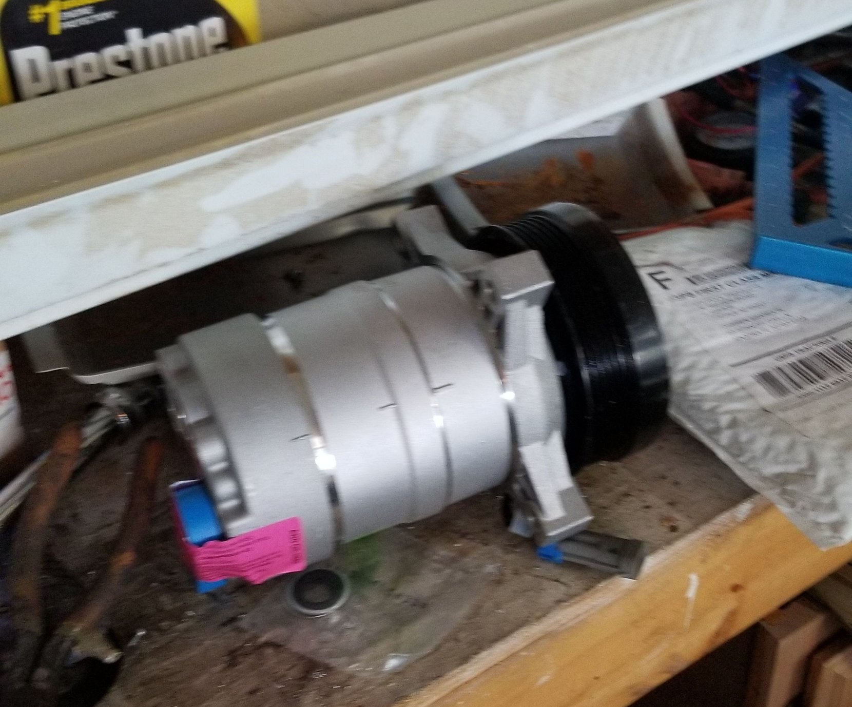

I cant win!!!! Picked up car from trans shop this morning, got half way home and compressor locked, pulley locked too!! Bye bye belt!! Had to limp home with no alternator or power steering... not fun!!! I knew compressor was failing as it was noisy when in use, so i didnt use it! , apparently it didnt care! Lol i have a new one ready to go, but now i am going to have to flush everything as well! Anyways.. the drive home( before belt broke) (with 4th gear or overdrive, whatever you want to call it ) was fantastic. 50mph at just over a 1000 rpms...
Will replace compressor this evening and throw a belt on it, just to drive some more, wont hook up hoses or electrical just yet. Need to buy flush!!
then i can give her a bath, been sitting outside trans shop for month.. shes not the cleanest..

New one has been on bench for 2 weeks now, as you know Carl, the lt1 only has the one belt, luckily waterpump is driven from cam.

I installed the new compressor but failed to remember to buy a a new belt... ( old age.. lol) battery was on charger all day so wasnt afriad to go for a short drive.. gotta love it!!

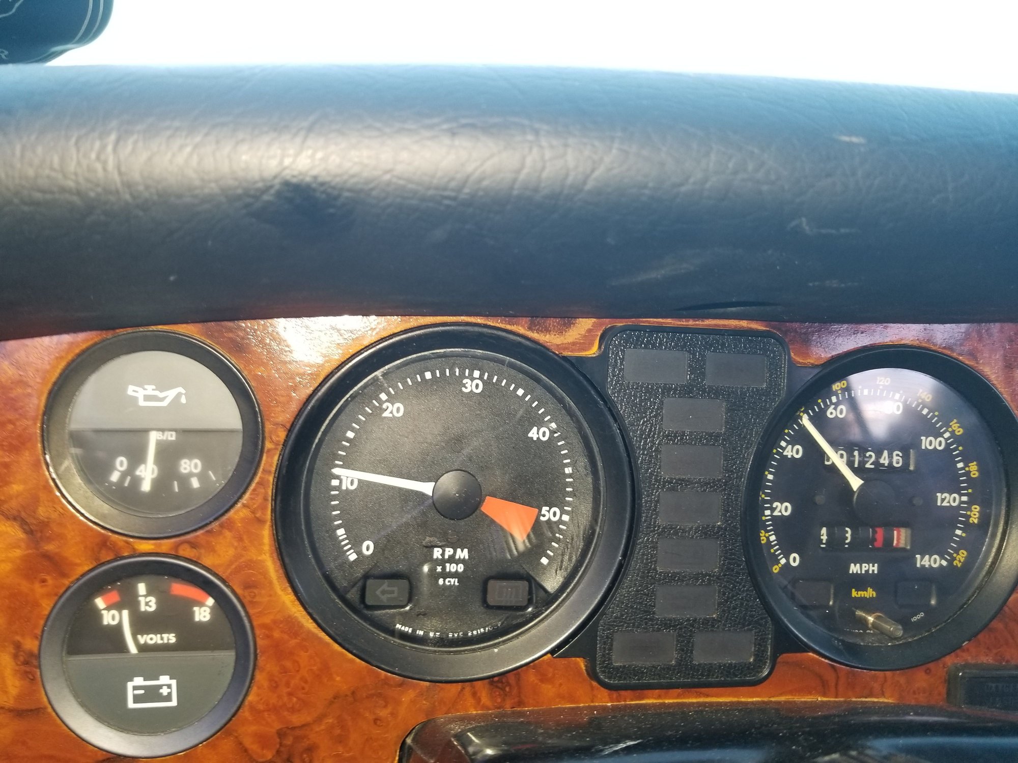

Side question. In the photo it looks like the needle on the volt meter is curved. Is it really that way or just a photo anomaly? If curved I wonder how it got that way. Sorry to go off topic. Air conditioning is good.
Jeff

Hahaha well. Now i need to go home and look at my.volt meter. Hopefully its judt an optical illusion!!!

The needle of my voltmeter in addition to being lazy to wake up, also has a kink in it, albeit not as much as this one in the photo.

Strangely, the needle on my car’s voltmeter is also bent like the one in your photo!

I'm intrigued by this.
I just looked at Nix's needle from all possible perspectives, and it's Straight.
Of course, she Is a Series 2.

Well I never actually went and looked to see if its bent as bad as it looks, been busy with other stuff, hopefully i will remember to look tonight when i get home..
