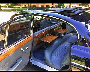

the 1960's MK-X and 420-G had wonderful picnic tables at the back of the front seats. The seats in those models are quite wide, being that the cars are super wide themselves. Some jokes call the MK-X "the XJ with the air let out".
Worth investigating if the front seats might fit in the XJ.
That's what inspired me to want picnic tables. But just looking at them I’m sure they are too wide.

the seats might he too wide, but maybe the picnic tables can be adapted to XJ seats.

The X300 and X308 cars have seat frames with attaching points for the tray hinges, which I doubt a Series 1-3 car has. There is also an attaching point for the small trim piece that goes on the seatback above the table tray.
If you're taking table trays from a wrecking yard, don't forget that upper trim piece. The veneers are all from the same tree and book matched, so a trim piece from another car won't match.
