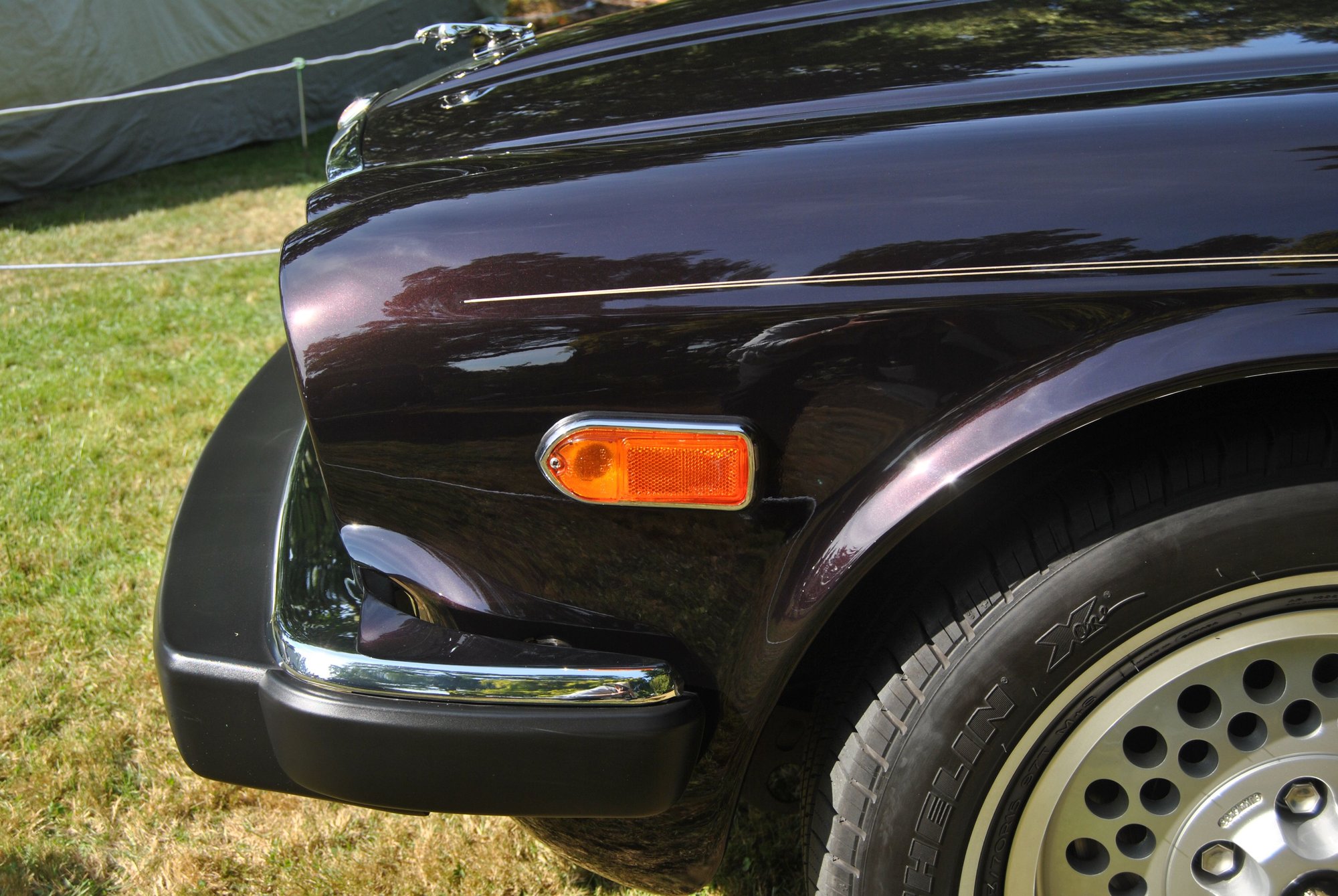

Correct again. And regarding coachline length, the photos show this correctly (this car is my 1992 V12 Vanden Plas, colour Black Cherry, #92 of 100 made):

The application: I suspect it was a case of good hand and eye coordination, and lots of practice. Here is a photo of the coachlines on another V12 VDP (1990); the factory coachlines had a rounded, blunter end to them but they ended in the same spot.

Andrew: I would happily do a measurement but I cannot because I no longer have a Series III car (#92/100 is now in Beijing...every time I look at the photos of it, I regret selling it...but a drive in my F-Type soon fixes that). In any case, the swage line indentation serves as a very good guide. As long as the coachlines do not extend past the end of the swage lines, they will look right. There was a certain amount of variance even on the factory application.
