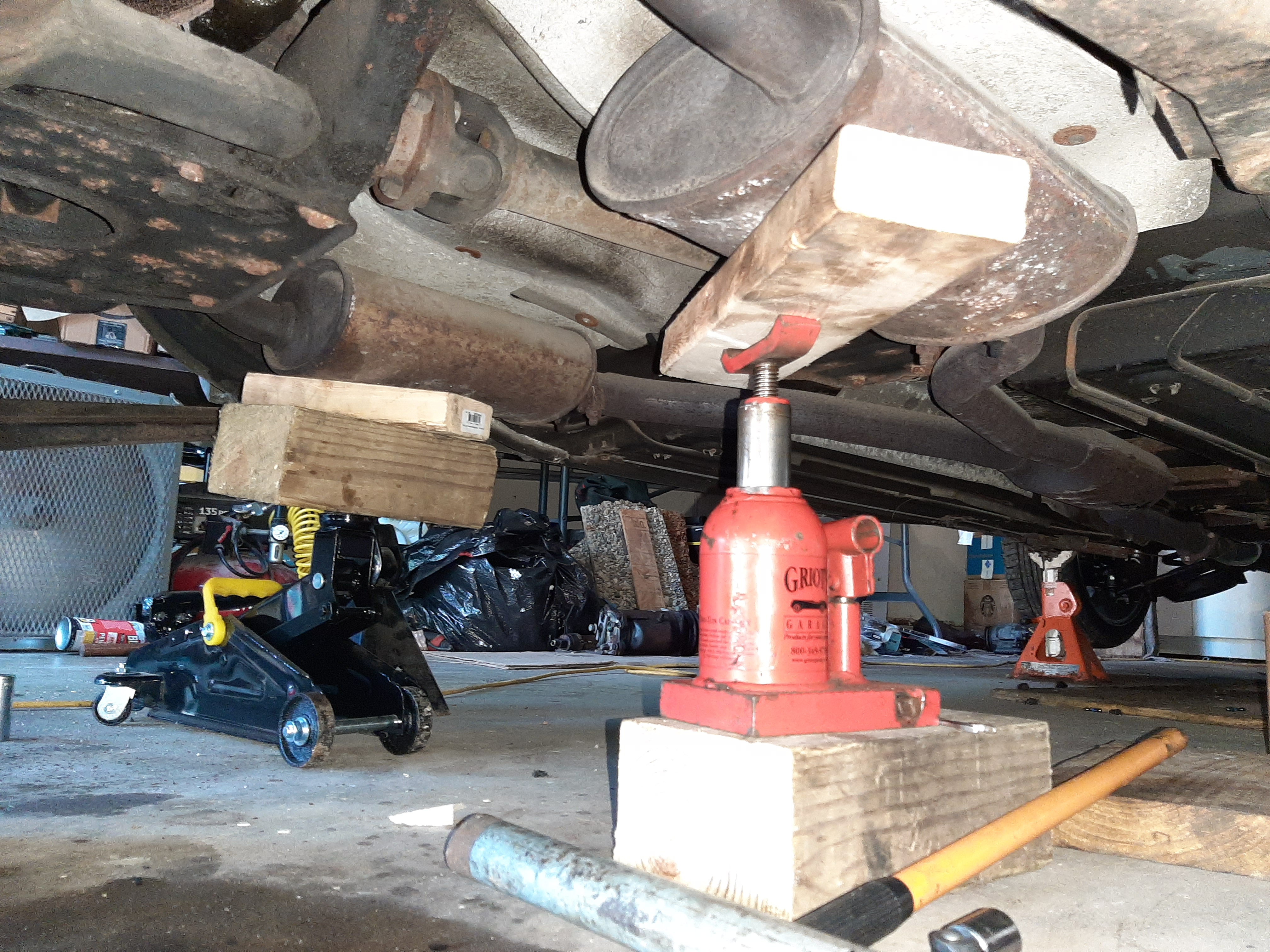

The manual tells me to start the car, place it in neutral depress the brake pedal and loosen the bleeder valve. Repeat until pedal is firm. Hmm, with the location of the rear bleeder, couldn't I just turn the key to the on position, attach my vacuum pump, open the bleeder and draw out the air and old fluid?
Here's how I got the clearance to bleed the rear.

I was able to gently raise the muffler so the crossover pipe move above the bleeder.

No, I did not raise the entire car on the mufflers. It is sitting safely on jack stands. I was careful to raise the exhaust pipes just enough to gain access to the bleeder valves.
I did not start the engine as I can't since many components have been removed for replacement. I did turn the key to the position just before "start" and had a friend pump while I released. I bled all lines many times and the pedal is way up and much firmer. It's a good sign. I'll know for certain once I get the car back on the road but I feel good.
