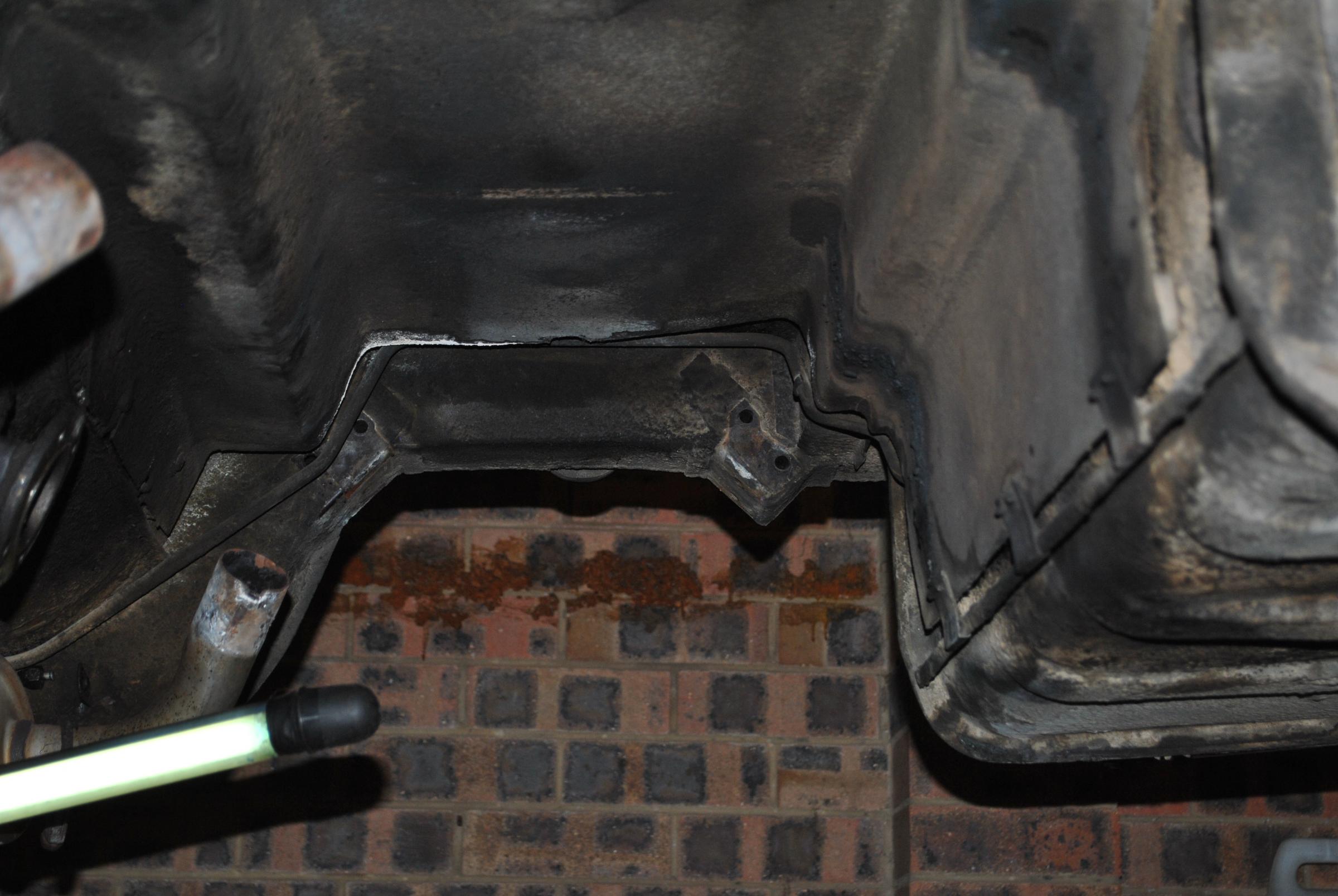

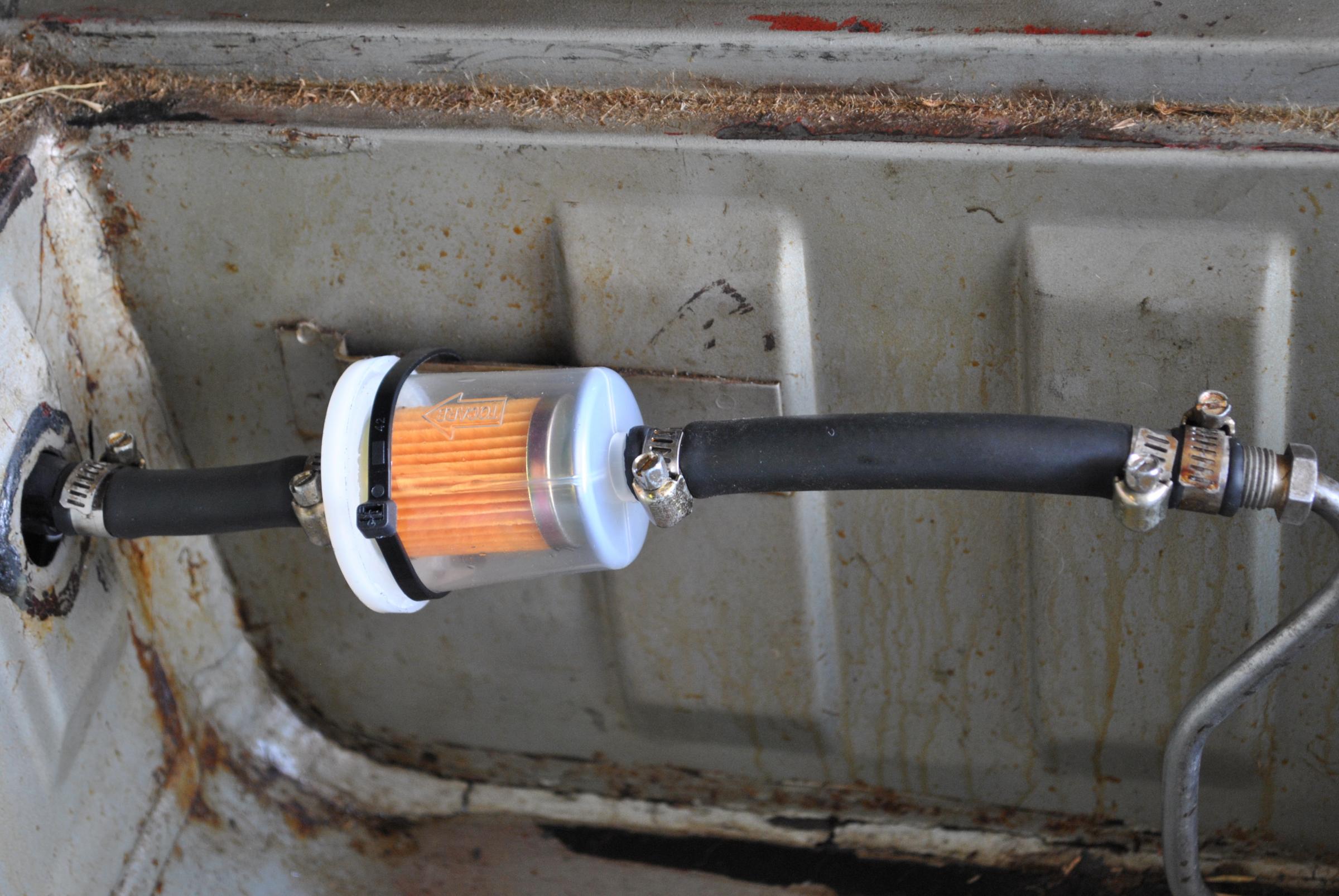

Originally Posted by Grant Francis
There is a fuel hose up above the rear suspension cradle on the RH side, and is easily FELT, but almost inpossible to SEE. This hose is OLD now, and may be a thing to add to the TO DO list.
I would think if you have a fuel leak big enough to keep the pump running you would smell the fuel and be able to see it dripping somewhere.
I know when my float chamber needle got stuck I had fuel running out of the overflow within seconds.
Here is a pic of where the fuel line exits the spare tyre well at the front right(looking into boot from the left of the car)
And the second pic shows where to find the fuel line route is above the cradle(taken with the cradle removed) from the left wheel arch.
these 1000's of pictures I have taken of this car do come in handy from time to time.
S1- Fuel pump continues to prime-dsc_0416.jpgS1- Fuel pump continues to prime-dsc_8955.jpg

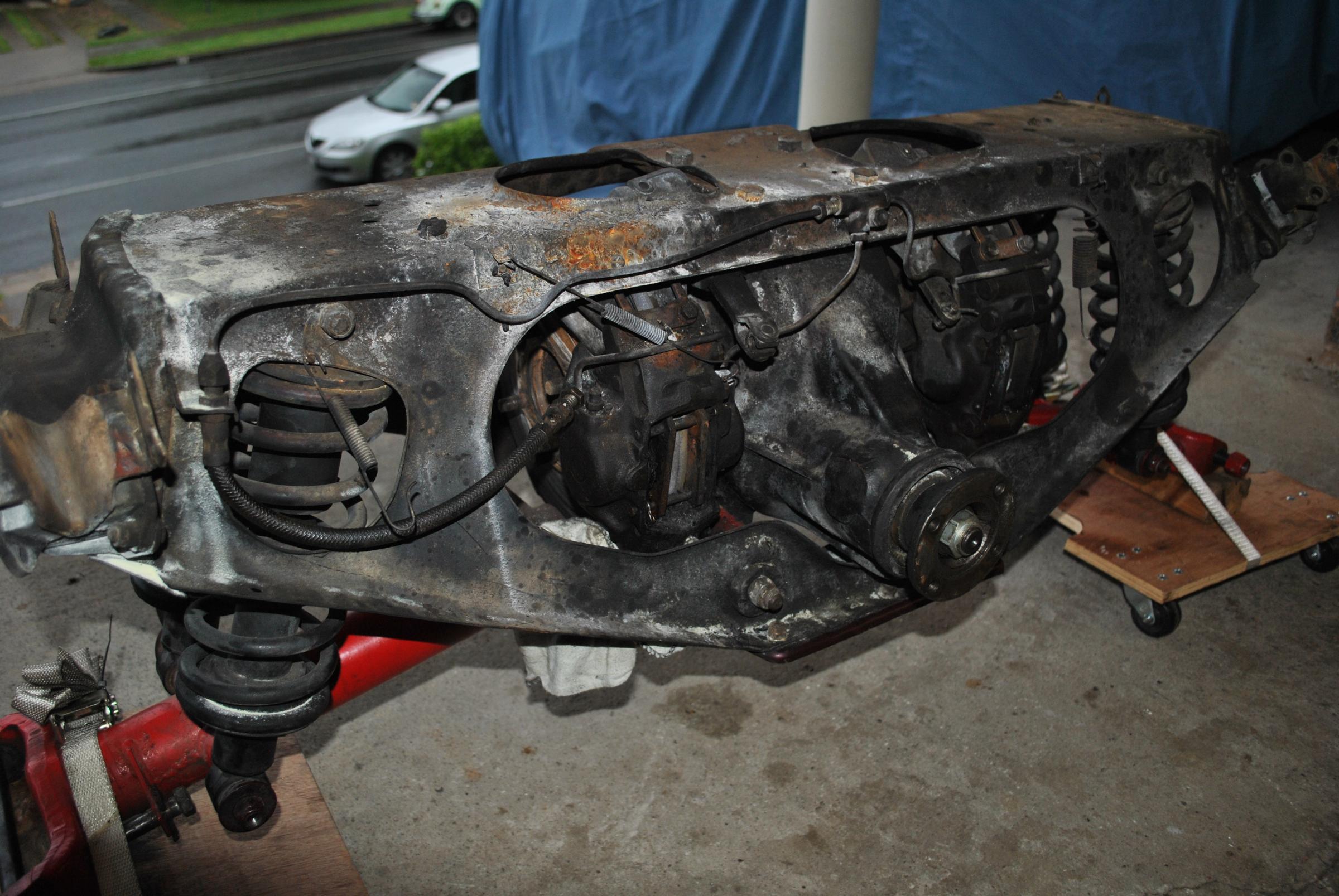

Actually, looking at that second picture now really sinks in how close the fire was to the fuel line, the hottest part was right below that pipe. Just imagine if it was newer car with rubber hose.
