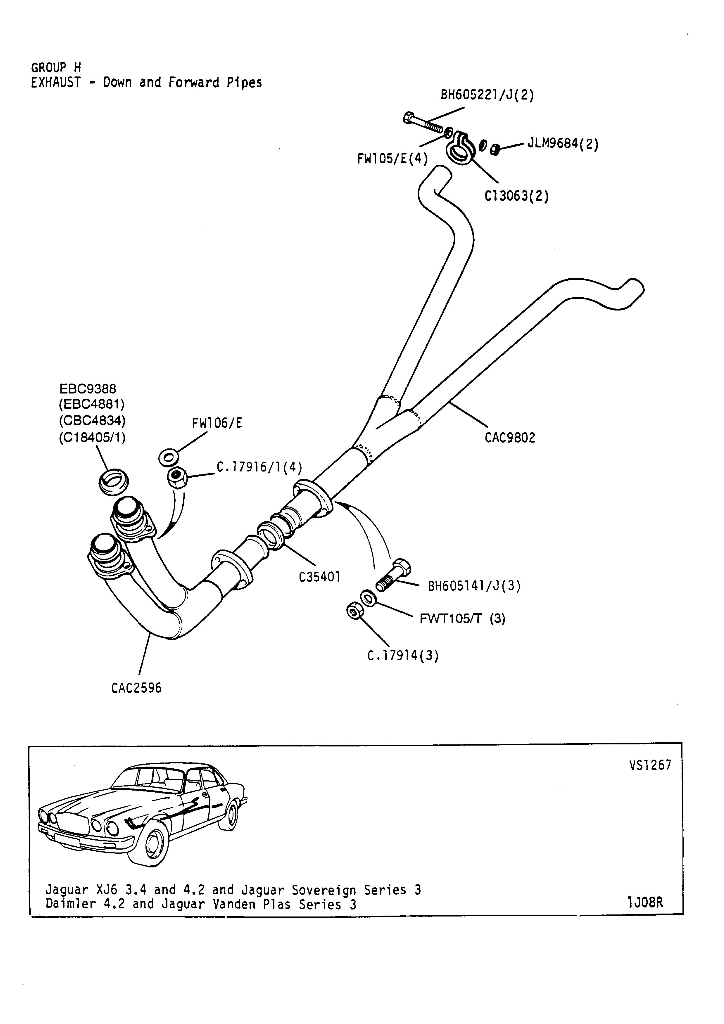

Originally Posted by iramphal
I've been looking at various parts catalogs, SC Parts Group, SNG, Welsh etc and they all show differing part numbers for the Series 1,2 and 3 models.
The most current number (that I'm aware of) is EBC9388. The number has changed several times as evidenced by the illustration below.
