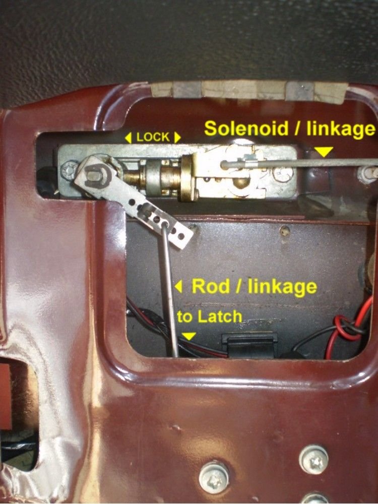

no, the trunk/boot lock can only be unlocked manually, but it can be remotely locked, (only locked) , from the driver's door.
So you might try removing the license plate, and through one of the oblong holes on the right side, grab the connecting Rod and pull it UP to try opening the boot lid. Thin needle nose pliers work best.

here's how it looks behind:
Old Mar 17, 2020 | 01:23 PM
Justin84's Avatar
Joined: Mar 2020
Posts: 21
From: Bath, UK
That's really useful, thank you! Now I know roughly where to aim.

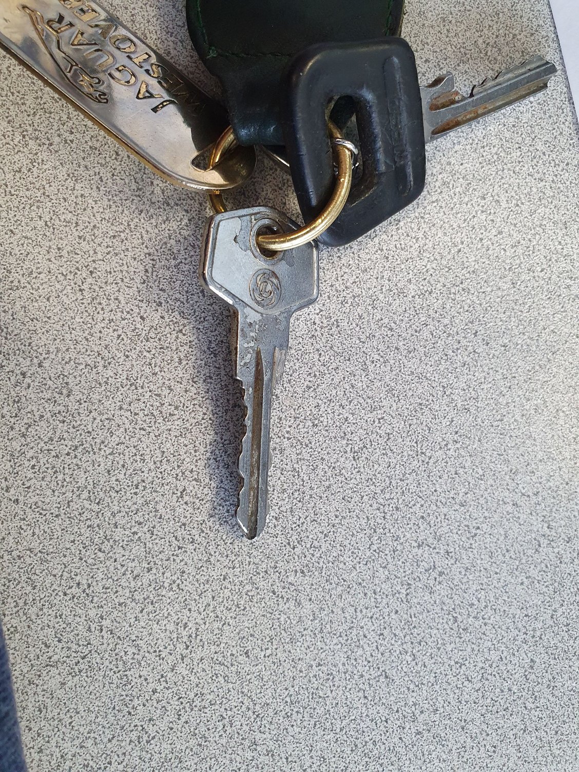

I've only just bought the car, it only came with two keys, the ignition key and the dome headed key.
The owners manual says three keys:
Ignition Key
Dome headed key - opens everything (boot, doors and glove box)
Dimple headed key - only opens doors (valet key)
