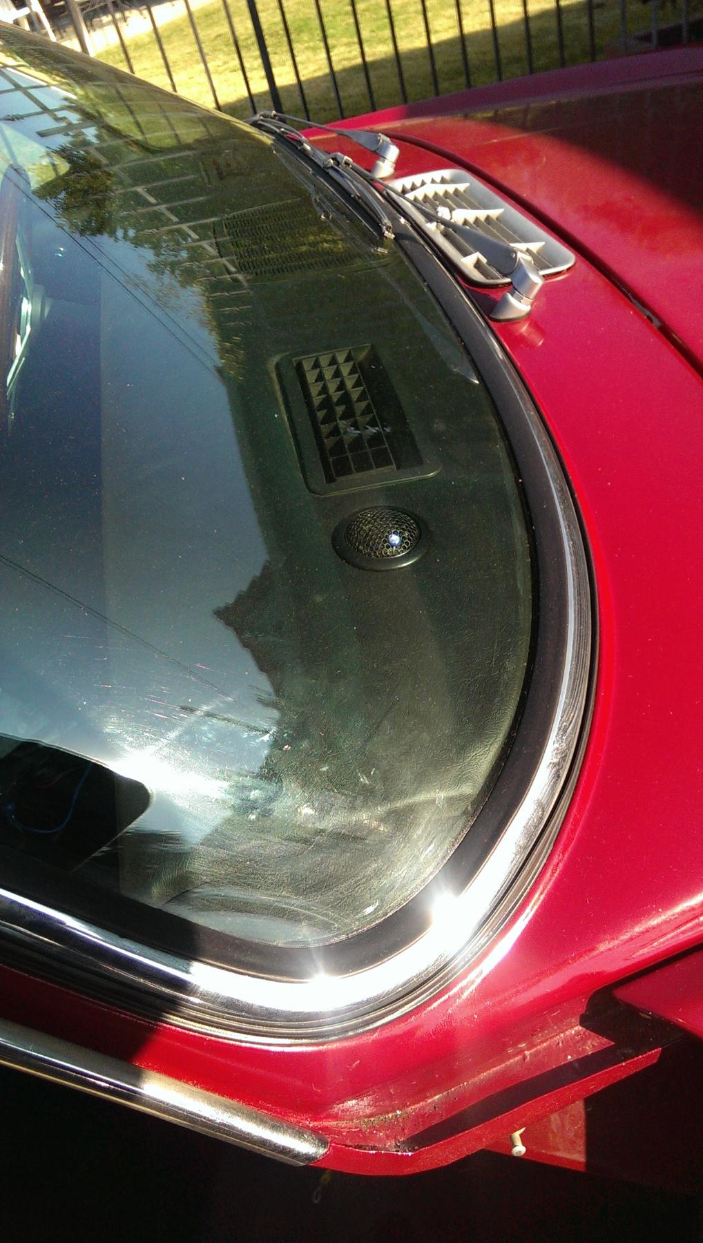

Can you tell me which rear window seal I need from the pictures below as I am about to order a rear windscreen rubber in the next few days. Third picture is the front screen.

That is definitely a late model. You can still see part of the seal. With early models, basically all you see is chrome.
keep in mind you also need the rubber inlay strip together with the seal.

Your trim and seals look the same as the '72 that has the Kitx numbers.. they include all that is needed for each window = KITZ.
