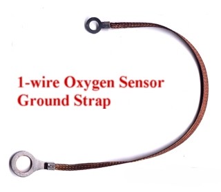

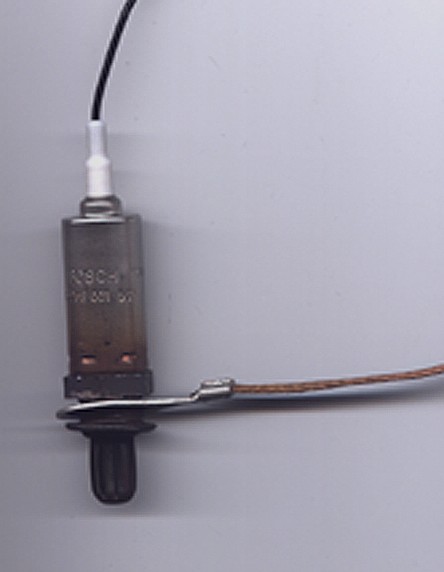

one trick not mentioned that could fix other symptoms in your 1984 is to add a ground strap to the 1-wire oxygen sensor. (this only works in early Series 3, 1986 and 1987 XJ-6 came with separate ground wires, also known as 2 or 3 wire O2 Sensors).
I added one to my 1984 and it made a difference making the idling more stable, and also helps with starting the engine.

hi Rhett,
I made my own years ago. Then made a few for other owners. I could make you one since I have all the parts to make them including the large ring terminal shown in the picture and a new crush washer, but I am away from where I have all my supplies.
however, if you go to a junkyard where they have salvage XJ-6, look for the ground strap for the radio, one side of which is bolted to the driver's side of the transmission tunnel, (you have to raise the carpet to see it), and the other side of the strap is the side which is normally bolted to the rear of the radio.
then you can drill a hole large enough on one end of that strap for the O2 Sensor to fit through. the other end is attached to one of the bolts of the Cruise Control Bracket.
another option: get a thick insulated wire and wrap it very tight around the base of the O2 Sensor, the other end of the wire goes to any nearby bolt that attaches to the body.
the O2 Sensor gets very very very hot, and it will melt the insulation of the wire. You can do it just to test if it improves anything in your car.
the idea came from a reputable mechanic who used to contribute at another forum in the 1990's and who said that as the manifolds get rusty and greasy in these cars, the grounding of the O2 Sensor becomes less "positive", so adding a dedicated ground helps the sensor send a better signal to the computer. I tried it and it works, regardless of the skeptics.
