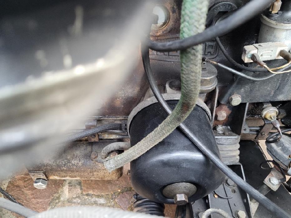

Default Please advise, gasoline is flowing from the overflow
gasoline flows from the green tube
_____________________
1974 XJ6 (added by GGG)
I think that would be carburettor float valve not working, or blocked, and thus staying open, so the float bowl overflows.

Thanks for the advice, today I discovered the hatch scrubber, dented cover. He grinded and also put new oil in the pistons. Gasoline did not flow after starting. Test drive 5 km, return back and the petrol was dripping again. It dripped a little. I'll have to take apart the float.

Check that the float chamber breather to atmosphere is not blocked. Most common cause of overflowing float chambers on SU carbies.
Old Jul 19, 2022 | 10:51 AM
KarelH's Avatar
Joined: Jul 2022
Posts: 7
From: Markvartice
Thanks Bill, is that the screw?
