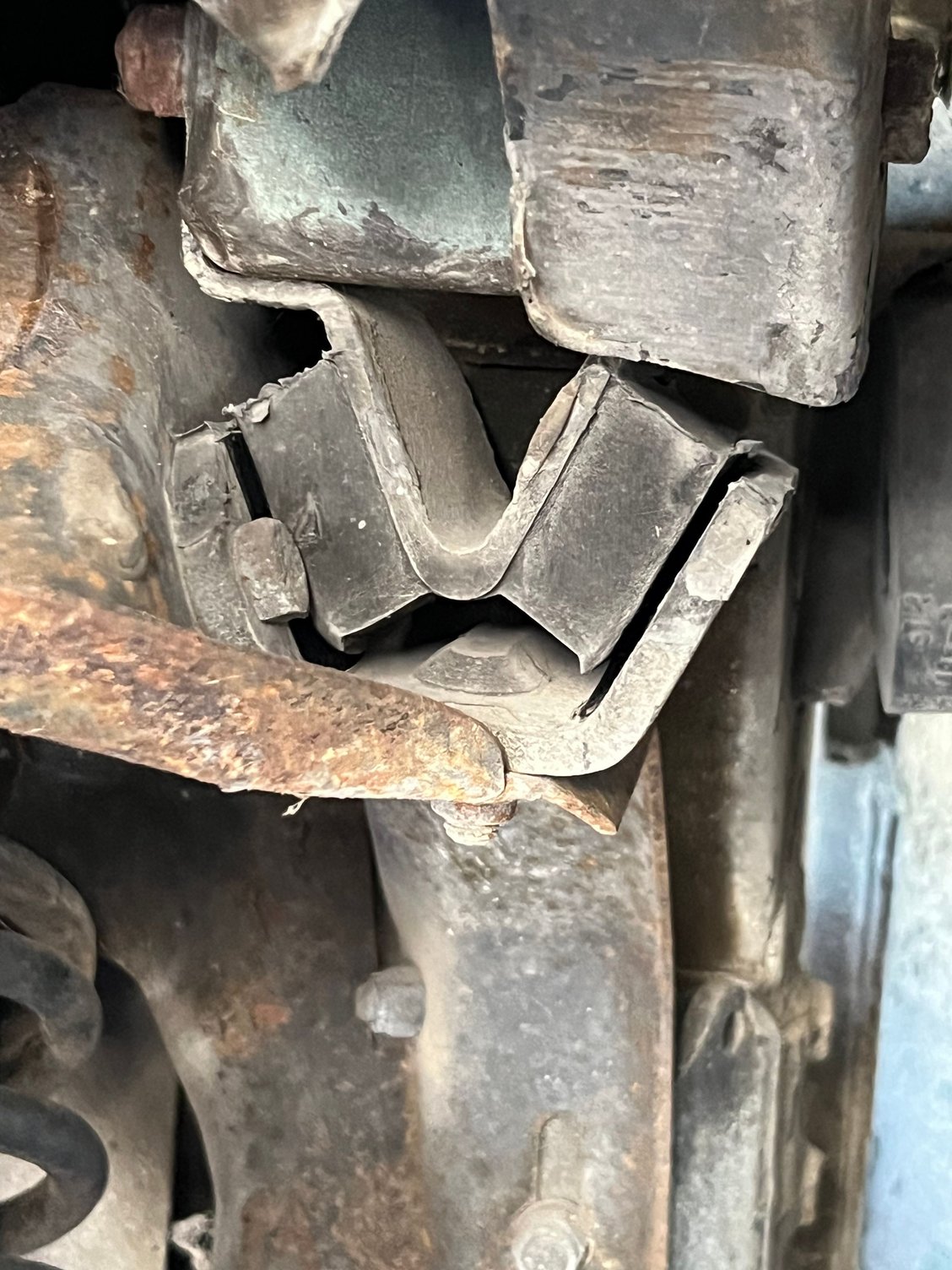

Had the Jaaag on a lift today.
two question marks:

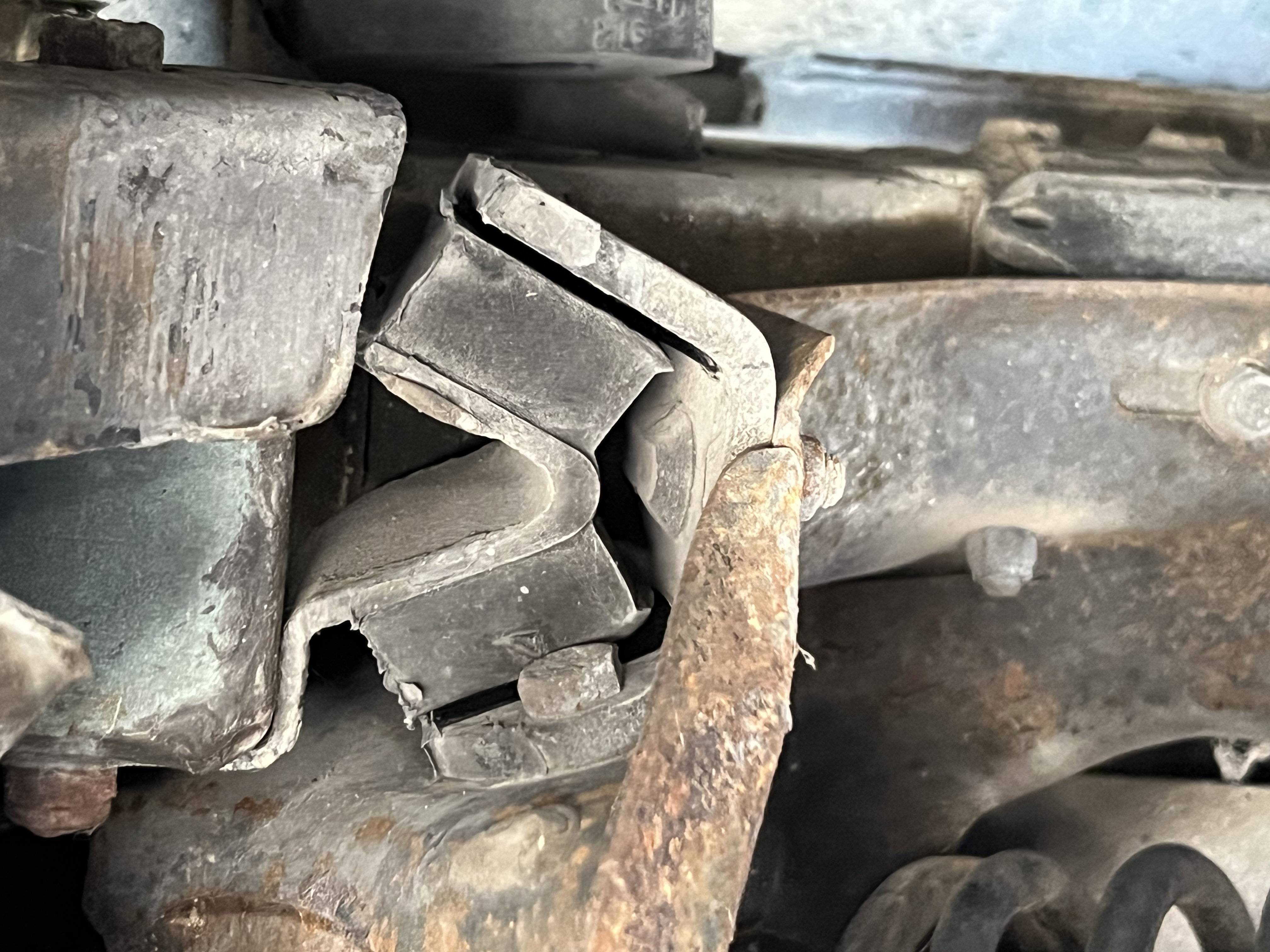

1) See picture below: it looks like two of the “mounts” on the irs have separated. I assume I should replace these…what is the risk of driving in the meantime? Can they be replaced without dropping the whole irs? Looks like I could maybe jack up the rear end and slide new ones in.

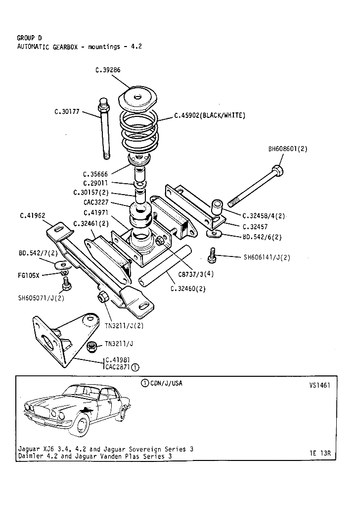

2) see attached video. this spring that supports the drive shaft seems really loose. Should it be that loose? If not, what part should I replace?

That Vee-mount doesn't look good. Not safe to drive, IMO. You should be able to just lower the IRS a bit and replace the mounts. Some of the aftermarket replacements are low-grade. I'd use OEM mounts. or....somebody out there (SNG?) is apparently selling a upgraded aftermarket type that is supposed to be good. Let's hear what other have to say
The transmissions do bounce on these cars but that's look excessive. The inner "cotton spool" bush...which would limit the movement.... is likely shot. I replace the bush and the two rubber mounting blocks as well....as they're almost certainly oil soaked, gushy, and sagging. Part numbers CAC3227 and C32461
When disassembly the mount assembly pay close attention to how everything goes !

Thank you! I have new V-mounts on the way and also ordered the Transmisson buffer and mounts from Moss. Looks pretty straightforward!

The transmission mount has a big spring in it. Be careful taking it apart.

It is perfectly possible to replace the rear V-mounts, and I've done it myself. The photos show the normal failure mode known to Jaguar owners and mechanics since the IRS design came out in the 60s ! As Doug says, make sure you replace with known good parts, there is a lot of junk now in the classic car spares market.
I also replaced the rubber bush in the transmission mount and don't remember anything complicated when doing so.

Finished the V-mounts! Second side went a lot faster than the first - quite an interesting setup, but not too difficult once you figure it out. Was good that I did it - one V totally separated while I was removing them, and another was noticeably cracked.

Got the Transmission mount apart...was a bit tricky, particularly the nuts that go into the transmission pan bolts, and I think I should have done the center nut last, but it worked out.
I do not see any sign of an original transmission buffer, so whether it was removed by a PO or disintegrated in service I know not, but likely the primary cause of my bouncy transmission.
I took a chance on transmission mounts from Moss motors...they were not labeled with a brand so I don't know manufacturer, but part number was correct and THE HOLES DON'T EVEN LINE UP CORRECTLY - ARRRGGGHHH! Hoped I would be safe ordering from Moss, but no dice. I'll try to find and order some Jaguar brand and hope they arrive soon, and fit.

Closing this thread out, as I finished the Transmission mount last night. Wow - the old pieces were really bouncing around bad. New install and everything seems pretty tight. Ended up sourcing the mounts from a Jaguar dealership (imagine that lol). Looks like they are MTG Rubber. At least they fit correctly, unlike the aftermarkets I got the first time!
