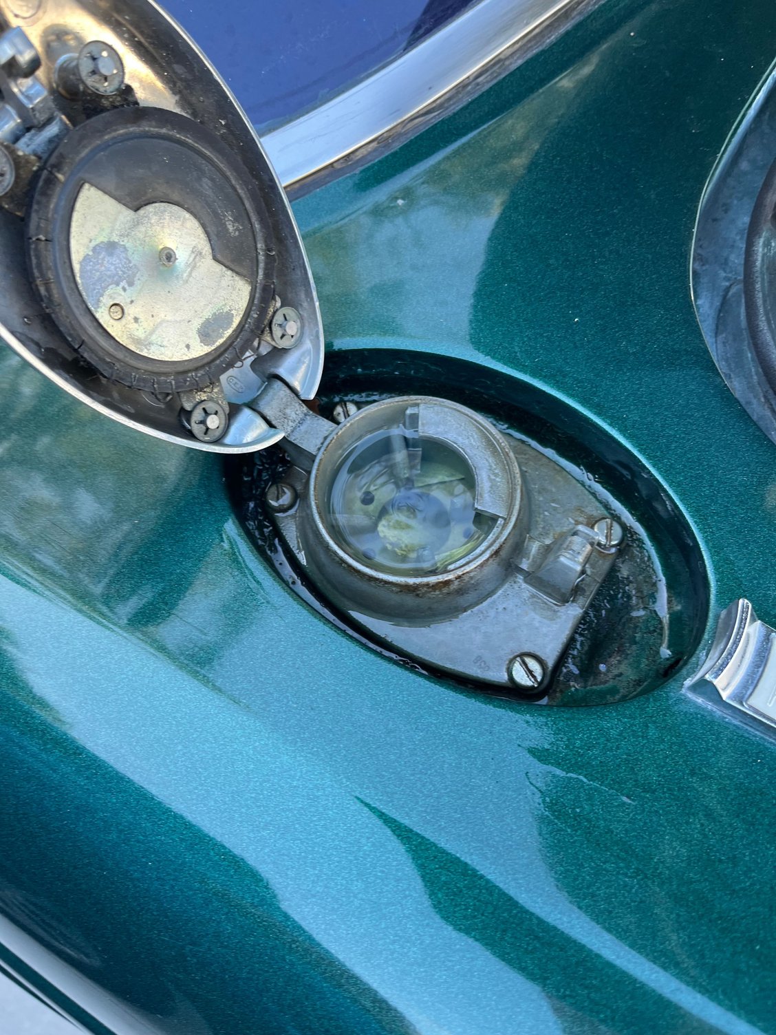

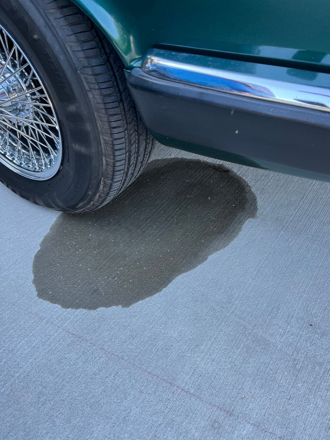

She’s been trouble free for a long time now and then this!!! I knew I was tempting fate when I told my wife that we could get in her and go anywhere, she’s super reliable!!! Should have knocked on wood!!!
I know it’s a common problem but cannot remember which valve I need to be looking at! Running on left tank and all is good, running no. Right tank, left tank overflows!!!

I *HATE* it when that happens!!
It's a good thing that drain works or you'd have a real mess on that paint.
(I can tell you how I know that)

These cars need a check valve like aircraft to bleed off water and check condition of gasoline. Inevitable given the age, culprit is probably the changeover valve but the reason is probably dirty tanks.

I think it's a non return valve in the wheelwell is stuck closed. One is normally open, the other normally closed, but I can't remember which side is which. I'd replace both.
Here is the testing procedure: https://www.jag-lovers.org/newbies/s...hangeover.html

thanks that gave me the info I needed, left valve is normally open!!!!

Well, it looks like I'm swapping out both valves!!!! Got sometime this afternoon to check everything out and of course it’s working perfectly now!!!! I can switch the tanks over and by holding open the flap, i can see the fuel returning to whichever tank I select!!!
