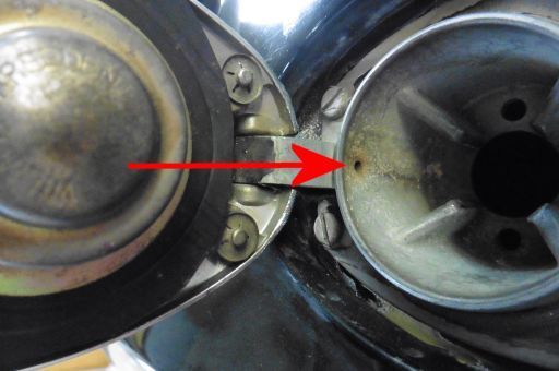

Hi, don't have any pictures handy but going from memory, the filler neck has a very small hole on the forward side that goes to the tube the vent hose connects to. I cleaned mine with a used guitar string, but I think I also have seen a cleaning brush set at harbor for small carbs that would work. The clog might be elsewhere but could hurt to start with the easy fix !

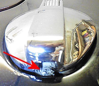

Brian is correct.
Arrow points to small vent hole in the filler neck.
Arrow points to the vent hose, at the forward end of the cap, that disappears into the fender to the vapor recovery system.
This is a poor photo but best I could do.
It will give you the idea anyway.
