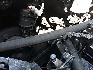

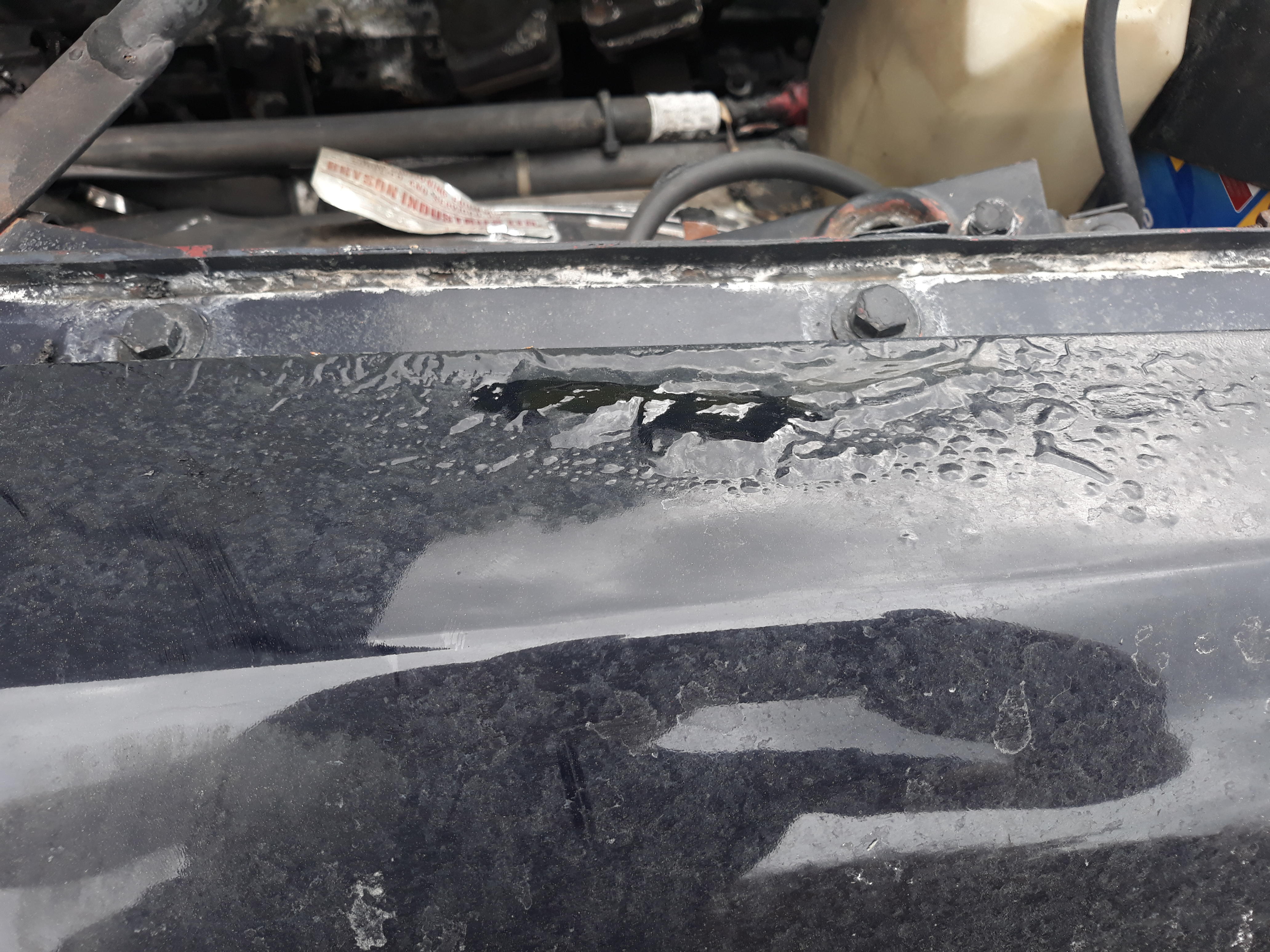

I have owned this jag for about 15 years – fire in the engine bay may see her not coming home.
Short story
I replaced the fuel pumps and when I began cranking the engine the fuel vapour in the engine bay was ignited and some things burned.
Long story
About a month before Christmas the “Oil Beast” was due for rego, so began the pre-rego check and maintenance. This included starting the car, taking it around the block to check brakes, steering, noises, exhaust etc. BUT – it didn’t start.
So began the process;
1. Check for spark – remove and clean all plugs – crank – no ignition – lead off cranking – spark spotted – hmmm
2. Check for fuel – yep – can see it in the fuel filter – filter looks clean – crank while watching fuel filter – no movement – hang on a minute – fuel pump ticking noise NOT present – change to other tank – still no fuel pump ticking noise – surely both can’t be gone?? – YEP – they can – remove one pump and bench test – yep buggered – order 2 x fuel pumps.
3. Wait a month until the Friday before Christmas – fuel pumps arrive – why so long? - $125 each cheapest in Oz - $100 for the pair delivered from O/S – I had time, the car wasn’t going anywhere.
4. Saturday before Christmas – bench test new pumps – You ripper - both tick tick ticking along - put connectors on new pumps – replace old pumps – clean up fuel spill from the boot.
5. Turn ignition onto accessories – can hear a tick tick as the new pump primes the fuel lines – flick the switch – check the right hand pump – yep beautiful ticking – stand on the outside of the driver’s door – check that no fuel splashing about in engine bay from the new pumps doing a better job than the old pumps ever did – all clear – crank the engine while standing on the outside – blue flash and then a WHOOOOOOOOOMP – that is not a good sound.
6. Fire extinguisher in the car – best call for the replacement – LEASA!!! GET THE OTHER FIRE EXTINGUISHER – or words to that effect - fire extinguisher emptied – flames still present – hose duly arrives to allow the mopping up operation – thick black smoke to about a foot off the deck – me lying on the floor - fire out – forensic examination begins.
Investigation
If you go back to point 1 – you will see that I removed a spark plug lead – might have noticed that I didn’t put it back on.
That, coupled with petrol fumes in the engine bay created the initial WHOOOOOOOOOMP – this in turn ignited up to 45years worth of a vehicles bodily fluid build-up in an engine bay (no matter how many times you pressure wash a jag you will never get it all).
This build-up and 45 year old electrical wiring (nice and crispy and ignitable) was then the secondary burn. But that was not all….
Imagine if you will… the Jag was in the house garage temporarily and not the usual shed down the back (simply for ease of access for rego test run and check that was meant to be done in November) and rather than bring up the metal drip trays from the shed you use a handy cardboard box suitably flattened. WELL there is a tertiary burn as well ……
From the “WHOOOOOOOOOMP” to me lying on the floor seems a long time – maybe it was 90 seconds – any longer I think the house might have been the next long story.
Were there any injuries? A lack of leg hairs and a sunburn sensation below my calves was pretty much it (I was wearing my safety thongs and shorts) …oh and does pride count?

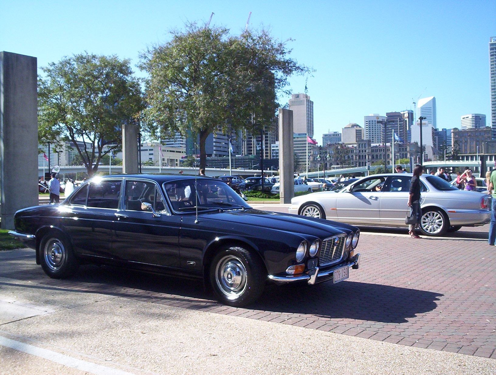

Default This was how she looked in 2005
This was taken at a Jag day at Southbank in 2005
