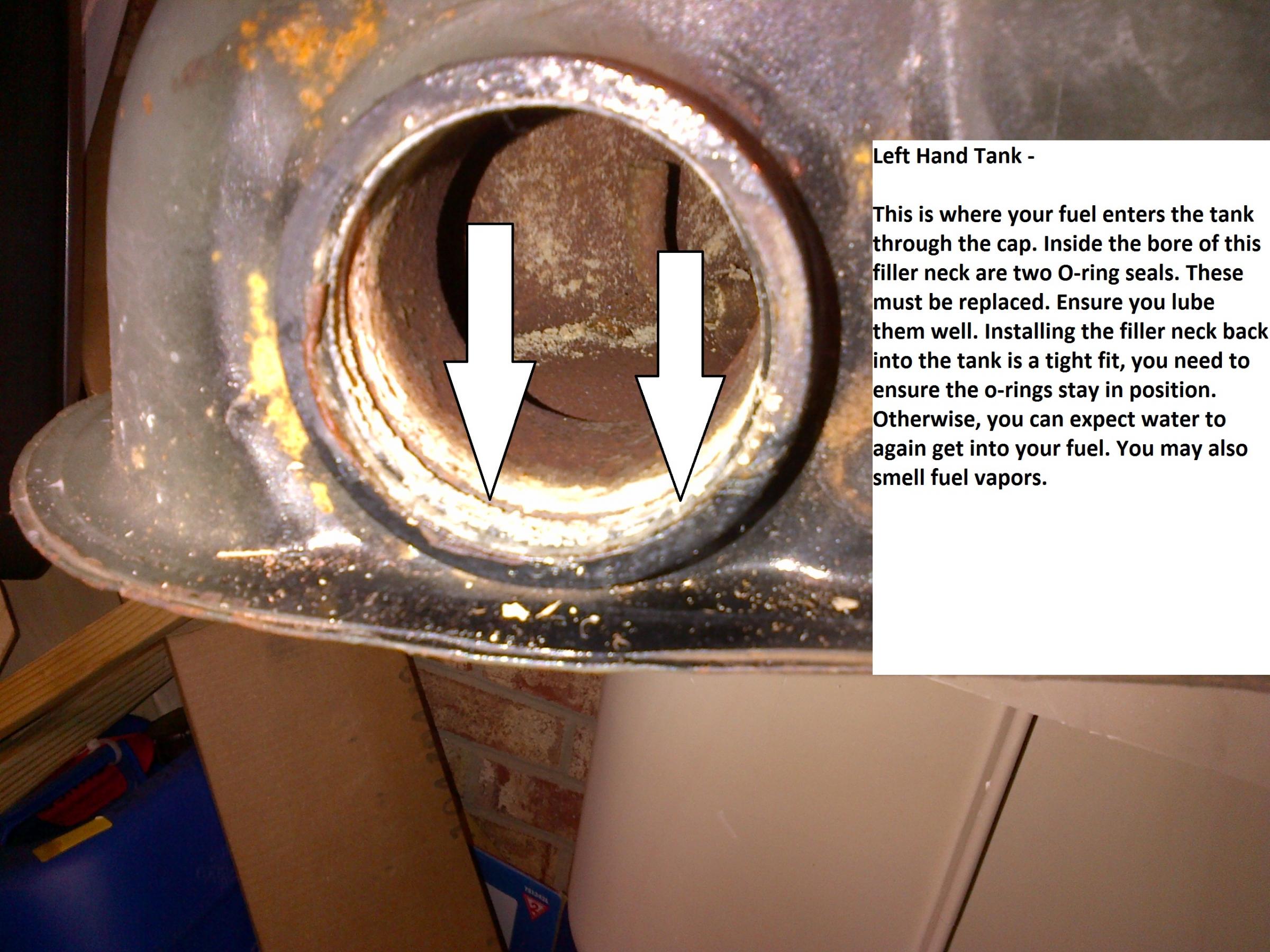

Pete1 - I sent what I could via G-Mail. Let me know if this helps. Looking at this, I see I labled some of the fuel lines incorrectly. If they do not come across in e-mail - I also loaded them all in my album for restoring the saddle tanks. Good luck.
Attached Thumbnails xj6 gas tank-fastener-location-line-location.jpg   xj6 gas tank-filler-neck-fastener-location.jpg   xj6 gas tank-left-tank-neck-o-ring-location.jpg
