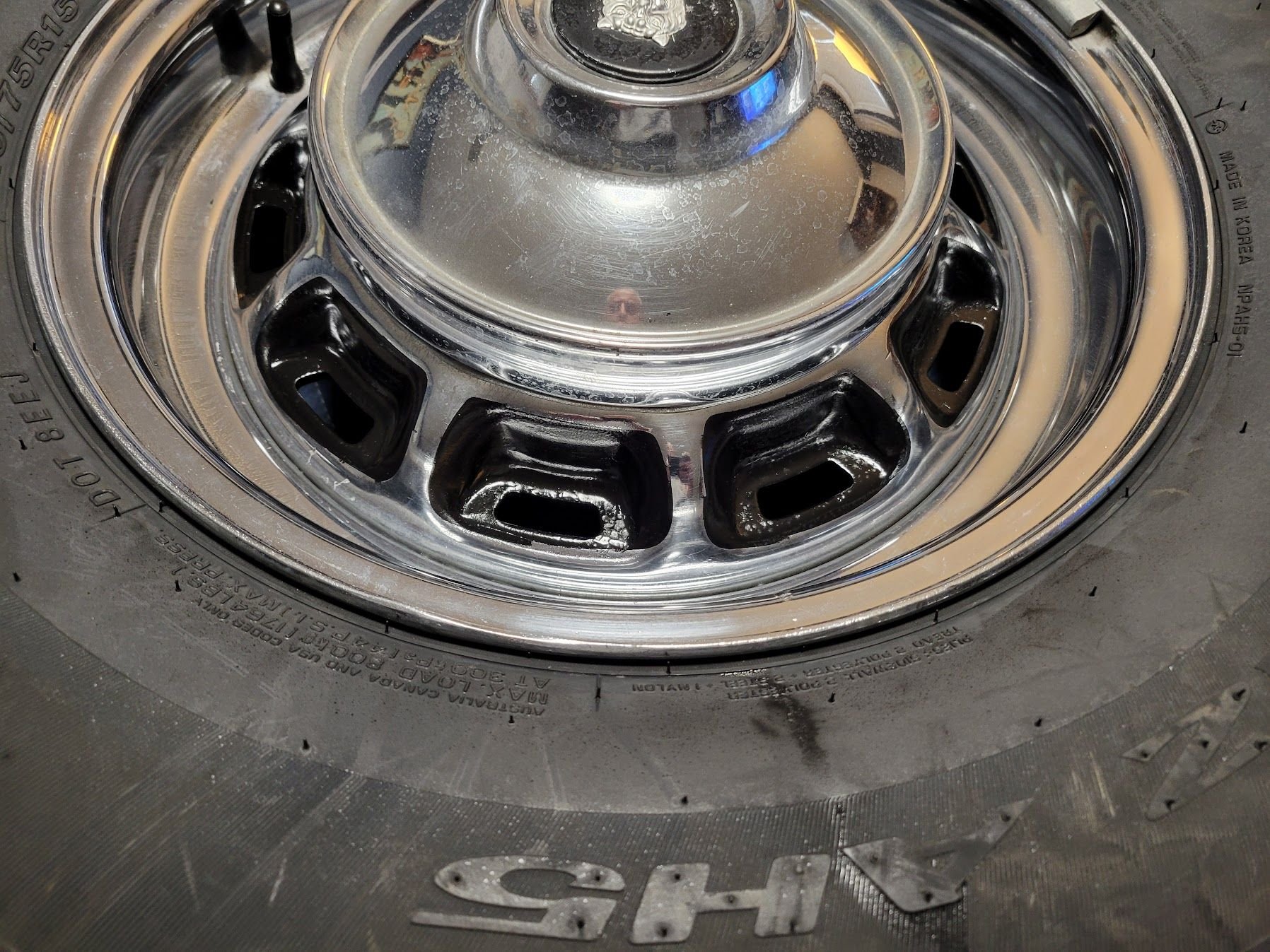

Tried this method for the first time today. High Density Foam Roller and 1/2 Pint of Rustoleum Flat Black Enamel. Takes about 60 seconds a wheel.
I'm sure that with experience & patience, quality will improve, but for now a painful, tedious process averted.

That is absolutely brilliant. Bought 5 of those foam rollers today and some flat black paint and that method works perfect. Can't find the thread right now, but another Forum member tried to make masking a way to go and wasn't very successful. I hope they saw this post.

I might add that I used a Q-tip swab for touchup around the edges.

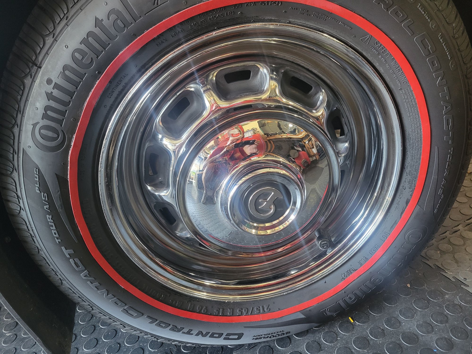

Happy to oblige! Red Lines are from TredWare and still need a bit touching up where the glue shows.

Nice work!
