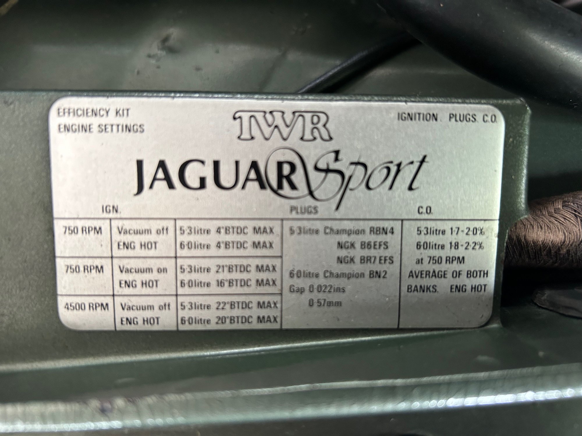

My question for the group is that the TWR JaguarSport sticker in the engine bay suggests replacing with NGK B6EFS or BR7EFS.
The first plug I was able to remove from the car was a NGK BP6EFS. (I will get to the others next weekend ;-) )

TWR JaguarSport recommended Spark Plugs

1) Why would TWR Sport specify 0.022 inch spark plug gap, where everywhere I read the recommendation is 0.025 inch gap? Is there any real impact there?

1) Did TWR do any changes to the compression ratio when they tuned it? They probably had a reason for that recommendation, so that's what I'd go with on this car. .025" is the factory setting.

Thanks for the prompt reply. She is still a 5.3L, and no changes to compression as far as I am aware, but larger throttle bodies and a freer-flowing exhaust (I believe), should should breath a little better, although the TWR branded intake trumpets look very similar to the stock ones (I need to measure their opening compared to a standard V12 one day).

I used the "P" sparkers set at 0.025" I seriously doubt -003 will make any difference, except at Bathurst, MAYBE. Look at any engine, when the ring is being rung out of it, the gaps are smaller, been that way as long as I remember.

1- Does not matter, MORE than 25 thou is bad.

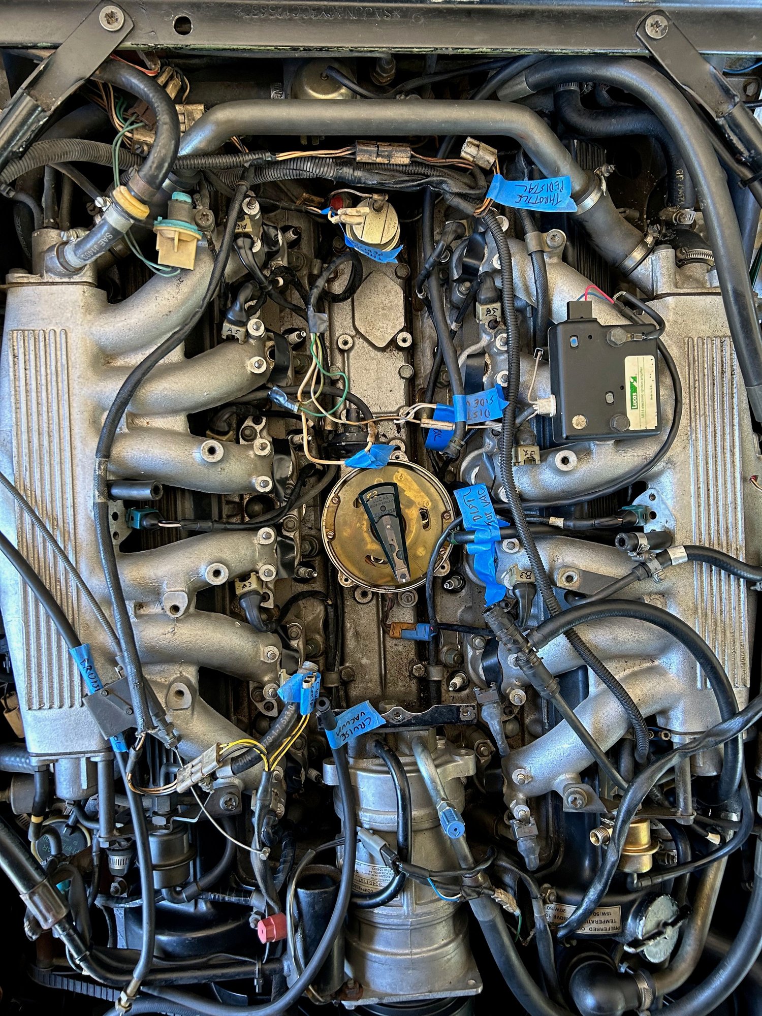

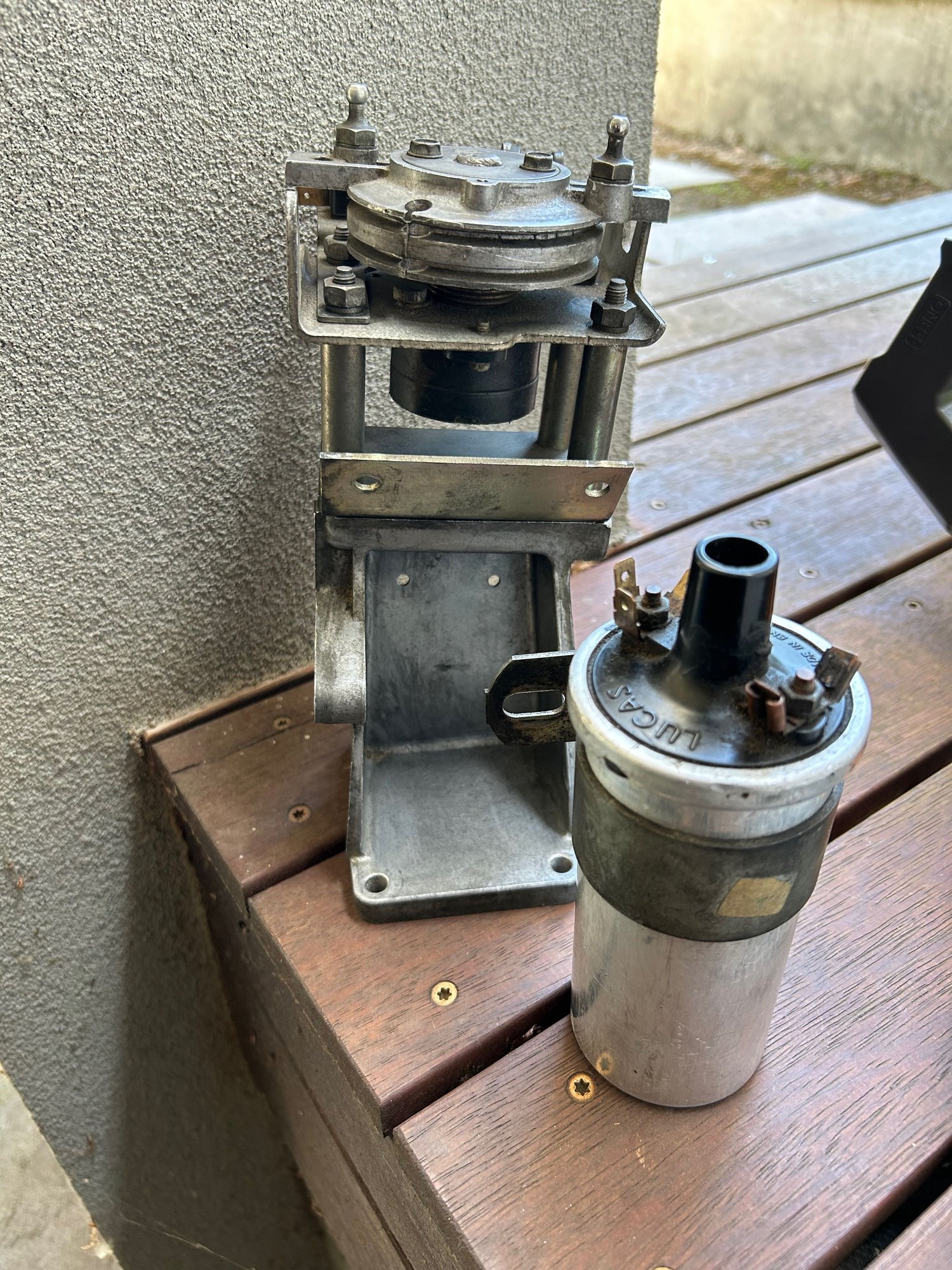

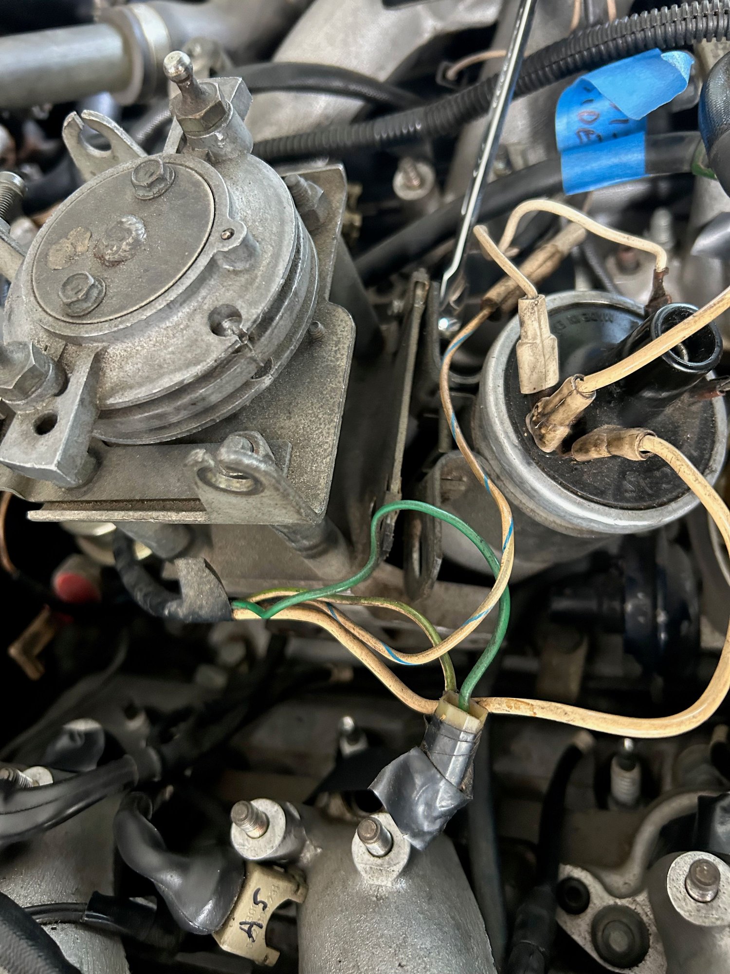

Update for today on clearing the "V" to get the spark plugs out. I noticed that access to 5A and 5B was blocked by the throttle pedestal. OK, so further reading and YouTubes and there are different comments on how easy or difficult this is to remove. As per the pic below, my main coil is bolted to the front of the throttle pedestal. This hampered access to the front two base bolts holding the pedestal to the engine. First off with the coil and then slightly more room to get to the base bolts of the throttle pedestal.
Ended up needing to use a Stubby spanner (7/16) and regular 7/16 spanner, and for one bolt I was able to get a standard 7/16 socket onto it with universal joint. For 4 bolts it was a bit of a job.
Work will continue tomorrow!

Hi everyone, I got a couple of hours to work on the car this afternoon.
At this stage, I have cleaned up the rear 1/2 of the "V" with a mild degreaser, cleaned up the throttle pedestal and main coil while I had it out of the car.
I was now able to change the rear six spark plugs with brand new NGK BP6EFS (which are the same as the ones being removed). Being a TWR modified car, it has an engine plaque that states the plug gap should be 0.022" so I have gone with that. I have also fitted new HT leads to the plugs, ready to connect to the new distributor cap, once that goes back on. Huge WIN also, the distributor rotor still has the "springy" movement and I was able to remove the old rotor relatively easily with a wiggle and gentle lifting pressure. I will apply a couple of drops of oil down the distributor shaft to lubricate it.
A couple of pics of the work so far. You can see the difference in cleanliness between the rear and front of the "V". Also, I label EVERYTHING that is removed and take pics of everything I do. That's ay so may blue tape labels.
Feedback welcome. Putting the throttle pedestal back on with the main coil was just as difficult as the removal process. Just a very tight space to work in.
