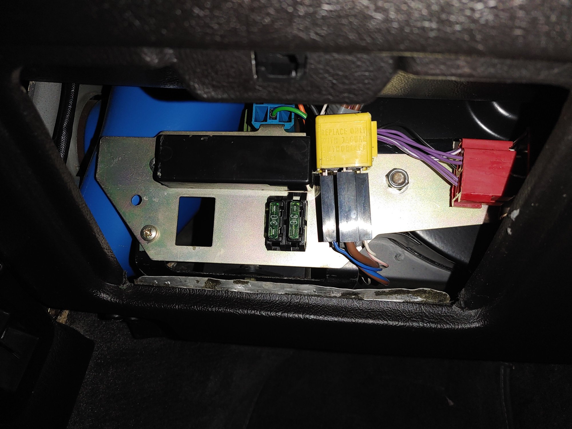

I was replacing the ski slope and figured I might as well clean the window switches while I had access. After cleaning both window switches, the windows are no longer working (formally both were working). I dug around the forum and it sounds like it's either the window circuit breaker or the window relay.
I open the fusebox under the passenger side glovebox and took this picture. Can some one let me know which item is the circuit breaker (yellow cube?) and which one is the relay?
Thanks in advance.

The circuit breaker will look like this. Probably found a bit further to the right.
The relay will probably be round. It'll have brown/blue, white/pink, and black wires

Thank you very much Doug! I was not able to find the circuit breaker or relay through the fuse box so it looks like I am going to have to drop the compartment for better access.
