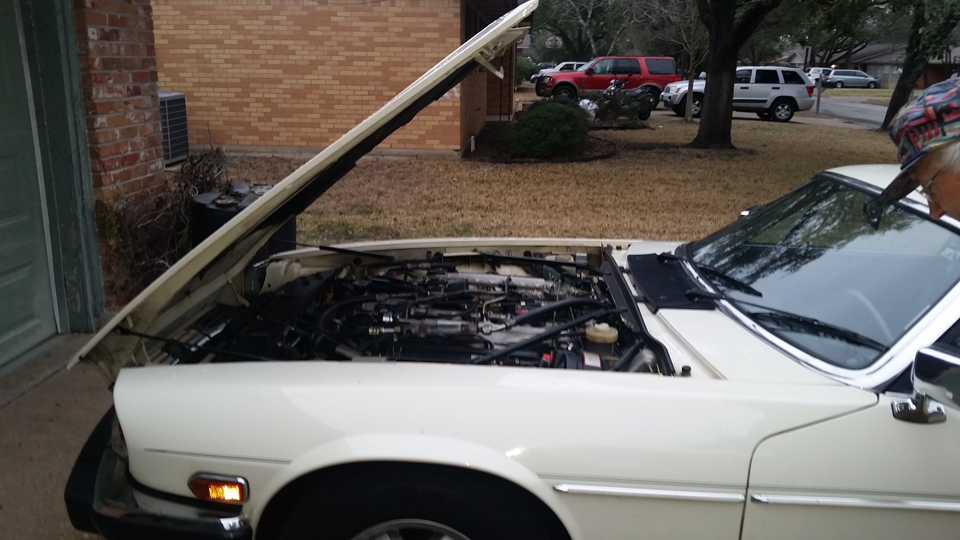

So, I'm posting a pix of my xjs bonnet in the open position asking if this looks like the correct distance it should open. Personally, I hate the fact that I can't get to the forward components with so little room, ie., I wish the bonnet would open further. I looked at whether my bonnet pistons are the proper length but it appears that the piston part numbers are correct for this car. I do realize that much of the front end work can be done from underneath but I am sorely tempted to unhook the pistons and see how much farther I can open the bonnet before it hits something that it shouldn't and then make some sort of custom bonnet stick that would hold it in place if the wind starts blowing either way. Anyone on here have any experience with this? ..................Mike.

I've twice failed to get my bonnet pix on here, so here goes one more time. ......thanks to all for what you've shared so far. I have some good ideas now. ......Mike
That looks about normal, and even a tad more open than most.
