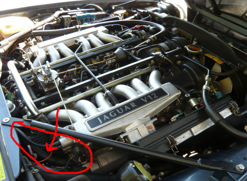

Hey everyone, one final question. I'm going to purchase the fan today, part number EBC4553, from SNG. I also am in need of a coolant hose that has a pinhole, but looking through the catalog I can't find it pictured. It's on the back RH side of the motor. I pulled down a picture form wikipedia and marked it, as the picture I took doesn't show the location that well.
The actual hose, you can see the coolant spraying out of it toward the bottom of the hose. It's the hose in the center of the picture.

Any help identifying what part number this is would be appreciated, I'd like to be able to order this pretty soon as well. I don't like to drive my cat with issues like this!
Thanks!

That is the heater hose that takes hot water from the engine to the heater valve on the firewall. It is the part numbered 22 on this diagram
Part no. C41051 | Heater water valve parts from Jaguar Classic Parts UK
But honestly, the best thing to do is to buy a hose kit complete and do the lot.
Greg

Thanks for the info, Greg. That was able to help me track down the part number of the hose that I need, C43999.
For reference for future readers, SNG's part number for the hose kit is HK029. It includes that hose that I need, and is $95 as of this posting.
