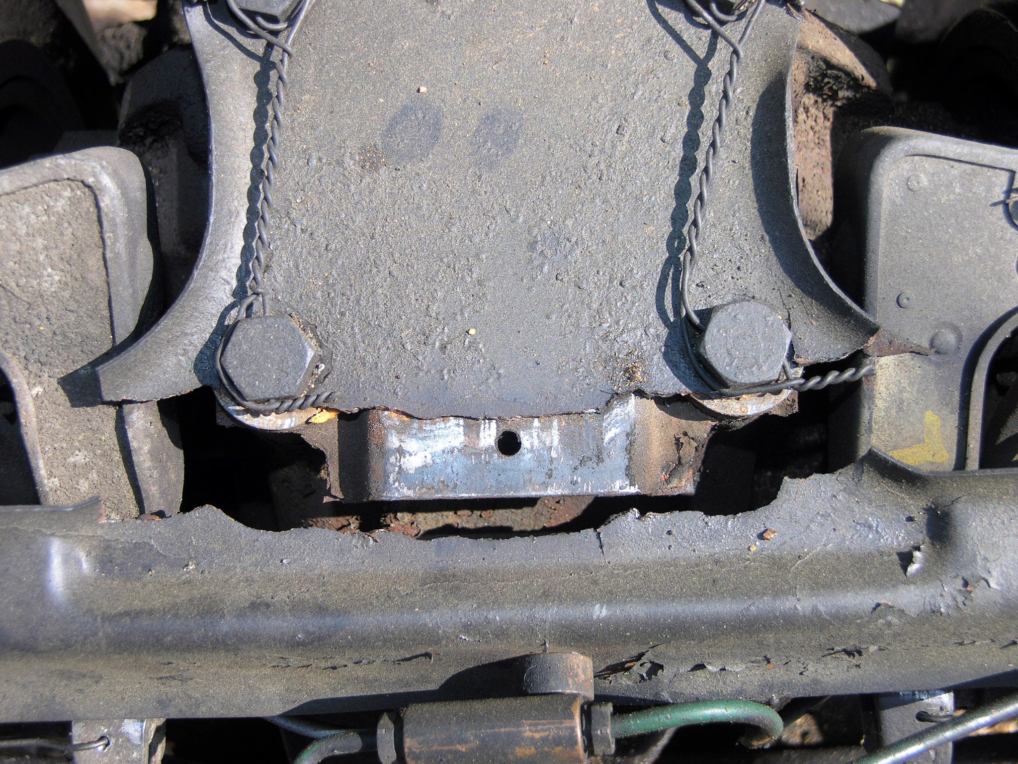

My '88 originally had a Dana with the three bolt pattern...or perhaps it was the '84 that had the Dana. I can't remember, but, I'll look at the '88 rear end on my garage floor when I get home today, and report back. One was Dana, the other Salisbury.
Last year, I replaced the '88 rear unit with the one from my '84, after one of the fulcrum bolts sheared off, and caused the cage to twist so much that it actually tore the cage metal in several locations, and allowed the differential U joint to rotate upwards and make contact with the sheet metal of the shaft tunnel. I had already put a 3.54:1 unit in my '84, so the extra 2.88 unit was just sitting on the garage floor, ready to go into the 88.
Photos of the torn cage, looking from above.
89 XJS, collector, 5.3 V12. DANA rear or?-171954_428225257226908_734207221_o.jpg 89 XJS, collector, 5.3 V12. DANA rear or?-201212_428225470560220_355220014_o.jpg
You can see the deformation in the center top of the cage in this photo.
89 XJS, collector, 5.3 V12. DANA rear or?-52778_428253993890701_100360991_o.jpg
