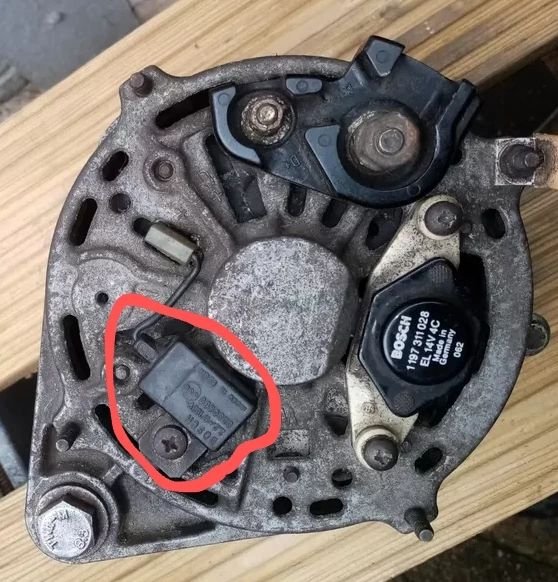

Had a guy in Manila with a 91 V12 with that, and eventually they removed the "load dump module" from the wiring at the rear of the alternator, all sweet. That was 12 or more years ago, and still OK last we spoke.
If its the 6cyl, dash earth is probably the cause, reeked havoc with the earlier cars, probably still lurking in your year model.

Is that the little black box screwed to the end plate?

I believe so.
The Manila guy was NOT car orientated, but claims he found it and removed it between bears, so had to be simple.

i disconnected this suppressor today and started the car and for the first time in months i heard the drive belt screech, also the voltmeter went straight up to 13.5 something it hasn't done for months. I'll take it for a run
next week to see, and if it does work, WHY????
so fingers crossed.
