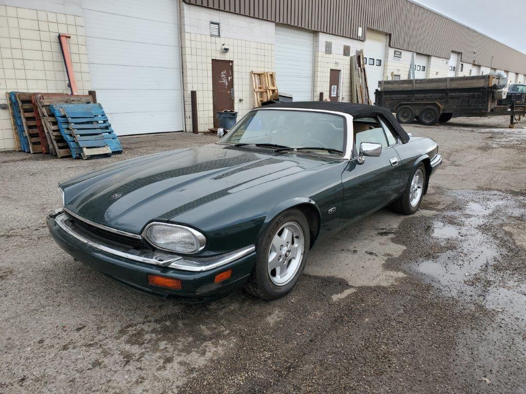

Hello Forum, I have a 1994 Jaguar XJS. It struggles often to get out of park into a gear due to the shift solenoid. Does anyone know where I can get this? I have struggled to find thus far.
This year I'm getting on the road at last after a few years.
Thanks
Karl
