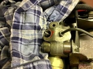

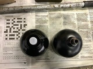

Old Jun 11, 2020 | 11:17 AM
Robbo D's Avatar
Joined: Nov 2014
Posts: 409
Likes: 356
From: Norfolk UK
Here you go
Old Jun 11, 2020 | 11:23 AM
wrightbenz's Avatar
Posts: 174
Likes: 21
From: chicago
Thanks Robbo D you saved me a lot of time and effort in this.
someone should sticky this as the old accumulators are becoming $$$ and hard to find.

Hi all.
just to let you know. With the new Bosch accumulator fitted it takes around 20 seconds to pressurise from empty when the ignition is turned on and I get around 7 brake applications before the pump cuts in and tops up the pressure in the accumulator. Hopes this helps with any decision making.
Rob.
