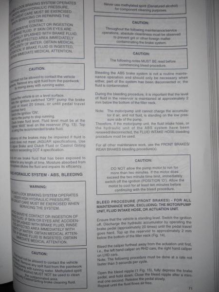

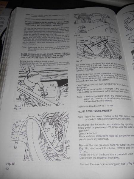

Here a couple of pics of the manual saves me typing it out
hope it helps

The Jag manual specifies for ABS to do the fronts first then the rears.

The manual does list the front first but it also states to bleed the caliper furthest away from the MC. I would start with the rears as per the pre-ABS instructions. There are other anomalies in the manual that are clearly incorrect. It's more of a guide than instructions. LOL

Not to open a can of worms or start an argument, but this is the experience I had.
Had my rear brakes R&R'd at a local shop by a mechanic who'd "been doing brakes for 30 years" He could not get the system bled to his or my satisfaction. He said he'd never come across a system like that before.After 6 tries at getting it bled I said screw it and took the car home
With my buddy we followed the book to the letter, farthest from the MC at the front first,(front right on left hand drive car) then the other front, then the rears with the ignition on, furthest first of course. Next I went for a test drive..... @30 mph the car stopped in 2 car lengths.
Just my 2c

Also if you allow the pump to continue to run you will damage it. The manual specifically warns not to let the pump run for more than 2min or the motor will overheat - if this happens the manual states to allow the motor to cool for at least 10min.
I have a full write up on how to bleed the ABS system here
Jaguar XJS Restoration : How to bleed Jaguar XJS teves ABS
Hope this helps. Feel free to ask any questions.
