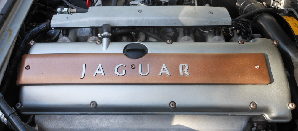

Not traditional colors but here's what I did.
Spray whatever color you want on the letters first and let it dry.
(no masking, just spray the entire area)
Spray the main color over the entire cover.
Let it set up a bit and then take a rag and some mineral spirits and carefully wipe off the letters.
Easy to do - No talent required!
