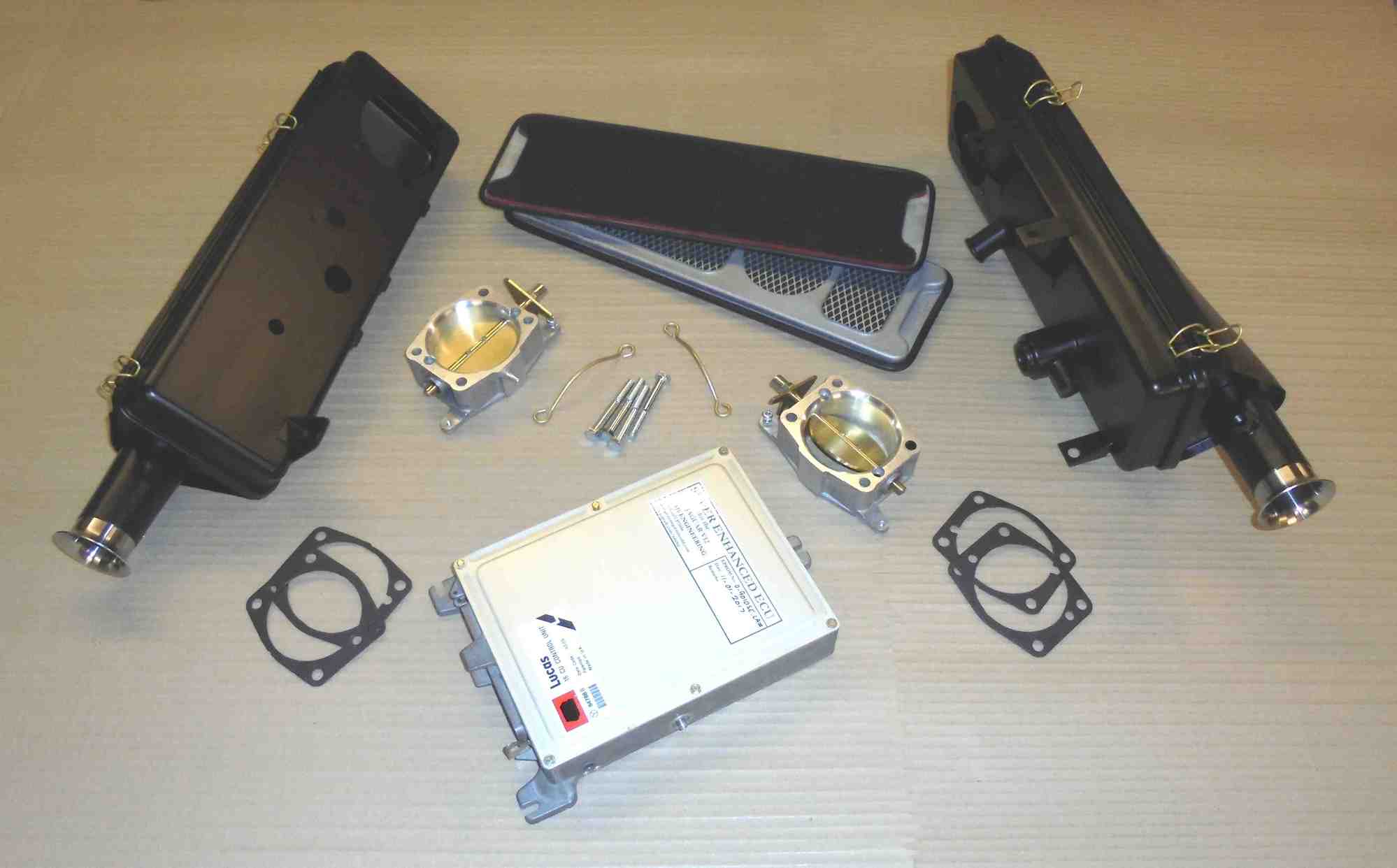

Hi All,
I have been in touch with AJ6 Engineering in the UK.
I am changing to a 3.54 diff as the long legs of the 2.88 are at the wrong end of where I enjoy my power. (I often run on the open road (110km/h) in second gear and fuel economy is not an issue for me)
I am about to push the go button on the SE ECU Large Throttle Kit, but have seen a couple of conflicting reviews that I would like to clear up.
My guess is that these reviews are few and far between and everything will probably be fine, but wanted to see how many of you are doing a similar thing with Rogers products.
He appears to know his stuff and seems to have been in this business for a long time.
Has anyone had experiences (good or bad)? I would love you to elaborate on any knowledge you may have.
Thanks all.
Craig

I've used two of his Superenhanced ECUs for the V12s and, plainly, they worked as advertised
DD

The AJ6 stuff with transform the car. You need the ECU and the larger throttle bodies. I have had it for 18 years now and it is just terrific. Bywater is the most knowledgeable person on the planet about the V12, you will not be disappointed.

Norman Lutz is building my engine and I asked him about the large TB's, his response was don't waste your money the stock ones are good for 500hp EACH and are NOT a restriction, larger plenums would be a better option. Then optimise ignition timing for 95 or 98RON fuel, the stock V12 (Lucas ignition) here in Aus is tuned for 91RON.

Finally the AJ6 large throttle kit is installed and in...
Wow... well worth the money!
The engine now starts with just the key when hot which is remarkable
Heaps better throttle response
Much smoother engine feel
The engine has completely woken up
Seems like its added 50hp but probably not unless my ECU was tuned rubbish from factory.
It is clear that Roger is very knowledgeable and knows his stuff, albeit a little slow!
It did take four months!

Unfortunately yes I had to send my bits t him and yes I had no car... But it is actually worth it!
Yes I had installed the 3.54 which gave a bit more pep, but I struggled a bit with the higher revs at top end. (Not super bad, but just a little bit annoying for me - 2900 rpm at 70mph was a touch too much)
A 3.31 would be better if you were happy to change speedo gears.
So last weekend I switched back to a 3.058 from a SIII XJ sedan and along with my 235-70 rear tyres, which is almost a perfect match back to the original 2.88 ratio. (2% out on speedo - or 2 miles out per 100 miles driving)
I am happy again now and I will use my 3.54 locker on the LSA project, seeings as the 6 speed auto has 2 x overdrive gears.
To be honest, the AJ6 kit changes it enough to not worry so much about the diff swap, but that's only my opinion i guess!
