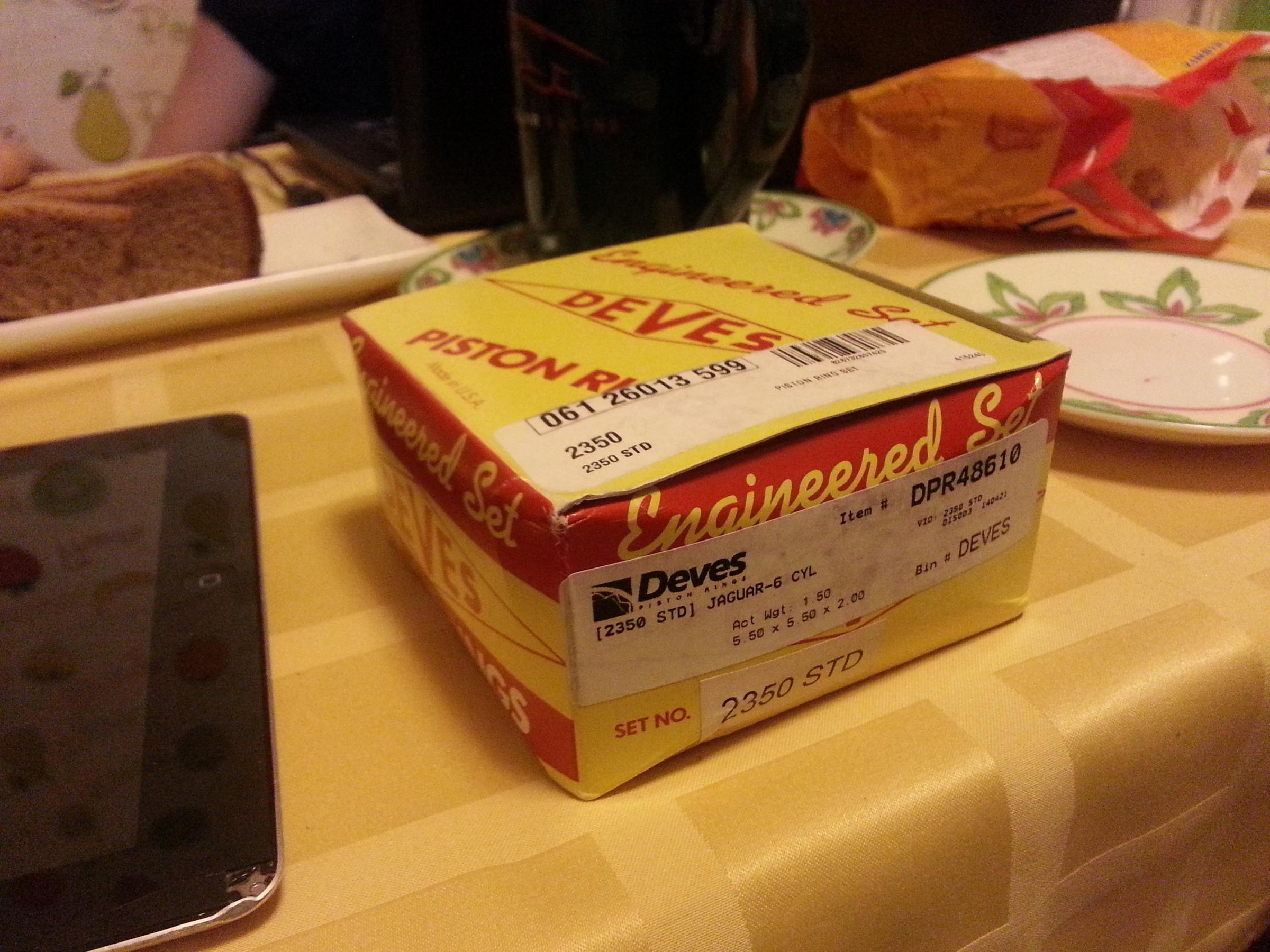

rings

Deves rings is not the best choice.
