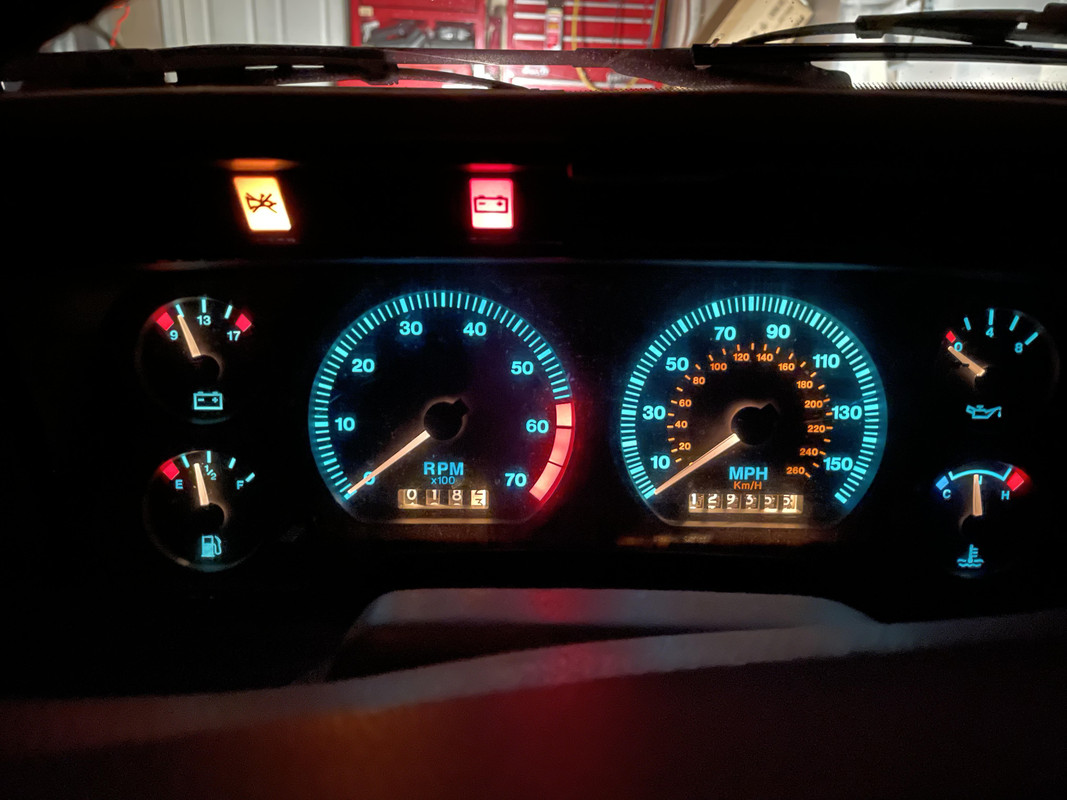

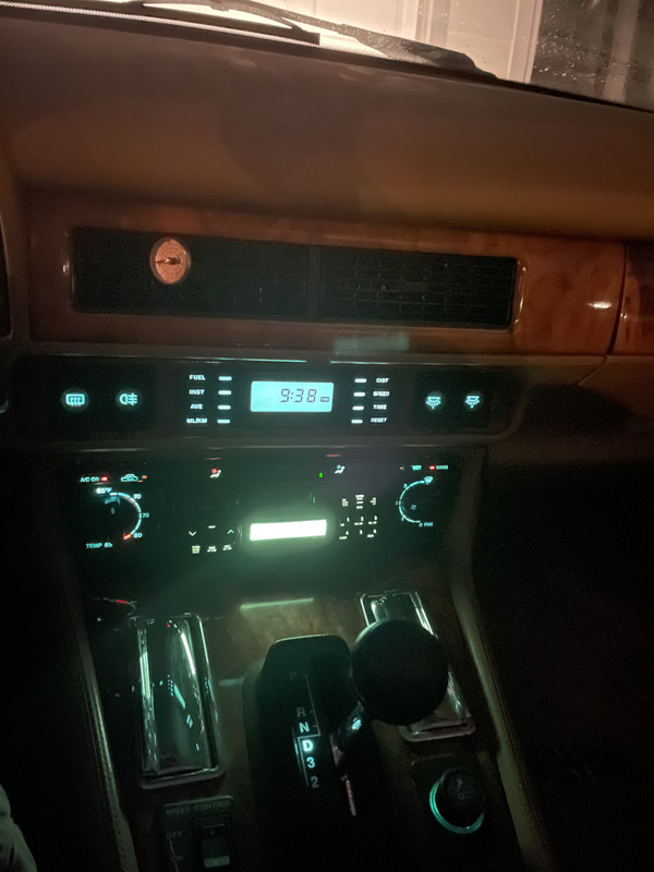

Thought you guys might like this, I found every bulb part number on this forum, some took some real work to replace. Anyway, this is what a completely replaced dash looks like. (I don't do LED's on older cars BTW.)

Picture of the instrument binnacle please.
I am still on the fence whether to LED or not to simply because I don't want the hassle of replacing going forward but I know the wavelengths aren't the same and colours tend to look quite different - the warning lighrs in the binnacle are a classic example since they themselves are coloured and using the wrong LED behind them will not be a good thing. I watched a vid where somebody demonstrated the problem - I'll see if I can find it - this problem also impacts rear / marker and indicator lights which have coloured lenses.
I take it this was with the dimmer at max.

I have replaced the trio computer bulbs to LEDs. I got the screen to match up to the original color, but I couldn’t do the same with the buttons, so I went with blue.
The amount of heat the OEM incandescents gave off would help me believe that it would limit the lifespan of that unit. That screen would get ¡muy caliente!
I also replaced my red handbrake bulb with a very bright LED. There aren’t LED bulbs that will fit easily, so I Dremel’ed one up and got it to work. I did not want to do that to the others. A lot of work, and high risk of damage.

Here is the binnacle as requested, I was out of town this weekend. I can turn some more lights on as well. One of the things that really helped was getting all of the dust out these bulb sockets and fascias. (It is turned up all the way.)
