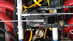

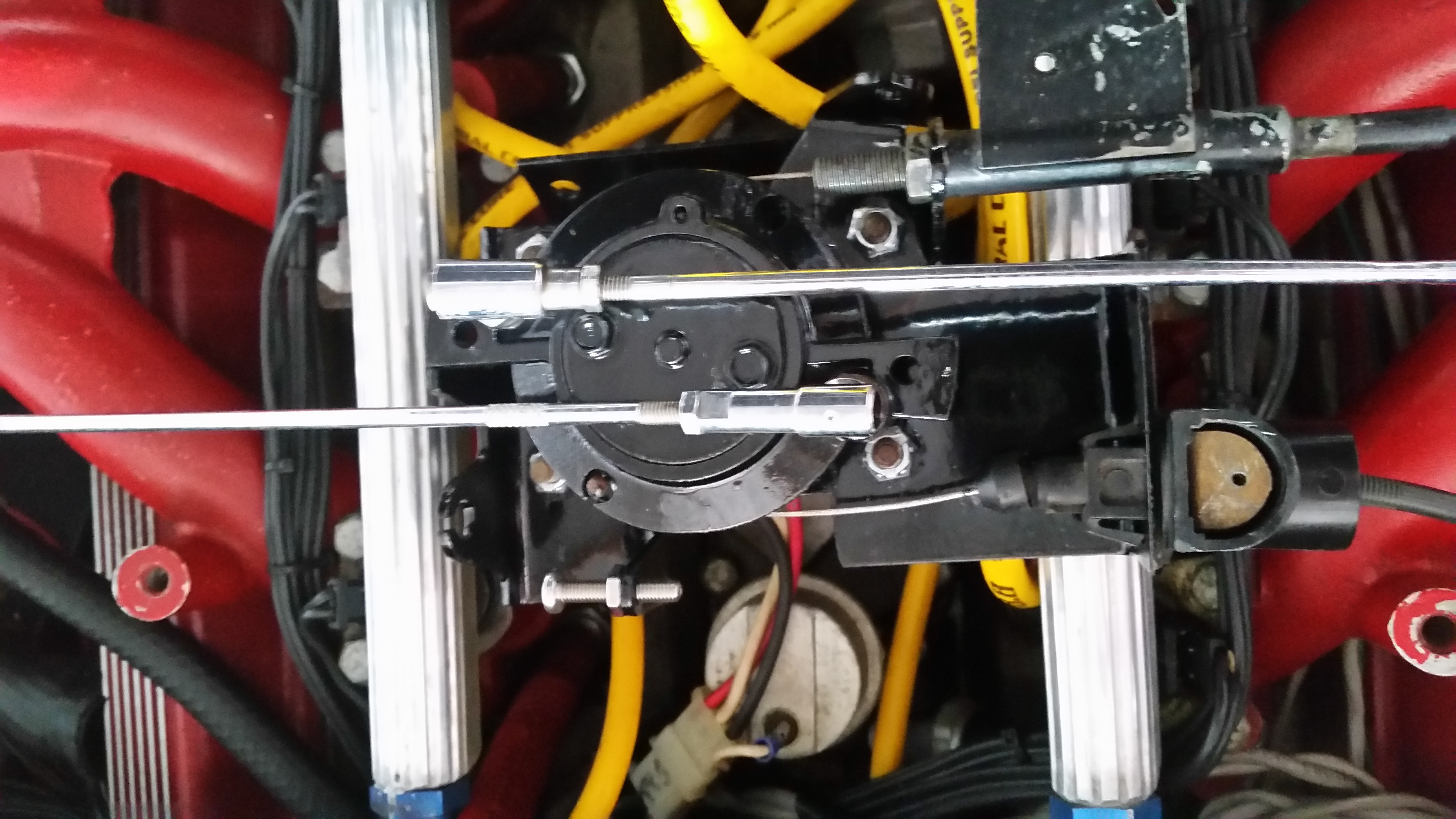

my throttle cable is 40yrs old ,checked it last week ,still good as new!
Attached Thumbnails Anybody had their throttle cable refurbished?-20170911_150349.jpg   Anybody had their throttle cable refurbished?-20171003_103655.jpg

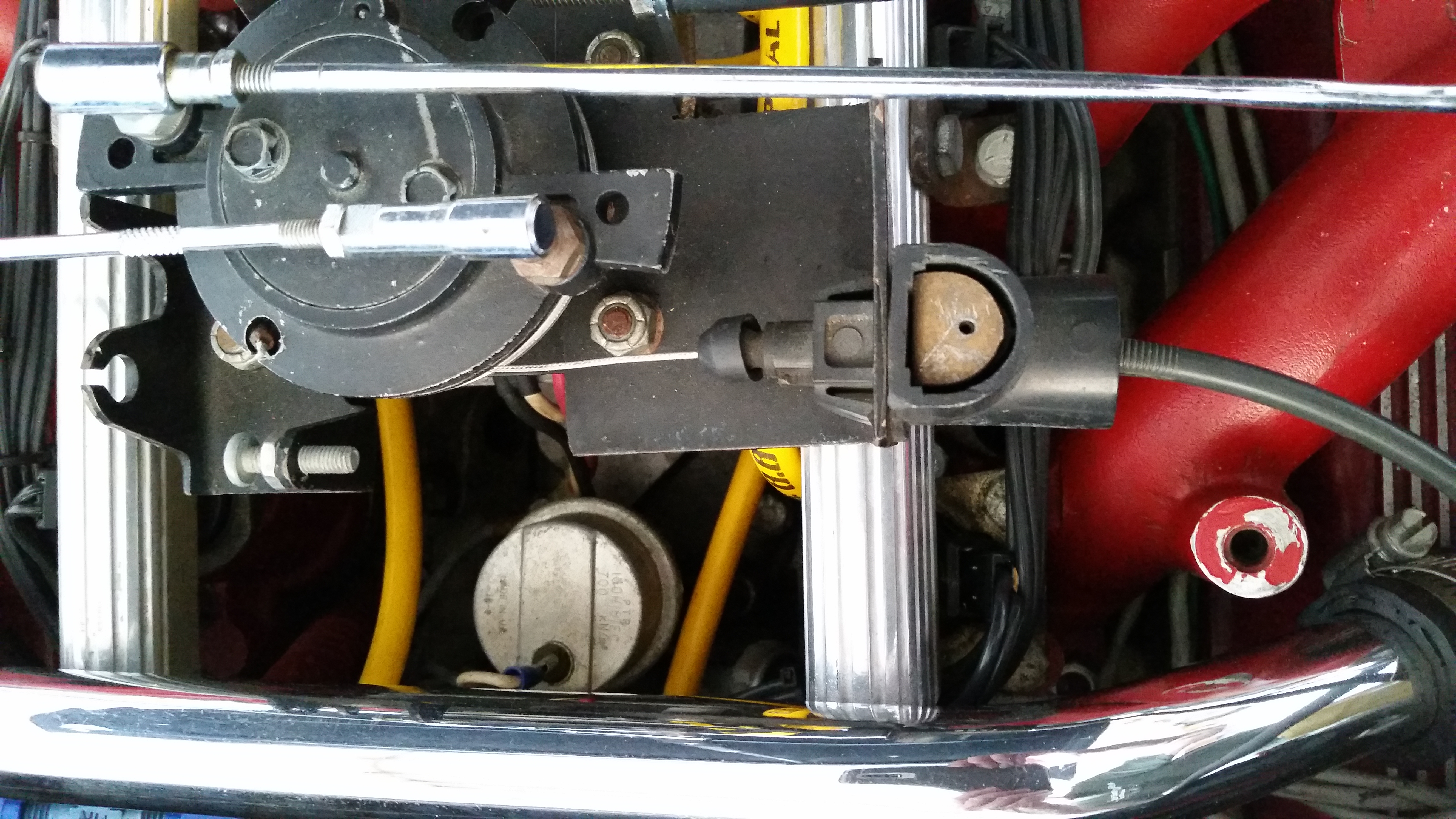

cable pix , TPS pic.
my kickdown is hydraulic, and it varies the internal pressure for shift speeds from the TV cable ,700R4.
Attached Thumbnails Anybody had their throttle cable refurbished?-20171003_114916.jpg   Anybody had their throttle cable refurbished?-20171003_103655.jpg

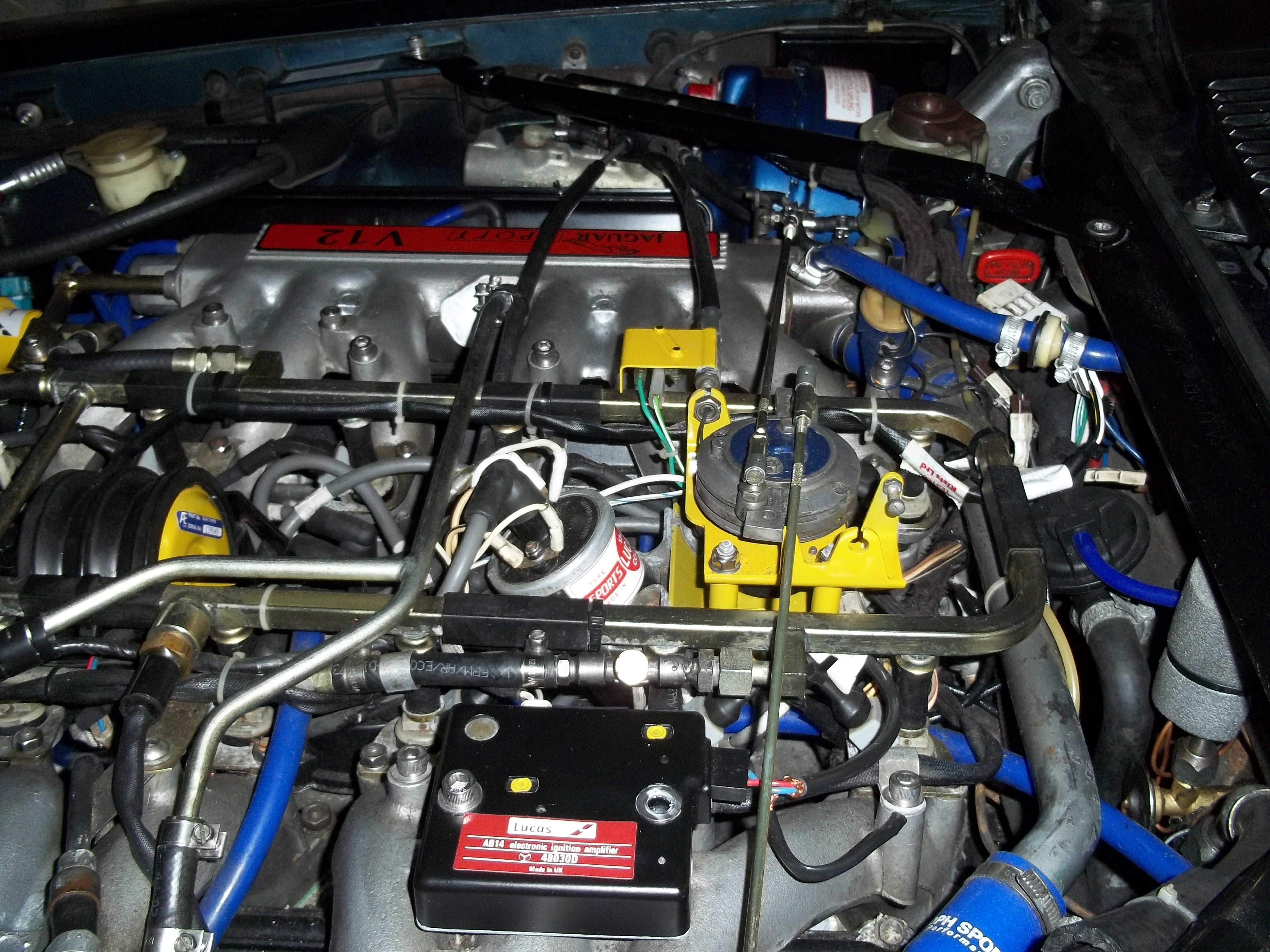

speedy cables said the would refurb my cruise cable for me but in the end I got a good 2nd hand one, worth a try though, mines diff to yours kickdown wise what's the cable nearest the fire wall? I haven't got that setup.

rgp, that is the TV cable(throttle valve), it goes to the transmission, it varies internal pressure for shift speed and how hard/soft shift gears takes place, also kickdown!
it is the way GM makes there newer trans.700/4L60 etc, the older(400) ones used engine vacuum to accomplish shift speeds. kickdown was a seperate cable.
