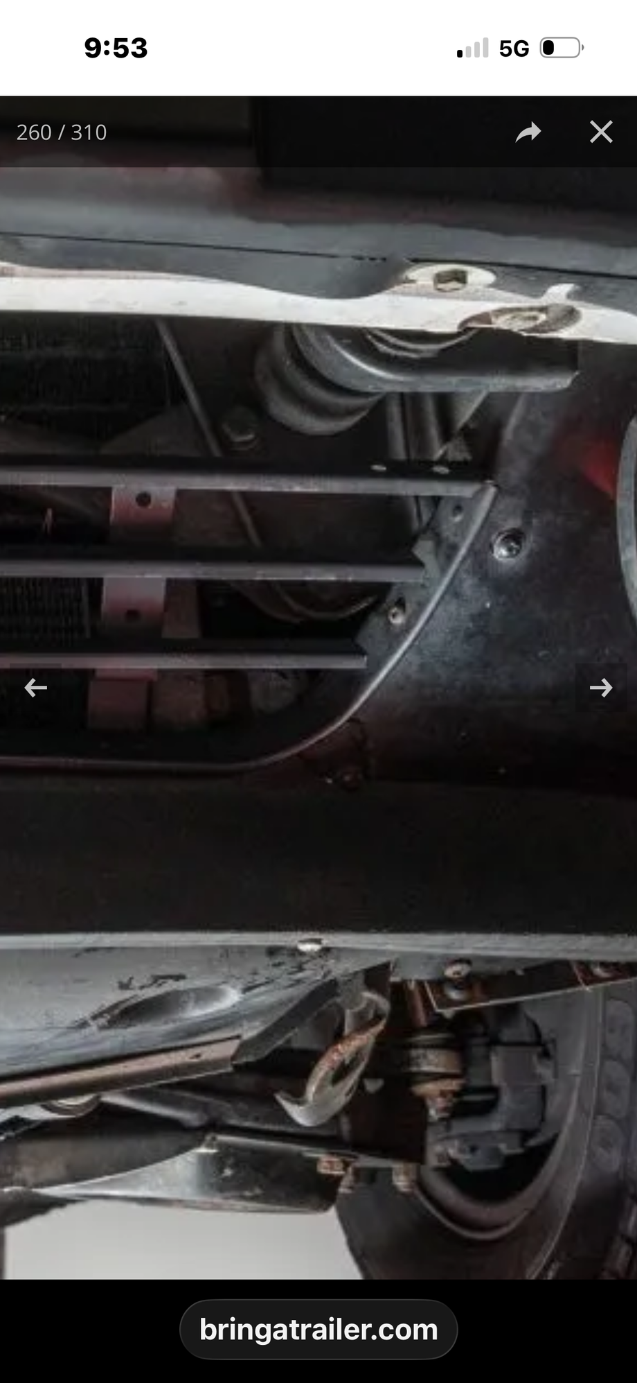

Seem to be listed as DAB80810C
i cant seem to find a pic of what they look like.
replacing my (missing) lower grill but I dont have the screws. There is one on each side. Want to try and keep it looking original.

I found pics on BaT.
cant tell if they are stainless/zinc or black though.

Those Phillips head screws are NOT stainless. I believe they were originally black oxide, based on the ones I threw out. If you are looking for Concours originality.
I went with stainless oval heads and stainless trim washers because the holes in the grill were kind of hogged out and round head screws just weren't going to guarantee security. I had the lower grill semi-gloss black powder coated as it looked bad, whoever resprayed the car just painted it body color over road crap. You can buy black stainless screws, but it wasn't worth the shipping costs to me

Note, the OEM screws are Pozidrive, not Philips.
