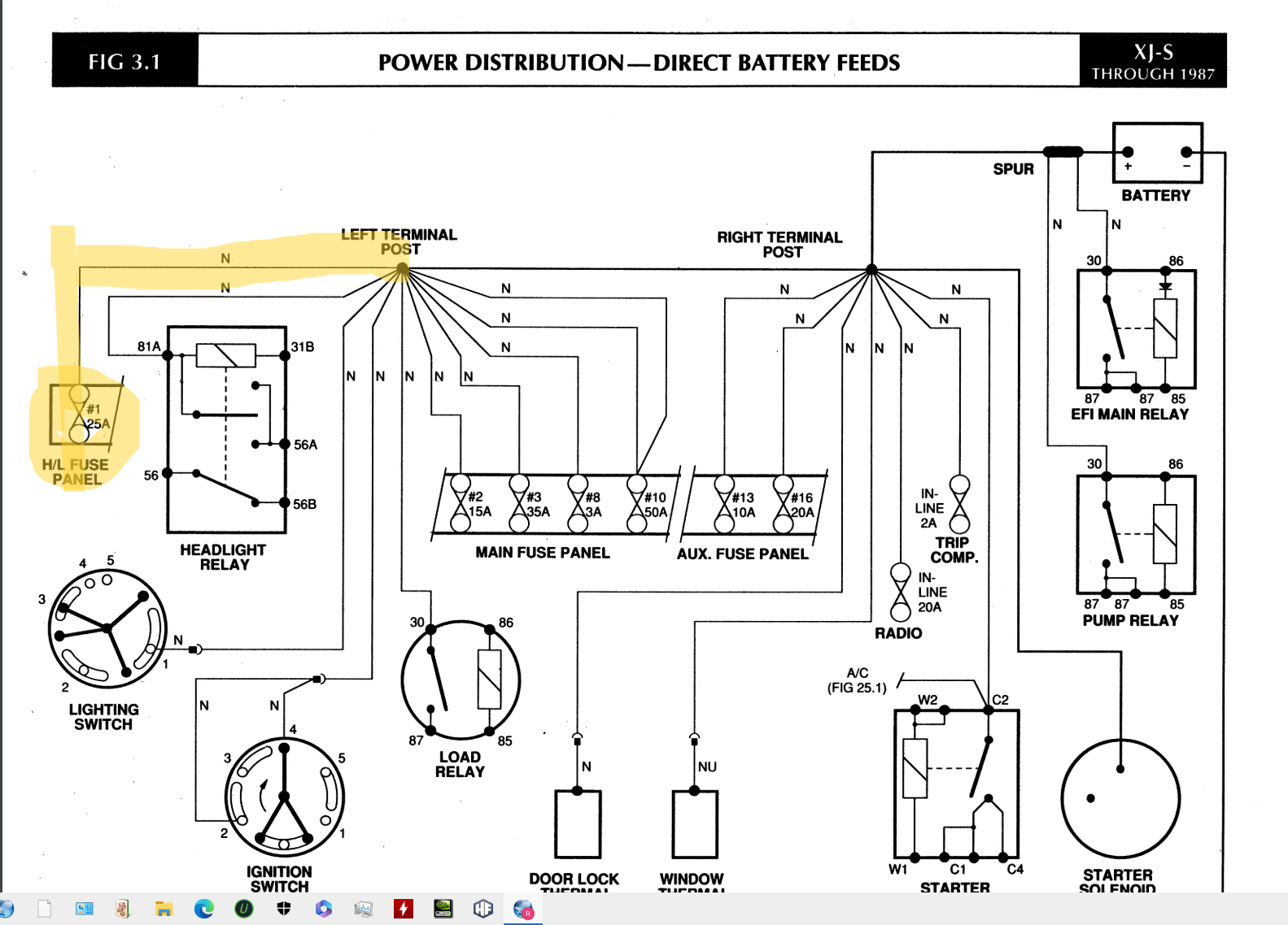

My diagrams show that brown 12v wire going directly to the "+" junction block on the firewall

Looks like from the above diagram provided by Doug that you should verify that you have battery voltage at pin 81A of the headlight relay; use a test light rather than a volt meter because a high resistance in that circuit will still show voltage with a multimeter but not light a test light. If ok, then trace the circuit from 31B, which goes to the column switch.
This of course is if the headlamp relay doesn’t click when the column switch is actuated (I didn’t see where you replied about this, may have missed it). If it does click, trace wires from 56A and 56B to the black fuse block.

I might've narrowed things down (or rather confirmed our suspicions about a short). I cut the solid brown wire running to the #1 engine bay fuse (Aux fan) and put a 15A blade fuse in the line in order to totally remove any doubts about the reliability of the glass fuse and associated copper prongs. That didn't change anything, but then I ran a wire (with another 15A inline fuse) to the left terminal. I removed the fuse in the new #1 fuse connection so that both female connectors were exposed. I then touched the left terminal wire to one female connector at a time (one leading to the relays, and one coming from the left terminal). When I touched the wire to the connector going to the relays, nothing happened (without the horn button pressed, fyi). However, when I touched the hot wire to the side of the fuse coming from the battery, I got sparks. I'm obviously not skilled in electronics, but I assume this means the short is located in the solid brown wire somewhere between the #1 engine bay fuse and the left terminal. I see no tears or frays in the loom running from the fuse to the firewall, so I think the short is somewhere under the dash.
It is tempting to just run a wire from the left terminal directly to the #1 fuse (while obviously eliminating the existing "feed" side which has the short), but since I simultaneously have an issue with the headlights and the #6 fuse blowing, I need to fix this the right way.
