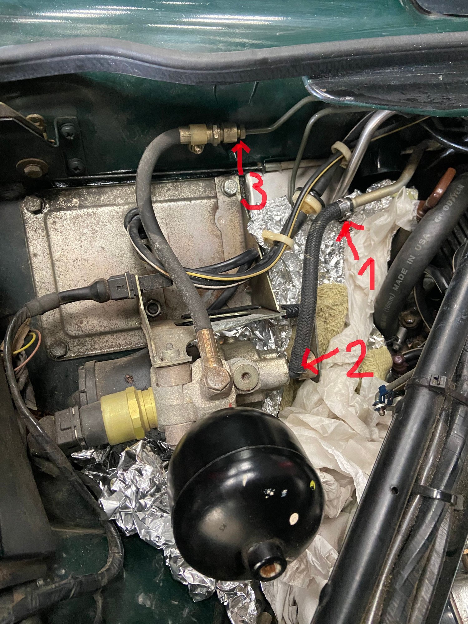

Old Oct 13, 2020 | 04:47 AM
gtv2c's Avatar
Joined: Oct 2020
Posts: 18
From: AIX EN PROVENCE
Originally Posted by ptjs1
gtv2c,
I think there's a max mark on the reservoir, but a couple of mill below the neck would be fine.
Don't turn the ignition on when you're bleeding the Low Pressure side. Just disconnect the clip and pipe, carefully ensure that fluid is consistently flowing without air and then carefully re-attach the pipe.
Good luck
Paul
Thank you paul for the quick response. Should i press the brake pedal to get the flow? or use the pressurisation of the reservoir?
1 : Low pressure entry hose clamped side
2 : Low pressure hose with tight pin clamped
3 : Hight pressure to ABS ?
4, 5 : connectors
is there a valve in between?
6 : Hight pressure fitting on ABS
what i've done so far is following procedure :
Connect 10psi to reservoir cap. Open fitting referred number two ( pin clamped one on accumulator side). let sputter and run for probably 30 sec without sputter or bubble.
then i put it back in with the pin.
Get the pressurisation thru cap off.
Level up the reservoir and close the cap ( without the pressurisation system)
turn on ignition ( light abs and lock light on for 15 sec approx, pump of accumulator run for about same time) , once lights are off and pump off, then i have helper pressing brake pedal and hold it then i open rear passenger nipple ( right side ) ( car is US, left hand drive) let it run for 15 seconds. Turn off nipple.
Then turn off ignition and then release gently the brake pedal.
i wait a minute approx and turn ignition on, wait for light and pump to turn off, then press pedal , then open nipple for 15 seconds ( it does get some liquid out but no air), turn it off, turn off ignition and release pedal.
i figure to do that process twice per caliper would help..?? ( now im doubting everything )
WAit for a minute.
Then i do same process to rear driver side caliper ( left side) with topping up reservoir.
After doing that i move to front side of the car, after waiting few minutes.
I start with right caliper ( passenger), turn on ignition, let light and pump pressurized the system and turn off. Press pedal one time tilll its hard. open nipple. Let it bleed for 2 sec, i dont see any air, only liquid.
I redo that process for a second time on that caliper and then i redo same process on driver side caliper.
Is there anything i missed?
DO i need to bleed high pressure side of system , connectors 3 4 5 in pictures??
thanks a lot to everyone who can contribute
