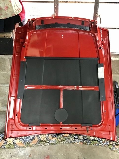

I’m thinking of glueing my bonet liner to some form of backing board to try and beef it up and prevent it getting more fraught. I’ve considered aluminium sheet but it’s a bit pricey so was thinking about 3 mm hardboard or some sort of polymer sheet. I’d like to keep the original so not considering dynamat type options. Just a bit concerned about the heat under the bonet? Anyone else tackled this or have any ideas? Many thanks in advance

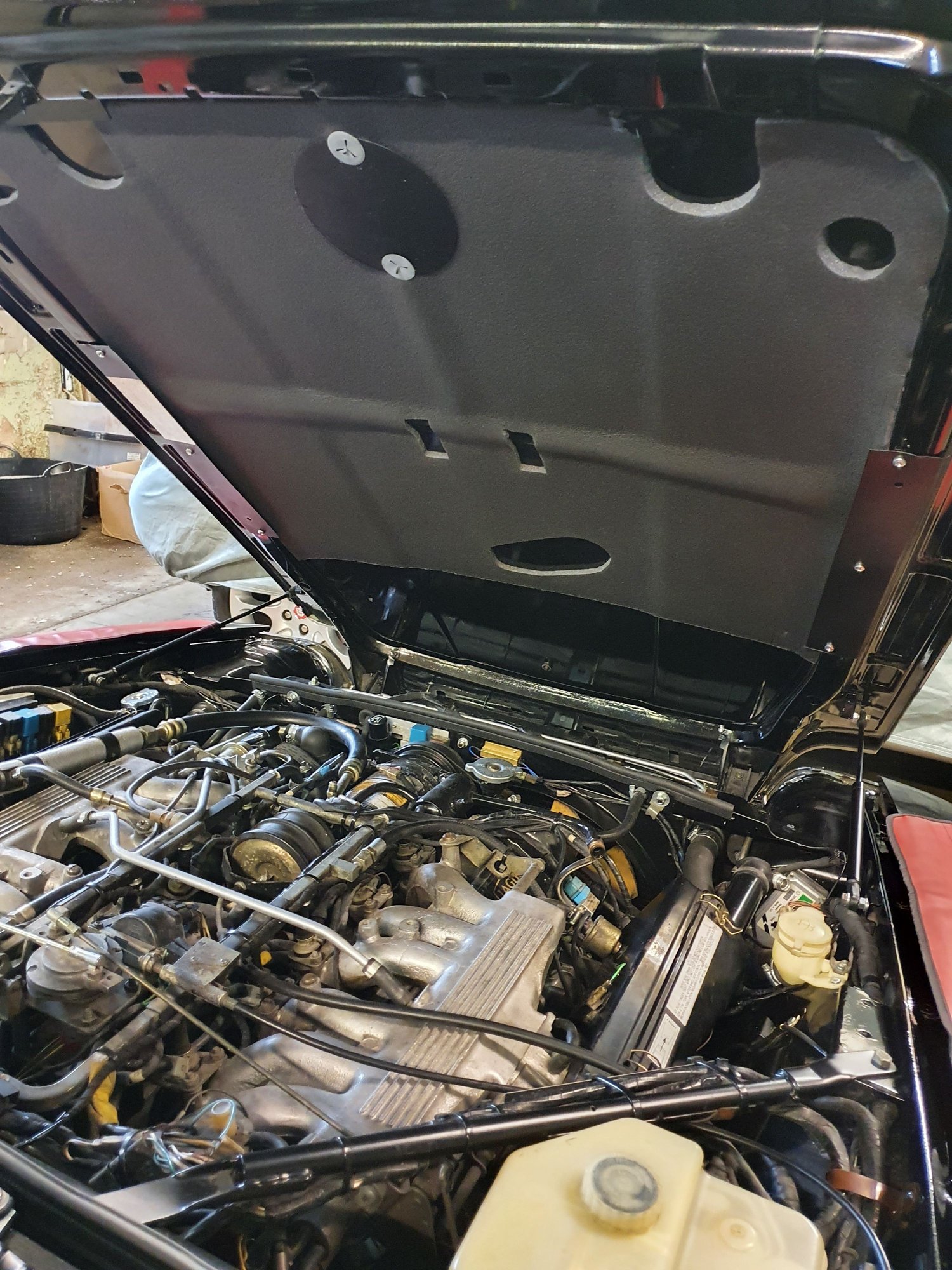

I renewed mine with self adhesive insulation foam.

That Looks nice and tidy. Ordered some stuff today .

I ended up buying some good quality foam from Germany. Used my old liner as a template. Sticks like s@#t to a blanket so you have to be carefull. Not cheap but I'm happy with the results.
