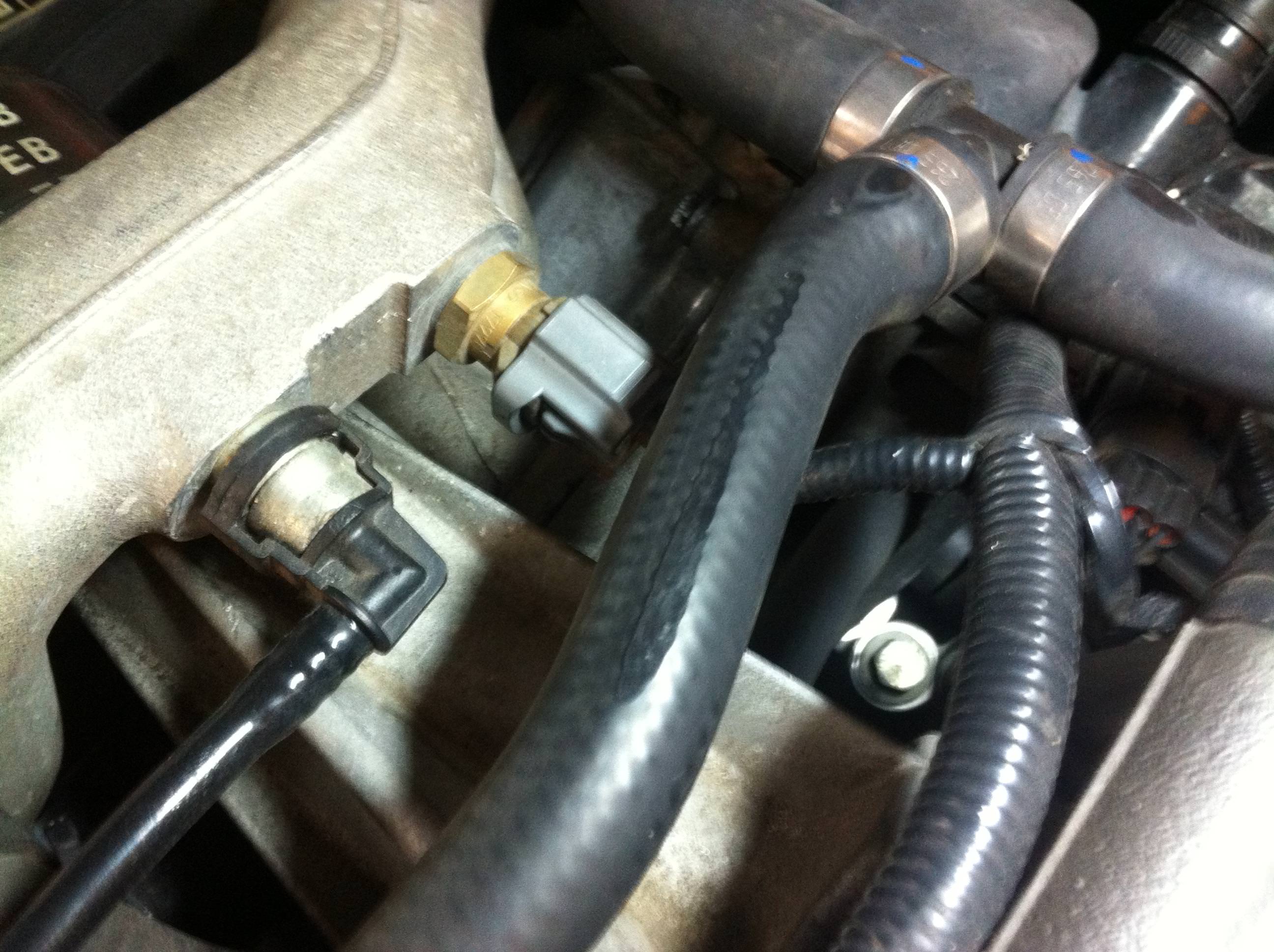

All hood liner screws in place, and no drooping in the areas of contact. I can push on the hood liner and there is no movement. So it appears to be as close up tight to the hood as possible.
Motor mounts show no signs of movement
The hood liner looks as though it has actually melted from the contact with the (hot) intercooler hose(s). There is one major point of contact on one hose / liner location and a couple of minor points of contact on another hose.
Here are some photos. The light areas of the hood liner are where it is making contact with the hoses. The last photo is of the hose showing the most contact and abrasion.

Thanks Z the pics are a big help.
This last pic makes me think the height of that hose is off due to the orientation of the coupler and rotation of the hose itself. That might have happened when previous owner did the tensioner work.
I would try to loosen that coupler and turn the outlet to point more horizontal instead of slightly up like it is now. Might get it down enough to clear the liner.
I found a pic that shows the hose routing that I think would be original. What do you think?
Thanks for responding.
thats a good suggestion. However, the hose is already resting on the wiring and temp sensor under it at the area of contact. I've tried pushing it down slightly in that spot, but there's nowhere for it to move to, so the height of the hose is as low as it can go regardless of the hose orientation. Too bad, as a little downward movement would take care of things nicely.
​​​​​​​ Nevertheless, I think I'll investigate a possible orientation change to see if it matters
in the photo you provided it looks like someone has put a plastic ring around the spot where the rubbing / abrasions occur. Interesting !

Rothwell, I took your suggestion and loosened the hose fitting and rotated the hose on the passenger side intercooler hose connection so the T fitting area is level or slightly pointing downward.
Unable to tell initially what difference it will make, so I wrapped three circles of one inch masking tape about 1/2" apart along the area of hose / hood liner contact. If the masking tape abraded, then I still have a problem. If it doesn't abrade, then it's fixed and it goes without saying that you are genius.
Z
From the looks of that hose it should not take long to see a result. Will be great if the solution is that simple.
You could probably get a rough measure of the gap by using a small piece of cardboard with double sided tape on top that will stick to the liner if it touches. If the liner does not pick it up then add another layer of cardboard till it does.

is that really hose abrasion or material transfer? it looks like the hood blanket is melting and building up on the hose itself.
Old Aug 18, 2018 | 05:21 PM
zray's Avatar
Joined: Jan 2018
Posts: 3,720
Likes: 2,318
the hose is definately abrading. It has a flat spot over 3 inches long.
It's hard to tell if the hood liner is actually melting . I've looked at pretty closely and under some basic magnification and in my view it's melted in places.. The thread I referenced also mentioned melting.
Z
flat spots on hoses are usually not abrasion, but melting. i do not know the XKR that well. does this hose get hot in its normal use. if so, the issue could be that the hood blanket is not allowing heat to escape from it, instead building up at a contact or close proximity point. perhaps simply removing a small section of hood blanket above this hose is all that is necessary, make a frame for the removed section. perhaps the XKR was a post design addition to the XK8 and little things were not tested as thoroughly during the mock ups. more heat is dispersed by this motor than the XK8, hence the reason for the hood vents.
Old Aug 18, 2018 | 06:22 PM
zray's Avatar
Joined: Jan 2018
Posts: 3,720
Likes: 2,318
All the fluid hoses going in and out of the intercooler get really hot, I don't have the exact numbers. The hose is definately abraded FLAT from the contact with the hood liner. No evidence of melted rubber hose on the liner or elsewhere. All of the posts on the thread referenced from 2010+ talk about their issues from hose abrasion too.
Many of them also fixed this issue by just cutting out the patch of the hood liner that was making contact. I'm not too enthusiastic about that. It may be extreme but I'd rather take off the liner than cut out a strip from the center of it. I'm keeping an eye on my test strips of masking tape. If they wear then I'll know my reorientation of the hose angle didn't do much.
Z
