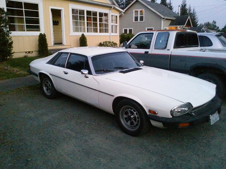

Hello! I recently bought a 1976 XJS V12 and I'm looking for advice on what I should do with it.
Pros:
Cons:
First thing I did when I got it home was removed the gas tank. Lots of rust, lots of holes. Beyond repair in my opinion. I changed the fluids and such and started it up using a gas can and.... it sounded great. And then the lower radiator hose blew and now I'm waiting for that to arrive before I can start it again.
It has a Crane electronic ignition installed, and an oooold fashioned built in radar detector. The interior is in pretty decent condition. The drivers seat has a tear, but that's about it.
I'm not sure what I want to do with it at this point. It has low low low miles, which I verified with the reciepts that were included, but it did sit. So I don't know if I should throw a fuel cell in there and simplify the thing by removing the emissions crap and AC stuff, or what.
I'm basically looking for advice for this car that I don't think I have the money to fix.

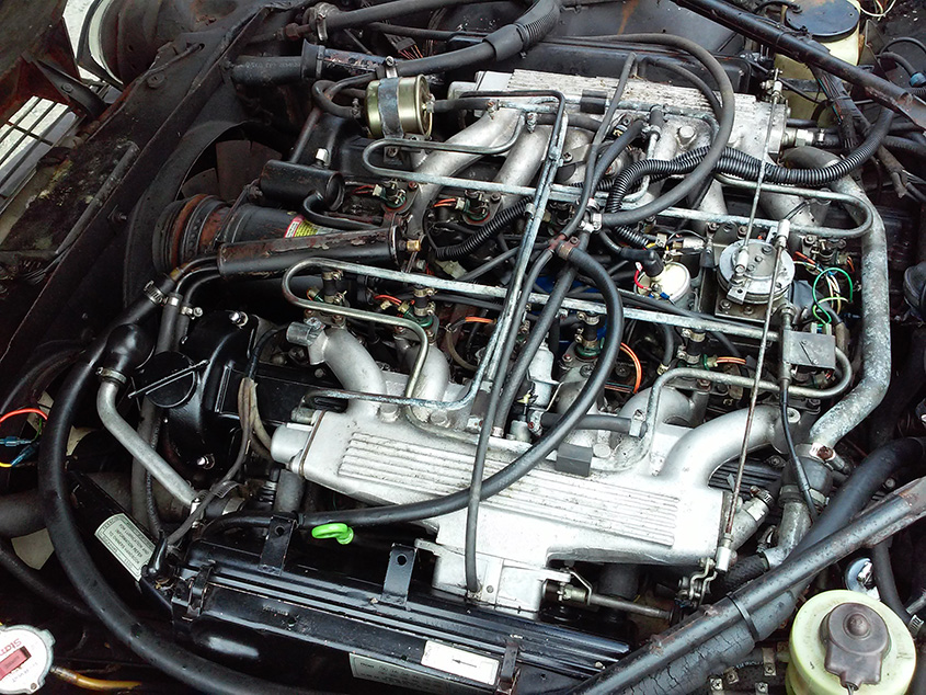

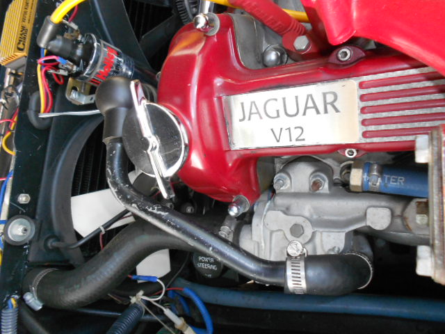

Also, bit of an update. Ran the car again but it seems to only be running on the left bank. The right side of the exhaust is all spitting and sputtering.
I'm going to try plugs, wires, cap n rotor, and replacing all the vacuum lines. The vacuum line going from the right bank to the distributor vacuum advance was cracked, so I'm wondering if that's why that side isn't firing. I pulled some plugs from that side and they looked fine.

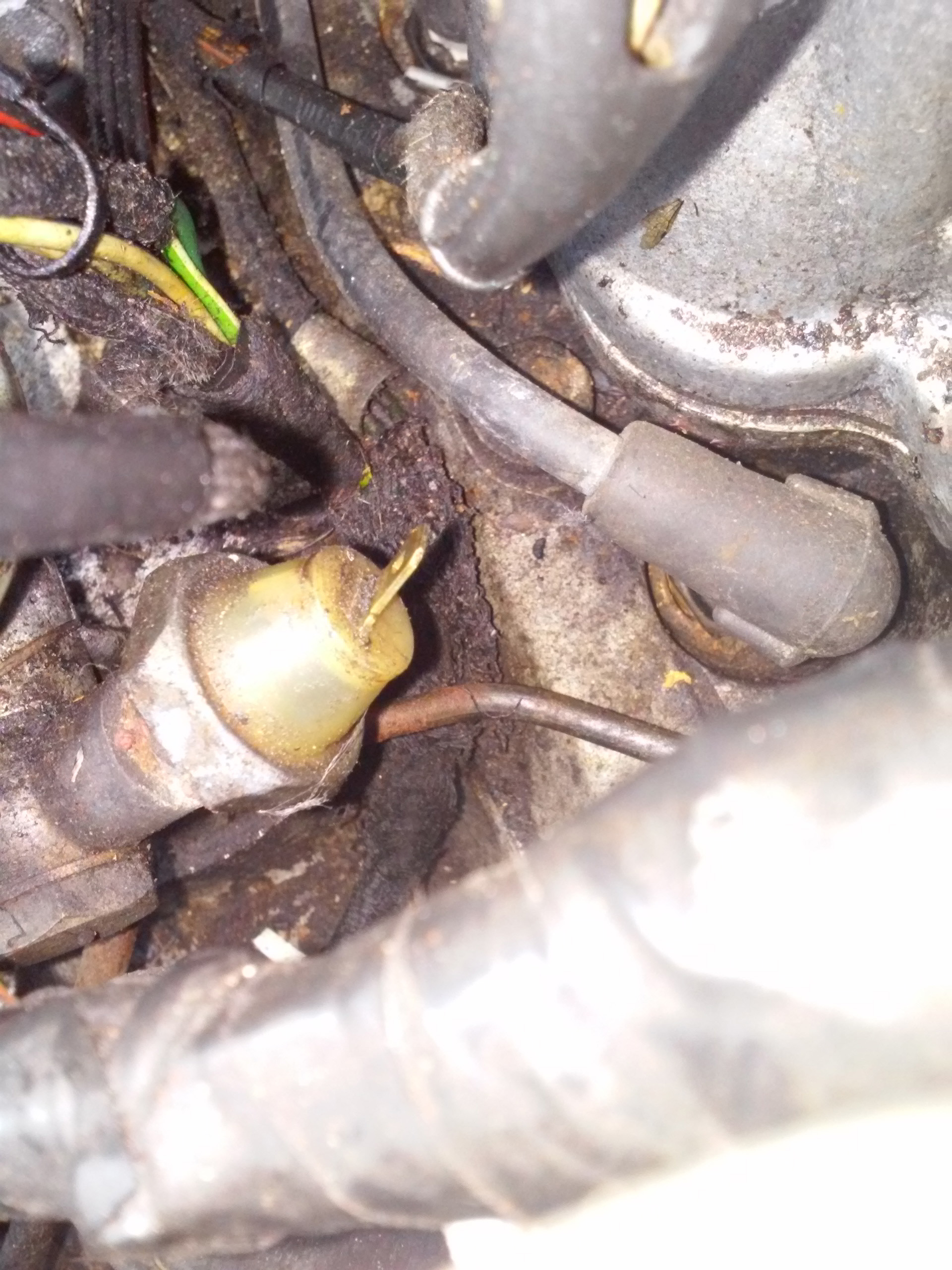

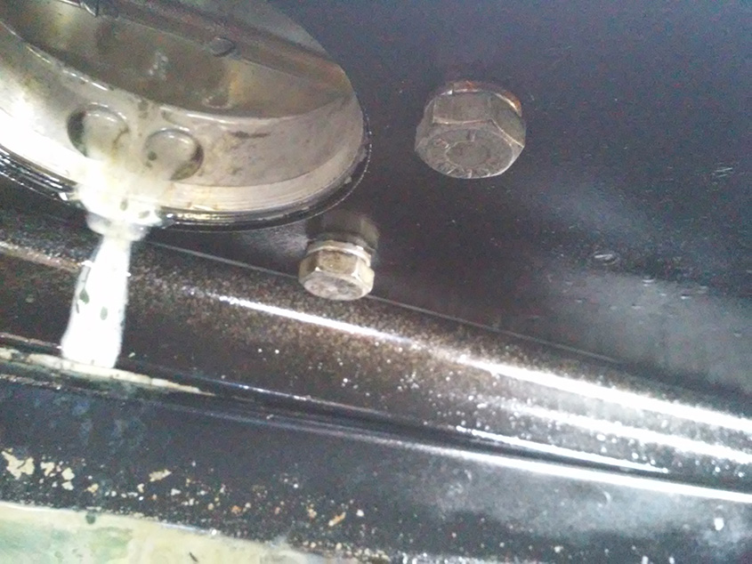

This certainly doesn't look good:
Oil and water I'd reckon. Didn't smell like gas.
And then there's this sensor (?) near the A6 plug; behind the throttle twirly-ma-boop.
Anybody know what it is?

Following on from ALL the above. All that has been said is 100% fact.
The early cars are rare, some markets like that, some do not. They have rust, from the factory, it was free, no extra charge for that item, and that is a bummer, but once repaired and sorted, are soooooo nice to own and drive.
The 6 cylinder V12 in the PreHE (yours) is as common as it comes. The trigger board INSIDE the distributor has 2 reed switches, and each switch fires one bank of injectors. They fail, and they did so when under warranty, cost Jaguar a mint. The Hall Effect was developed, and is a DIRECT replacement and is basically bullet proof. The 4th wire on the "new" trigger board is for a 12V feed. The original board was ony a 3 wire unit.
The rotor for the 3 wire is different to the 4 wire, so make sure you get a "Trigger Board Kit" which should include the board, rotor, plastic screws (4), rubber spacers (4).
Failing that fixing it, the next most common failure is the actual EFI loom itself. It is mounted waaaaay down in the bottom of the "V", and simple OLD AGE will now render it toast. Make your own, very simple, you work in the right place to get all you need.
In case you did not know, under the battery is another fuel tank, it will be equal in condition to the main sucker you have removed. The tanks on the Coupes are the same up to "about" 1990, so one should be able to be sourced without too much grief.

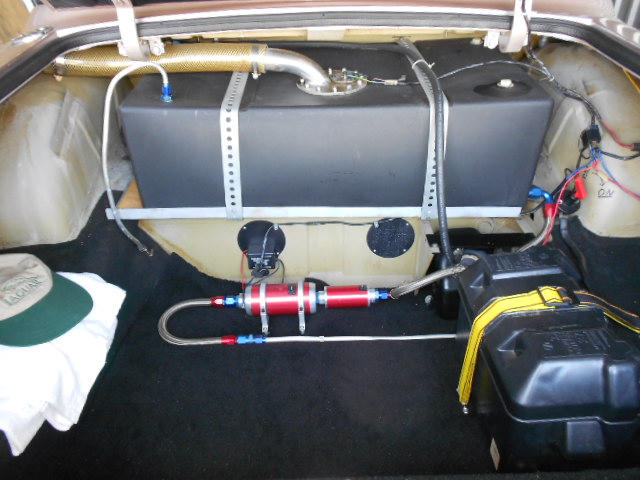

Also, for the fuel tank, I'm just going to go with a fuel cell.

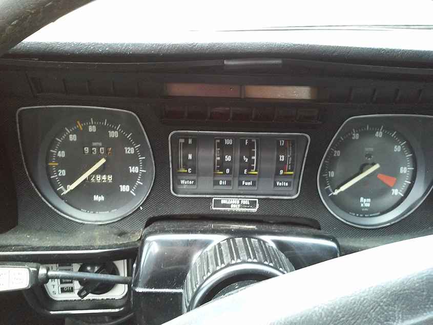

i odmeter says 12+++, or is it 112 thousand?
water and crap in the intake blown head gasket or $$$.?
fuel cell good idea, along with ALL the iron fuel lines, and any thing related to corrosion in the complete fuel system!
if the crane is an OPTICAL system YES it would need an optical pickup in distrbutor, very simple to install, just remove the old opus stuff! but use the dizzy opus rotor.
i have had the Crane XR700 box and optical since 1994, it is old technology, but mine still does what its supposed to do. runs great!
The Crank ignition requires its own optical sensor in place of the OEM Lucas pickup, and an optical shutter wheel for it to sense distributor rotation. This is independent of the trigger board that activates the fuel injectors. The crane system makes sparks, the trigger board makes fuel. You need both. I have seen the trigger board kit on Amazon, with rotor, mounts and shims, for about $175.
I believe the device in your picture is an oil pressure sensor or switch, not sure though. and I cannot identify the thing that is leaking, where on the car is that photo?
Your wiring for the injectors down in the V of the engine probably is rotten, with all the insulation flaking off. I fabricated a new injector harness using 16 gauge TXL rated insulated wire using injector connectors I got from NAPA. I got the wiring out of the V, tied it up on the fuel rails to reduce the amount of heat it is exposed to.
