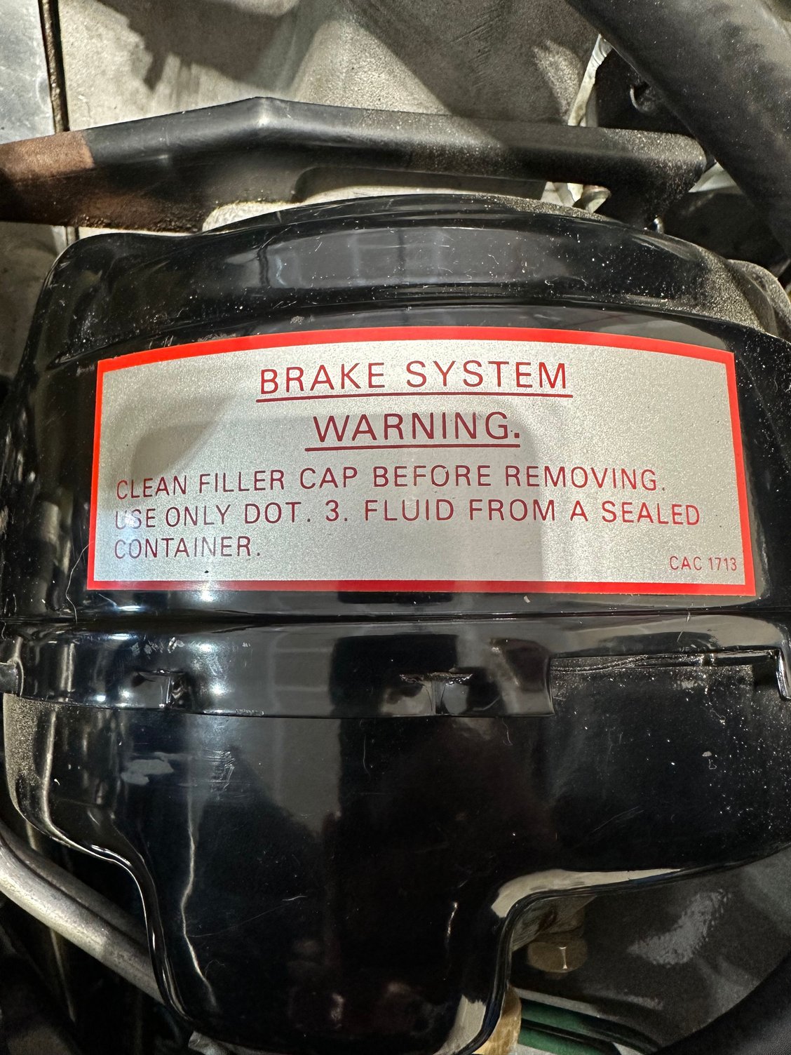

Ive always used DOT4 in my 86 but never noticed this sticker before.

I don't think they had DOT 4 back then. So DOT 3 was the best available.
The warning was so you didn't use DOT 2 or DOT 1, which were for things like farm tractors, in the 1940s, those would boil at disc brake temps.
Doug

I used DOT 4 to replace DOT 3 many times in older cars. Never had a problem, or even heard of any problems, doing so.
Many of the fluids sold nowadays say "DOT3/4" on the label. Presumably the formulation meets both standards.
DD
