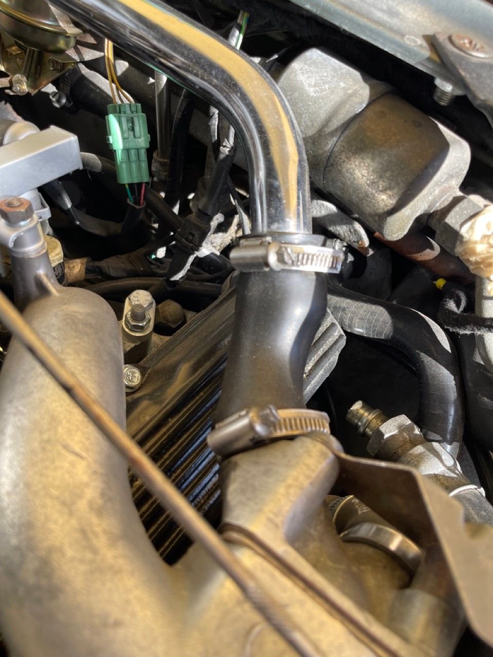

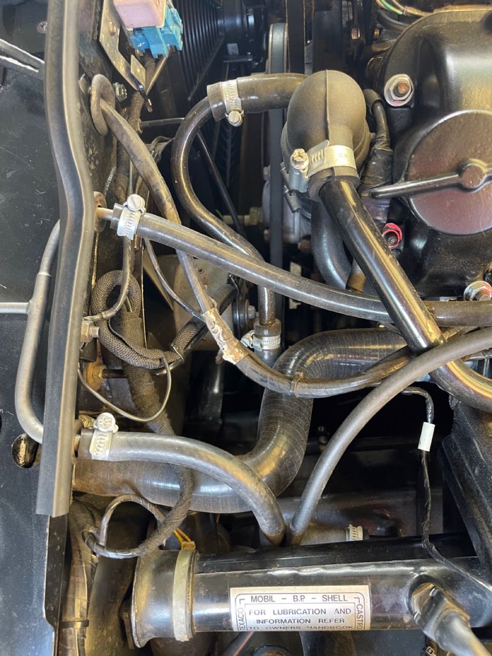

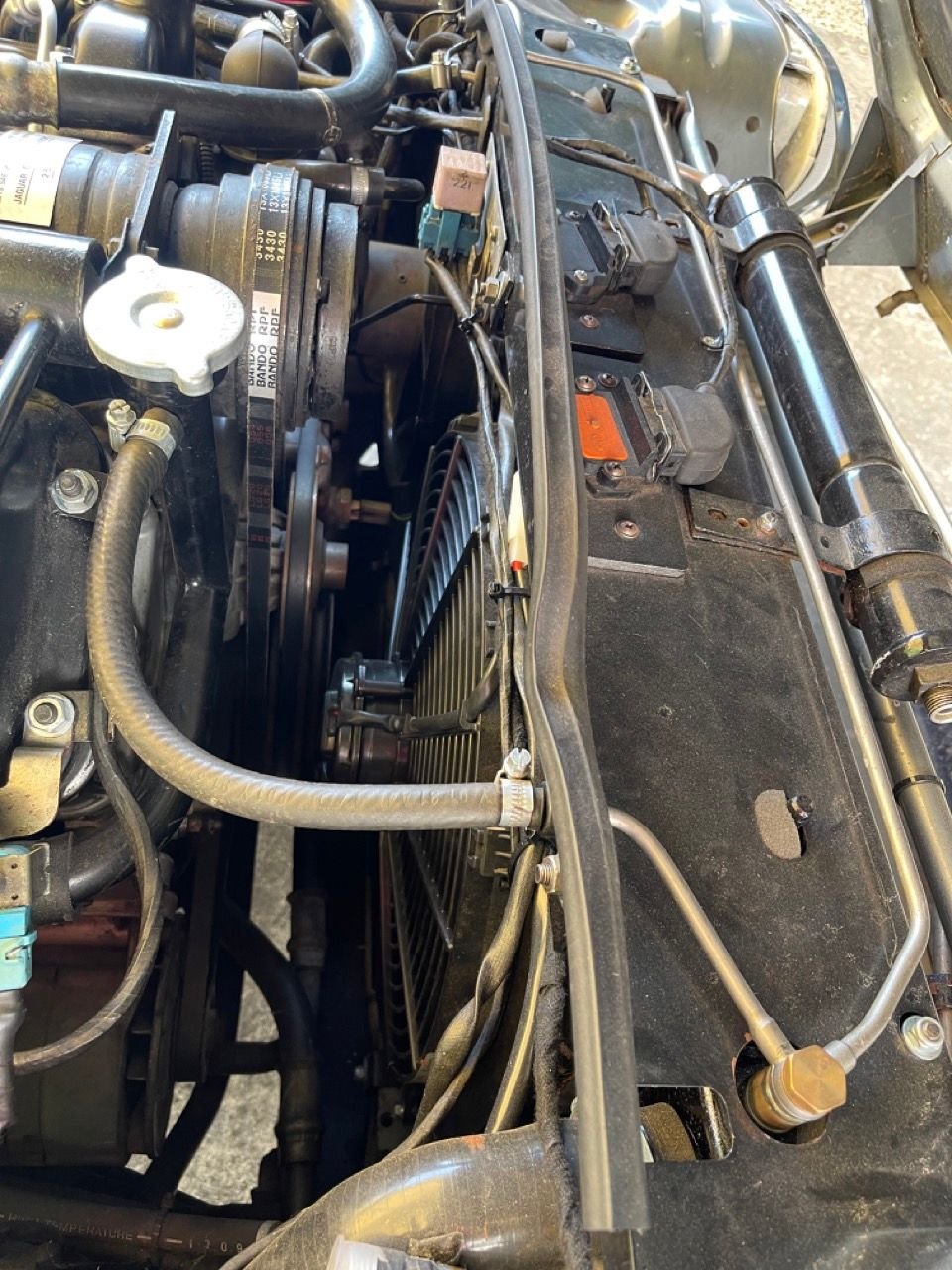

Please see some pics of my coolant hoses

The coolant hoses look to be connected OK.

Good bunch of ticks there.
I would 100% establish yes or no on that baffle.
Remove the bleed bung, use a length of wire etc, and probe down the hole. Memory, hahaha, about 5 - 6 Inches, and you should "feel" that baffle. If its there, GOODO, we will ten assume???? its fitted correctly. Its a simple plate, but who knows. If its not "felt", you know what you need to do.
My thoughts, and that all that it is. You have supposedly had hot running issues for a while, with NO power loss until now, odd for sure.
Being Marelli, maybe?? the sensors have had enough of this extra heat, they only magnets after all, and magnets die with excessive heat.
You would also have the later fuel rail with clip in Injectors and a single FPR arrangement on the snout of the A Side. I know zero of this operation, as it incorporates a Hot Start feature, so hopefully someone with more knowledge slides by soon.

Thank Grant as always, will check the baffle

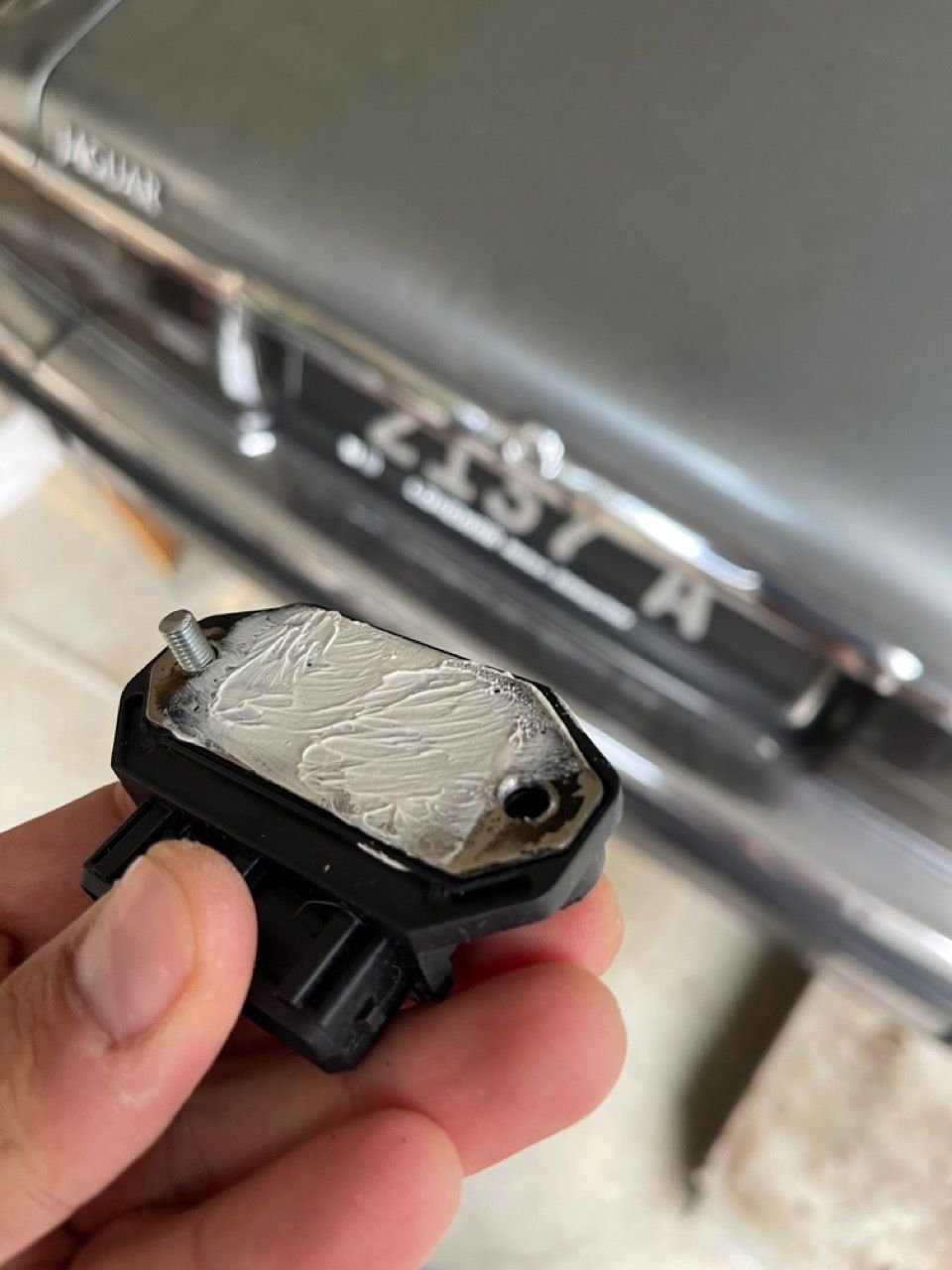

Right, I now know more.
Msybe, and I mean maybe, there are 2 issues, or one creating the other.
The running temp needs to sorted first of all. IF, and I mean IF the engine is constantly running as Hot as you say, the head gaskets will fail, NOT common, but can happen. Worry not for now.
You have Marelli modules on the top radiator panel, and they have that Heat Sink Paste under them to dissipate their own heat, BUT, if your radiator is getting way hotter than normal, they will be getting toasted, and electronics breakdown with heat.
The middle of the V will also be getting hotter than designed, again, IF the engine is running as hot as we assume.
The front crank sensor, smack in the HOT air, not friendly.
Get the cooling sorted, and the rest may???? just fall into place with the reduced heat.

Yeah! you said it right! Marelli module on top radiator plate, with the last work, i removed one of them, as screw hole was broken, i fixed that, and noticed smth white underneath , i couldnt beleive it was thermal paste (i use it only on my computers, not CARs) i thought it some sort of silicon and left it it as it is. Now mb when i removed it and didnt put new paste there, it lost its cooling ability, as it was hard as stone.
i even did a photo to consult here , but forgot
So is it normal thermal paste used for CPUs on the PCs? or i need to get it from auto part stores?
thank you
Also yes, i need to sort out cooling issues first, but here its more difficult, as i have been doing that 9 months without any success
will check that baffle and will write here my thermo gun readings once car is getting hot

Paste is paste, same as our Lucas cars, TV modules, etc etc. Nothing special that I know of.
