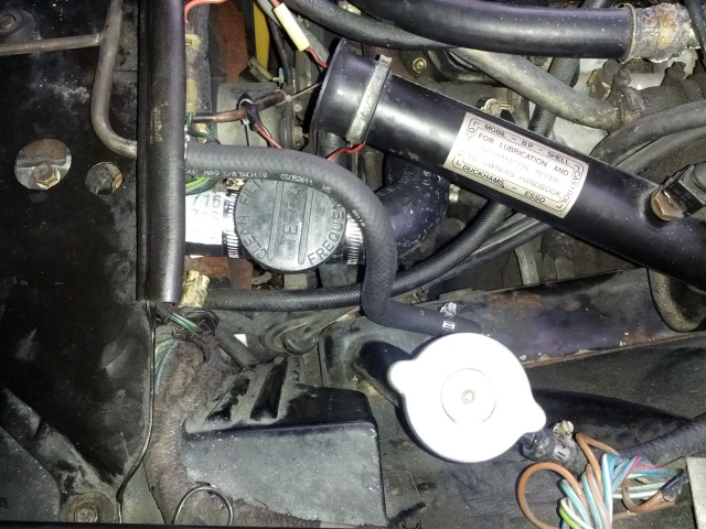

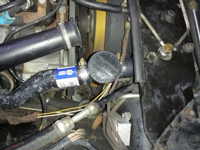

Received the replacement banjo in the mail from FasterJags. I also decided to go ahead and order the Tefba filters. I was skeptical that they are worth the price, but after installing my home brew filters that require draining coolant to service, I do see the value in having filters that you can service quickly without any draining.
Before doing the install, I took advantage of having some coolant out to remove the upper radiator support rail and pry back the radiator. Cleaned out a lot of junk that was wedged between the radiator and the oil cooler, and then installed weather stripping everywhere it seemed appropriate. Hopefully that space will stay clean now, as I would guess about 1/4 the radiator's surface area was blocked.
The FasterJags banjo is actually very similar to the one I had installed on my car. It is longer, which is what I needed due to some of the threads being stripped, but the hole is the same size and position. Perhaps at some point someone installed an aftermarket banjo on my car, or Jaguar switched banjos at some point.
I'm on the fence on the Tefba filters. They come with two different screens, one being finer than the other (installed the fine one). There is tons of surface area, so you'd have to have a really bad system or forget to service them for a very long time to block these things up. Both filters have a spring at the bottom which pushes up a plastic plate the actual filters sit on.
One of the plastic plates had some plastic flashing preventing the filter from sitting down fully. Easily corrected with a razor knife. Both filters are slightly too short, so the plate sticks up into the flow path. There is also a *small* cutout in the plate that allows unfiltered coolant through. Perhaps this is meant as a final relief in case the entire filter gets blocked, but it is such a small area you would be severely overheating. In any case, I put in a 1/8" thick 1 3/4" rubber washers to sit under the lid and push down the filters to remove this channel.
With those two corrections, the Tefbas are very nice. But for the money (about $75 a pop) I think they should be more or less plug and play and not require any fiddling or trips to the hardware store.
Here's photos after my install.

After installing the Tefba filters and refilling the coolant I took a 10 minute drive. Did another coolant air bleed and then serviced the Tefbas. Sure enough work as advertised, no need to drain any coolant. Screens were perfectly clean though... guess my coolant system is pretty clean (my homebrew filters, which were not as fine as the Tefbas, only picked up a few small pebble like objects over the course of a few weeks).
