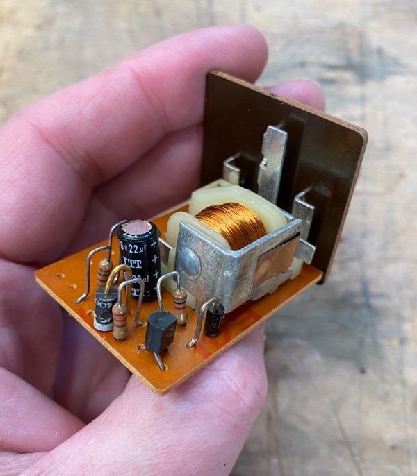

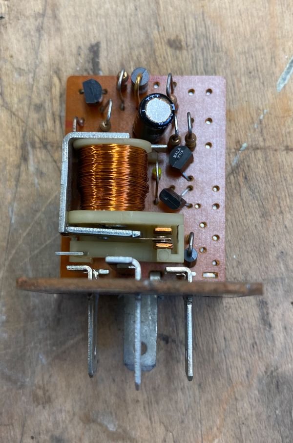

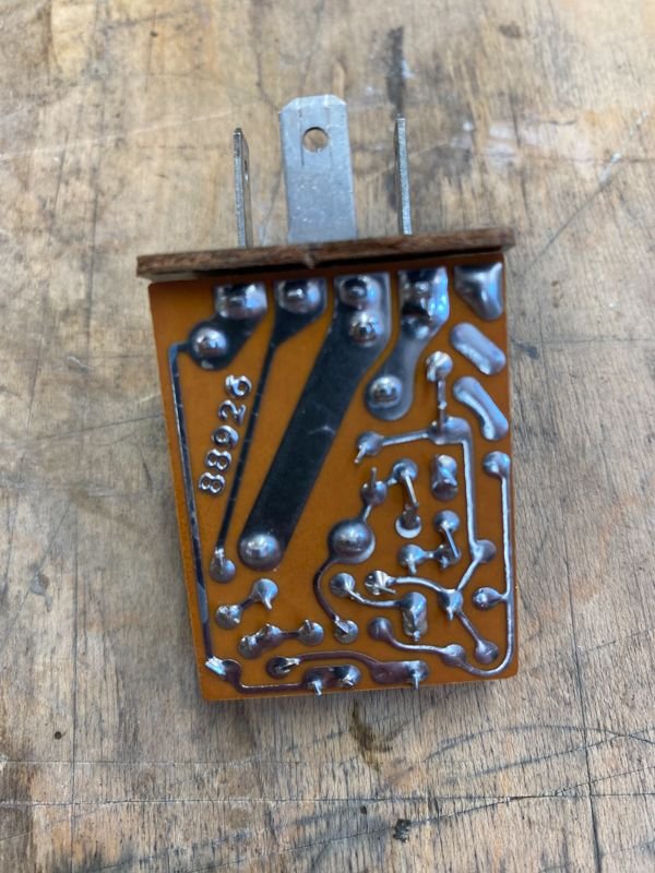

I don't have a diagram, but they are simple enough when you open them up. The usual way they work is a capacitor charges and will hold the contacts open as the capacitor discharges. The size of the capacitor determines how long the contacts can stay open, so you can change the delay time by changing the capacitor.
The original is a 16V 22uF capacitor, I don't know if it's a linear relationship, so maybe a 47uF would give a bit more than 20 seconds of delay? I don't know.
