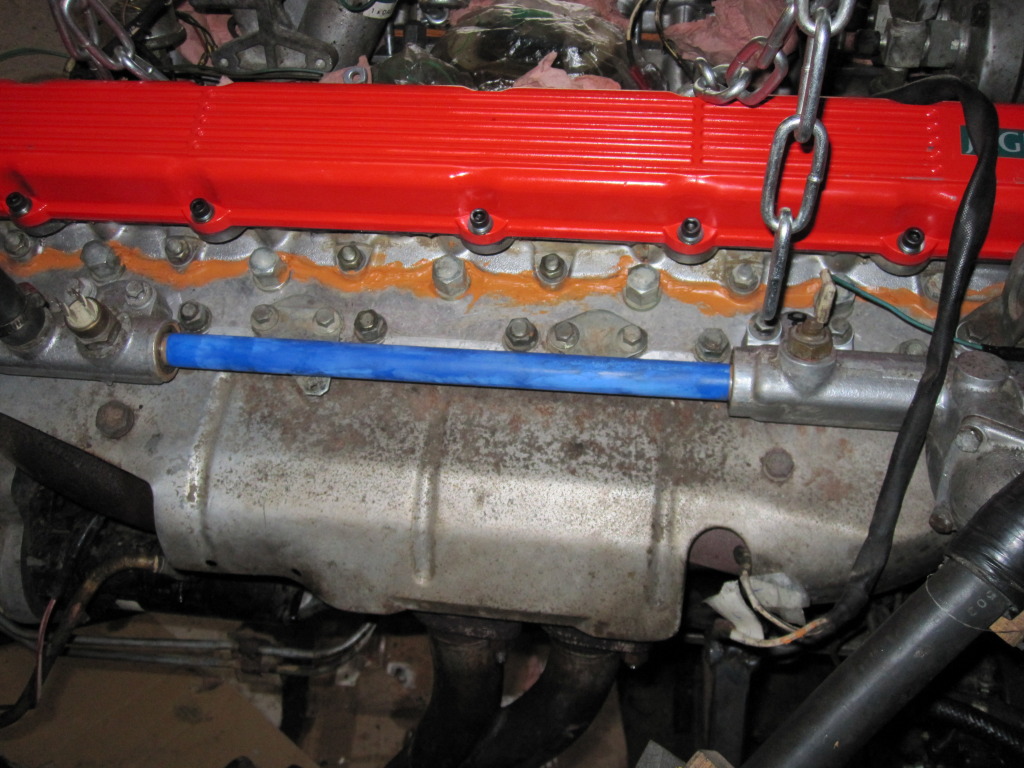

are these the wires in the yellow circle you are talking about? Just remove these?

Not those ones, no. I am not sure what they are as I do not remember having them on mine before I removed all the many vac tubes and replaced them by a single manifold to vac capsule.
I assumed you have Lucas ignition. If you have Marelli, forget about the two wires on the water manifold. If you do have Lucas, here is a photo. See the two spade terminals on the LHS of the photo, sticking up out of the rear water manifold? Remove these and tape them off. What this temp switch does is enrich the mixture for 15 minutes if the water temp is below 45° or so. Removing the wires inhibits the system. They are easily accessible with the air filter cover removed (and a cold engine!).

Mine must have been one of the first marelli cars in 89, has two orange coils up front named Marelli.
I notice some orange sealing underneath your valve cover... Mine is also losing a lot of oil there... I will have to take care of that too...

The sealing is special high temp silicone and it seals the tappet block to head join, which was a metal to metal join OEM. Idea given to me by a friend who runs a Jaguar garage. Works really well, as this oil is not under pressure. As long as you do not mind the look of it, which I do not!
The valve cover to tappet block seal I redid with a new gortex gasket and longer bolts as recommended by the Great Palm.
