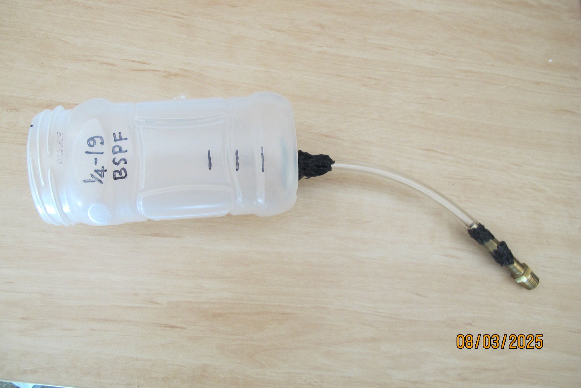

I made this to pre oil my 5.3L.
Thread is written on the plastic can, fits on the oil sender position.
It is gravity feed and will oil all the passages on the outlet side of the filter.
It might fill the filter if the non return valve is on the inlet side of the filter.
I know if you top up that can the engine takes a lot of oil.

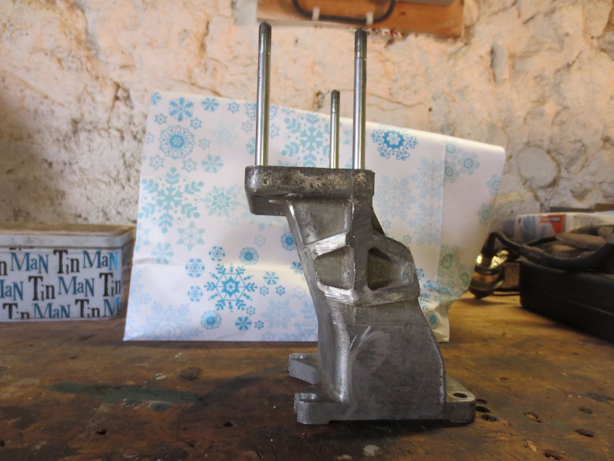

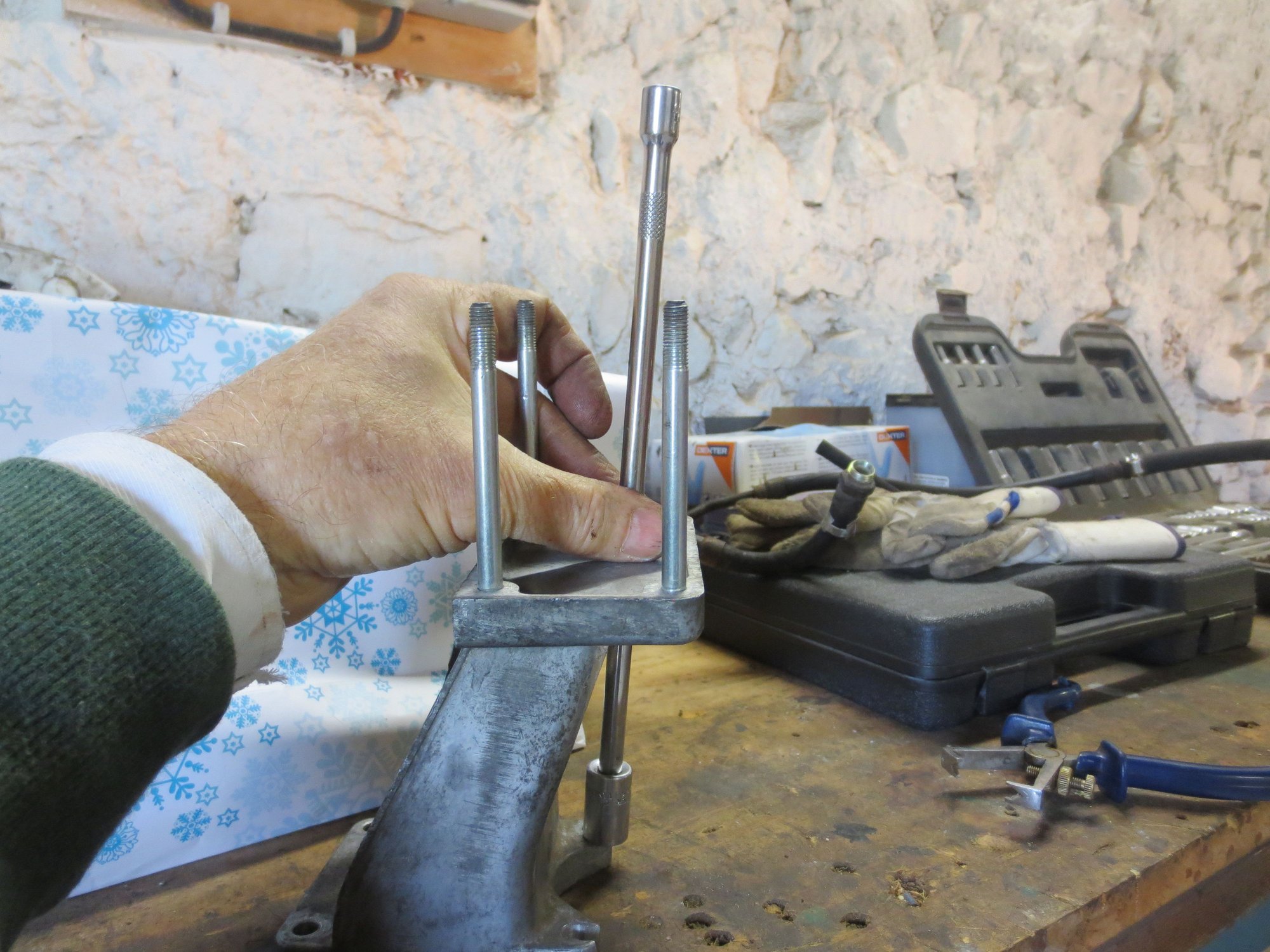

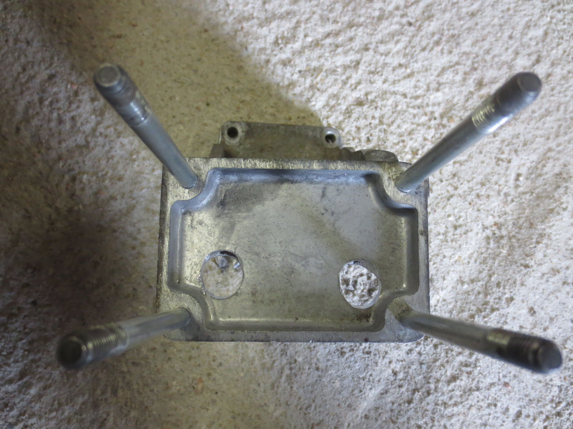

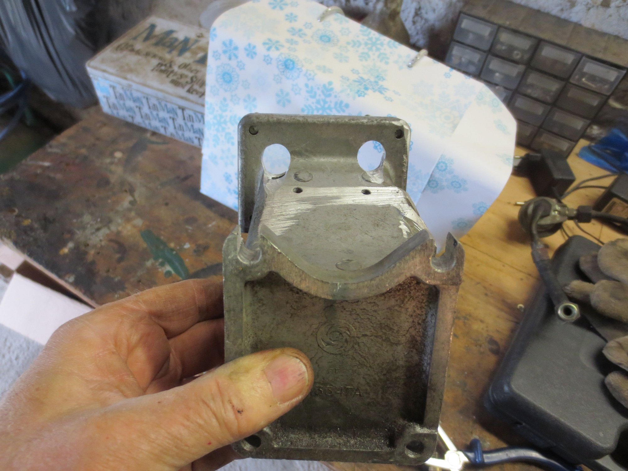

I am a big fan of slotting the two rearmost holes on the throttle capstan pedestal. Then drilling two access holes in the pedestal, big enough for a 1/4 inch drive 7/16ths socket and long extension, to allow access to the rearmost two fixing bolts.
The front two can be easily got at. This makes changing the plugs far easier: dizzy cap off, capstan off, disconnect coil leads, coil lifts off, pedestal off. Replacing does not need throttle rod readjustment.
This is a Grant Francis idea and a damn good one!
Silly wings left over from the E type application cut off.
Access holes for rearmost slotted bolt holes
Slots from below
Slots from below
A cinch to undo!
A cinch to undo!

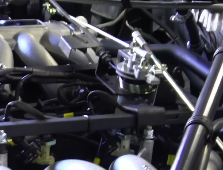

I remember that battle - what a pig of a location - glad you posted those or I'd have probably got the wrong holes - I was thinking of the oil sender pedestal ....
Looking at some footage I have I was considering the replacement of that pedestal - look at this and tell me if this is a bespoke or whether it is off the 6.0 - the rails in this image are I believe -
Old Jul 14, 2025 | 05:32 AM
Greg in France's Avatar
Posts: 14,568
Likes: 10,761
From: France
I think, repeat think, that is bespoke. The 6 litre capstan is different from the 5.3, but from memory it is not like that, so I also think the capstan in the photo is bespoke.
