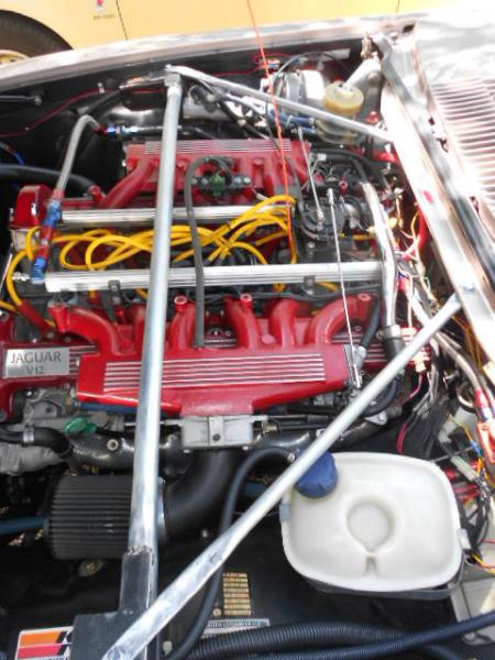

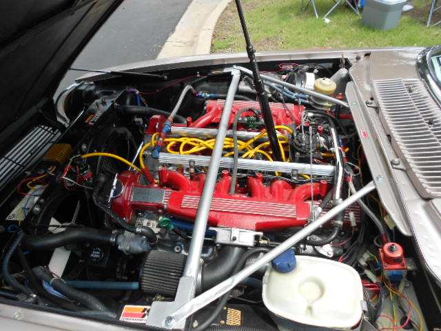

pic enclosed!!
it only connects the tops of the shocks where they meet the body sheet metal braces, which are seam welded to body, it did help some, with flex in the front section, and braces into the firewall.
it does not connect the springs towers! that are part of the subframe.
i'm thinking its better than nothing at all,its light weight tubing, 1 1/8".
did it a short while back, but been thinking about it for 10yrs,(i dont like to rush things),, hehe.

i like it. form = function in this case. i think it looks great and it looks pretty simple to fab up.
