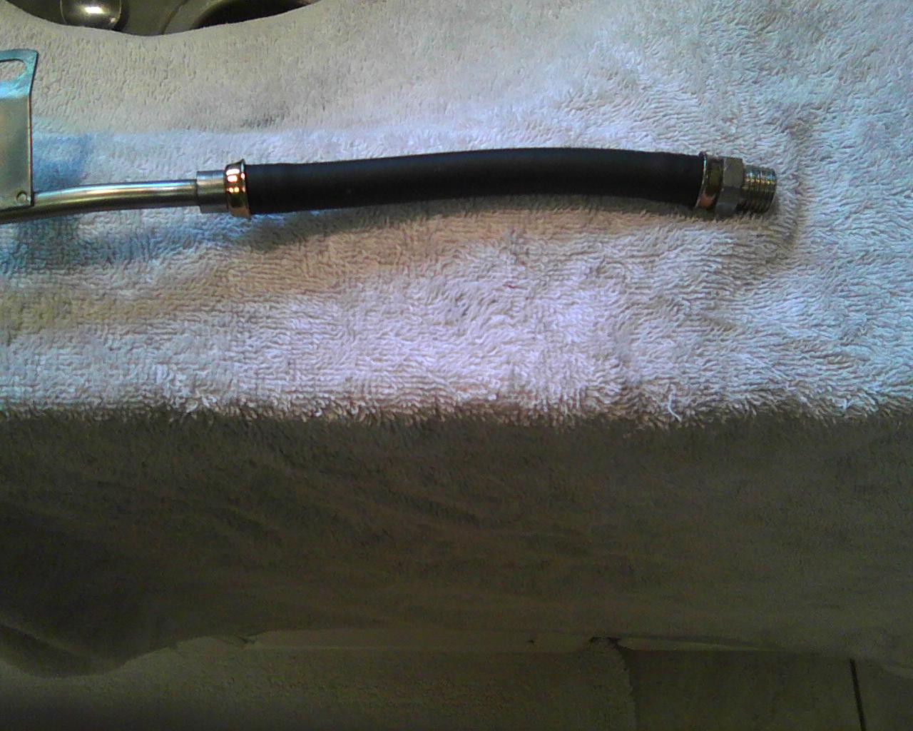

I treat the supply and return pipe/hose assemblies just as I do the injectors--- cut off the old, install the new. I use the same ferrules on all. Just got done doing a set for my own car, in fact.
DD
Attached Thumbnails Did I just screw myself? Fuel Return Hose-return-pipe.jpg
